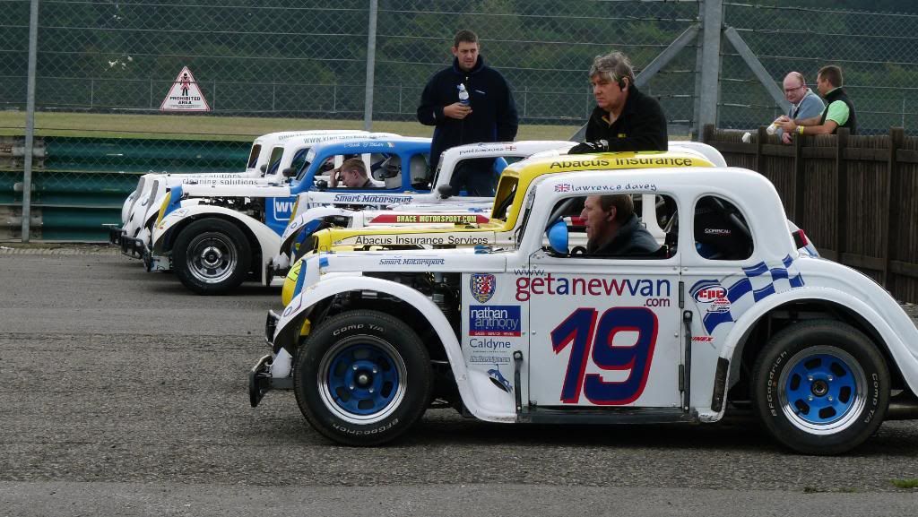

 Ok so you obviously are a clever man (presumably) how about this one, when I used to run a car in the Legends championship one dark-art I could never really get my tiny brain around was this business of altering the nose angle of the diff to alter the bite of the rear wheels.
One of my mechanics was ex-stock car racing and he seemed to understand what it meant but im still clue-less as to how it works, what does your considerable shelf-ful of text books say about that particular aspect of dynamic chassis set-up?

checks shelf< nope, nothing on chassis set up, and I’ve no idea what the back axle of a Legends race car looks like. But if it’s a live axle, and depending on the suspension linkages used, you could change the squat charateristics of the rear suspension by adjusting the nose angle of the diff. More squat gives you more traction. I’ve seen adjustments for squat on rear subframes of cars with IRS multi-link rear ends where they rotate the entire subframe - something similar could be applied to MX5s.

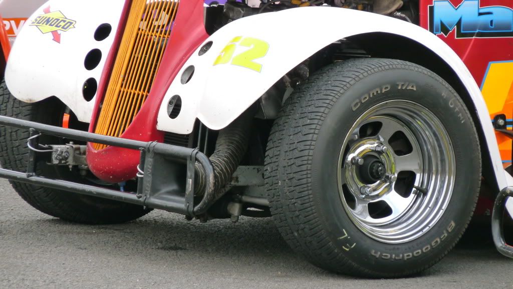

 Legends are short squat cars with lots of camber
Over all length must make them a little unstable and the camber angles ar likely to help with this.
and thats what shifting the nose angle must do help grip in a short car.

I did some checking and adjusting diff nose angle to adjust camber isn’t that effective.
On a car with a live axle and 5 degrees of camber, rotating the nose of the diff by:<o:p></o:p>
5 degrees will reduce the camber by 0.019 degrees,<o:p></o:p>
10 degrees will reduce the camber by 0.076 degrees,<o:p></o:p>
15 degrees will reduce the camber by 0.17 degrees,<o:p></o:p>
20 degrees will reduce the camber by 0.3 degrees,<o:p></o:p>
25 degrees will reduce the camber by 0.466 degrees,<o:p></o:p>
Which is a much smaller effect than I thought you’d get, even at silly angles.
