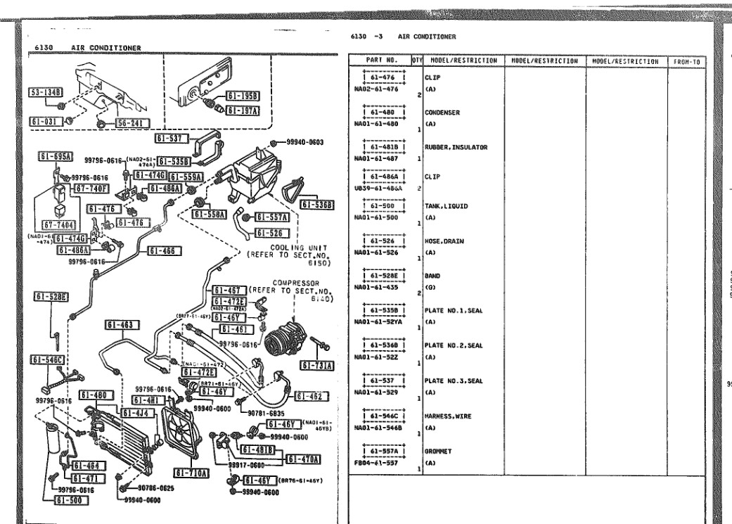

Japanese part no. for the condenser is N001-61-480, I can’t seem to find the AC system in the US manual to see if they match.
On Rock-Auto, some of the part numbers end in ‘61480’, but the start of the codes doesn’t match. Does that mean it’s the same part, but for a different market? Or are they completely different parts.
I tried my local Mazda dealer, they told me neither the condenser or dryer could be sourced anymore from Mazda. Only new supplier I’ve seen is asking for £600 + VAT + shipping from Japan, which is a bit steep. So if one of the US parts would fit I’d much rather order them from Rock Auto.
Same part number on the US microfiche
