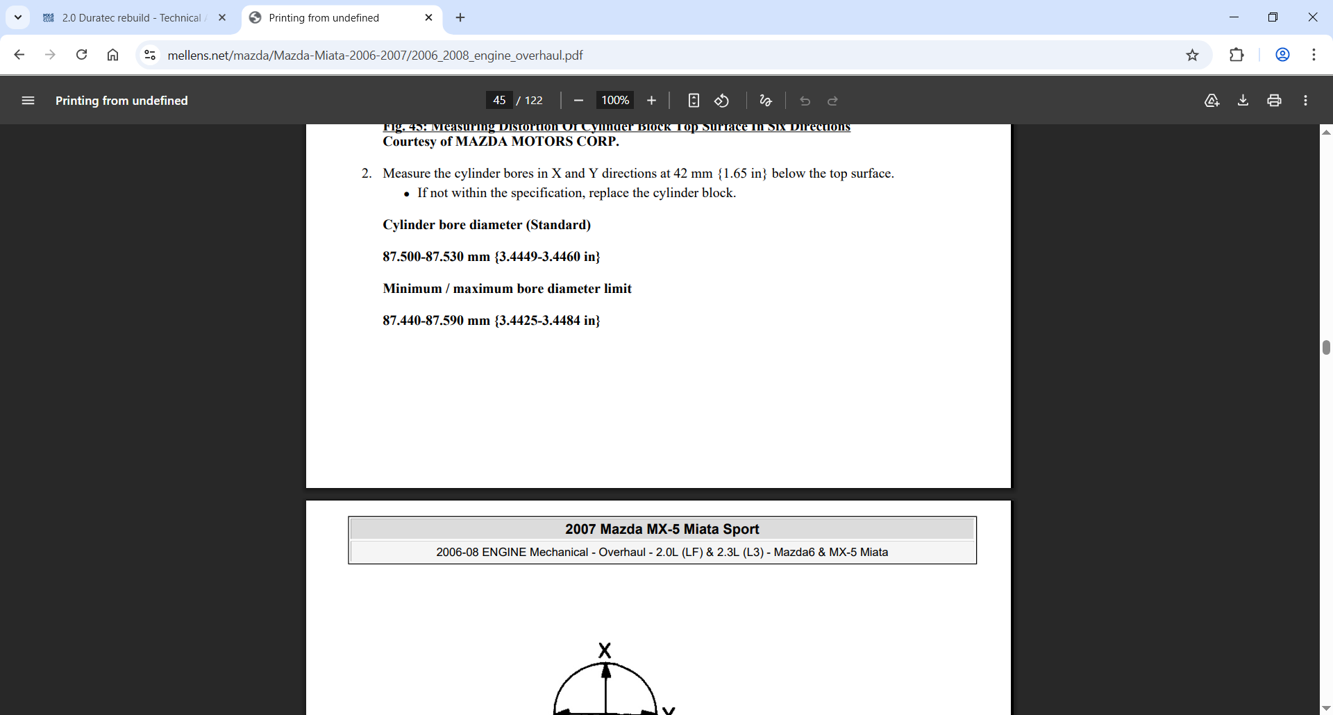

Hey I’m hoping someone could help with some measurements. I can’t find the tolerances specs on how oval the bores can be? I’m getting anywhere between 0.015 to 0.030mm differences from the X and Y axis. I found somewhere online that i shouldn’t be more than 0.010mm difference. Is this block gone?
As long as both directions are within the sizes given you should be good.
