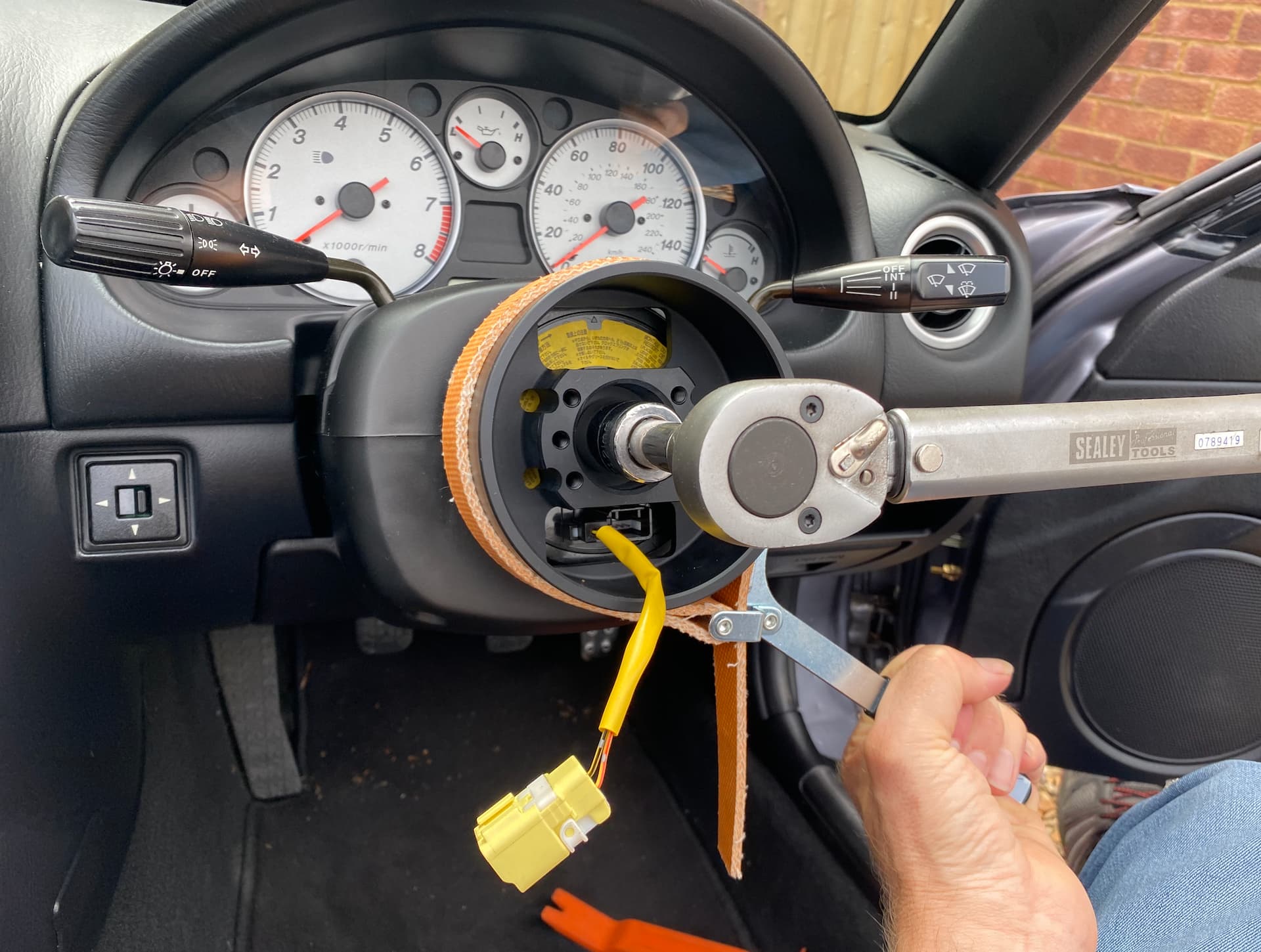

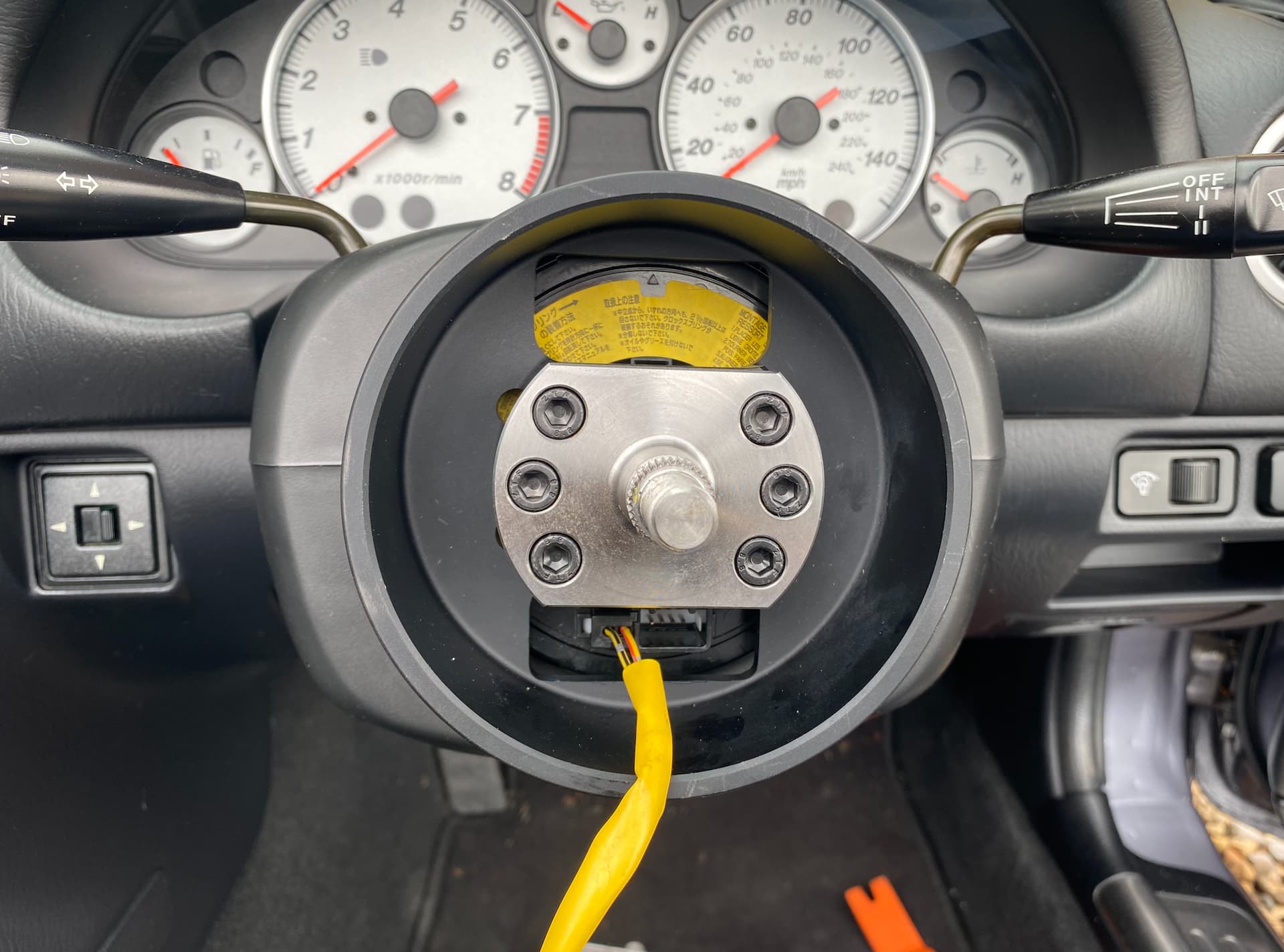

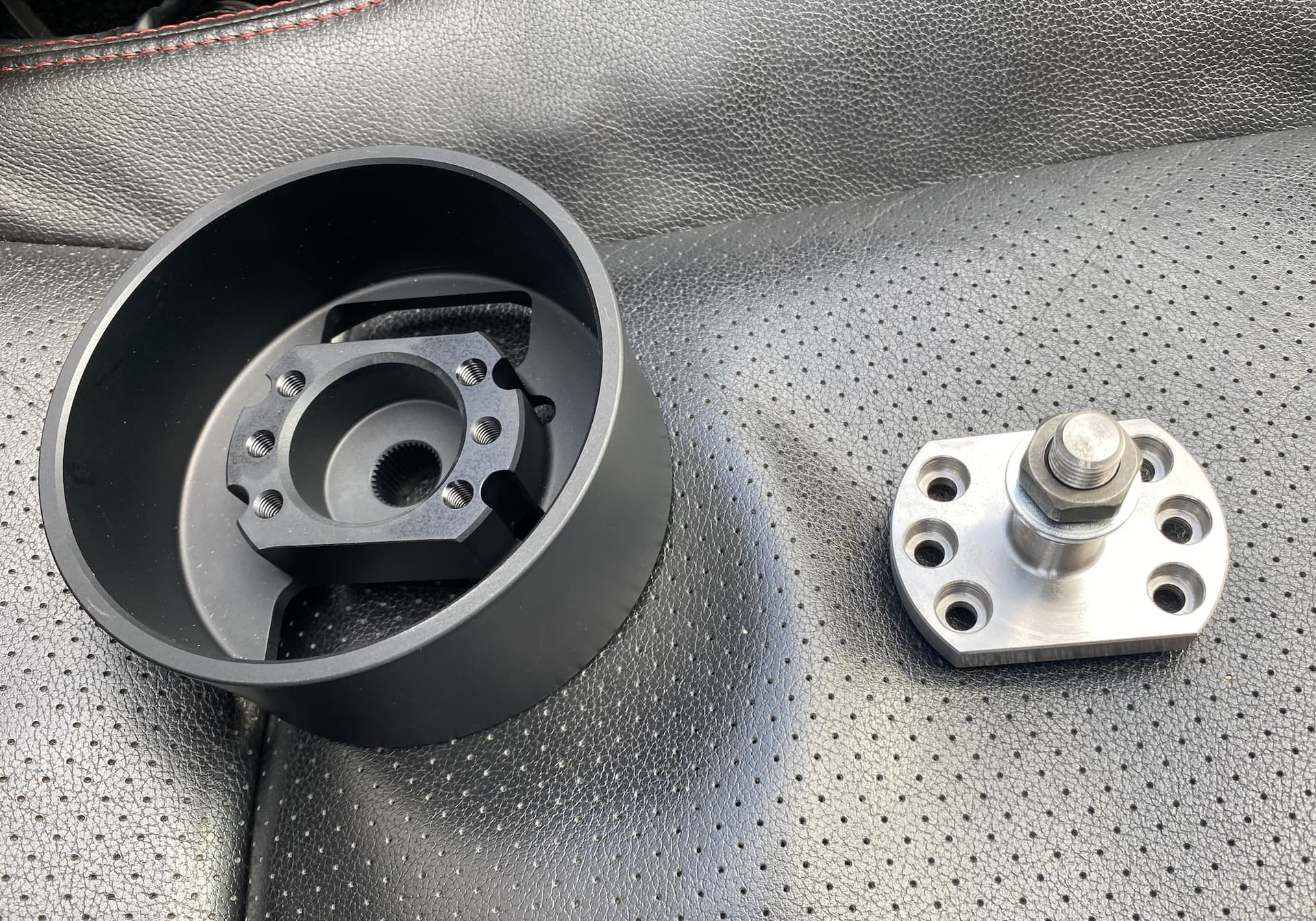

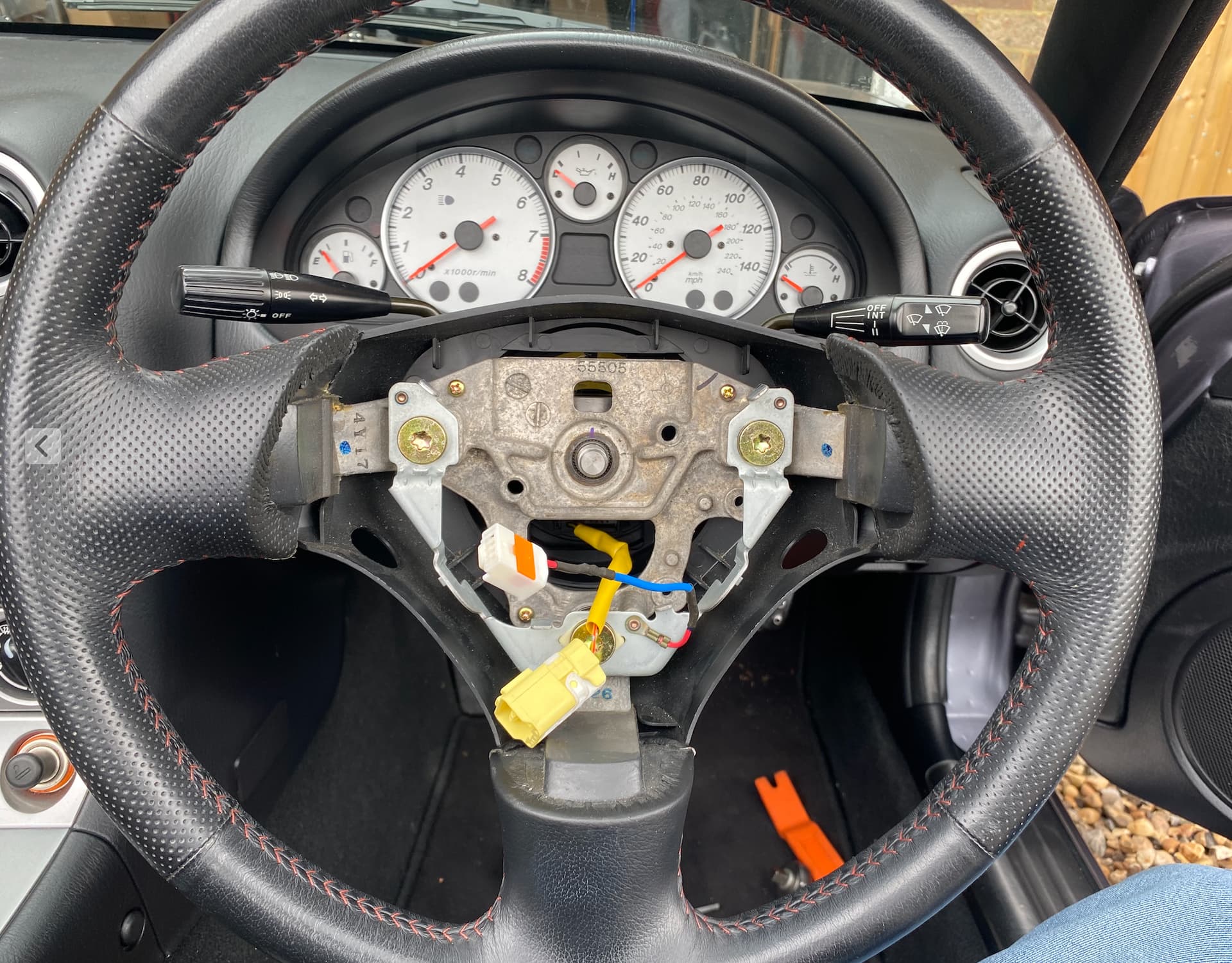

So am I ! the spacer is fitted by removing the airbag, this is well documented but is essentially disconnect battery, wait a while, push brake lights to make sure any capacitive charge in the system is gone, then just two bolts, and pull airbag out disconnect yellow airbag connector (google this as it’s a very specific connector but easy when you know how) Then disconnect horn wire from clock spring.
Next is to remove steering wheel (again google it’s pretty straight forward) Then fit the black spacer part onto the steering column:
tighten (I used a leather oil filter wrench to hold in place so it didn’t scratch the paint)
Then you bolt the sliver extender bit to the spacer which in effect extends the steering column by 50mm or so, and you then fit your steering wheel as normal
The only modification I had to do on my car because it’s a late mk2 is extend the horn wire by about 6cm (the blue section in the middle of the red wire) The airbag wiring remains untouched

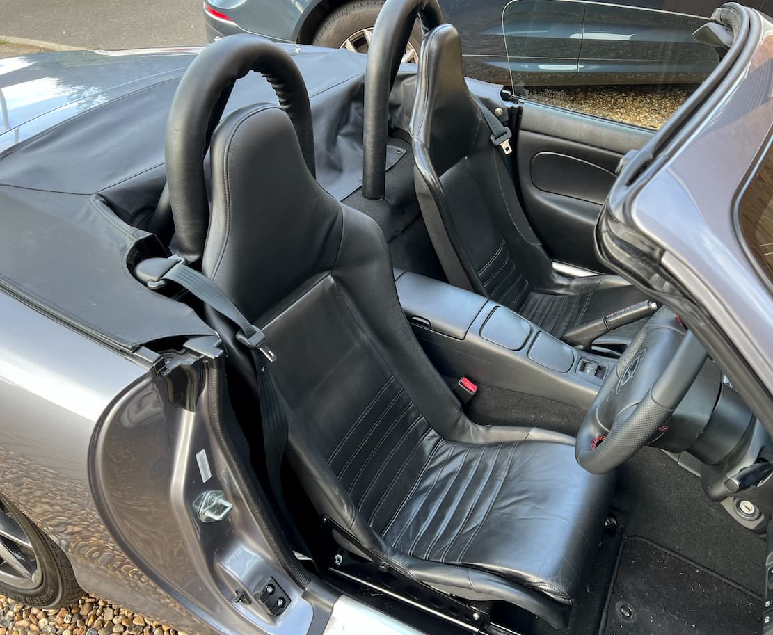

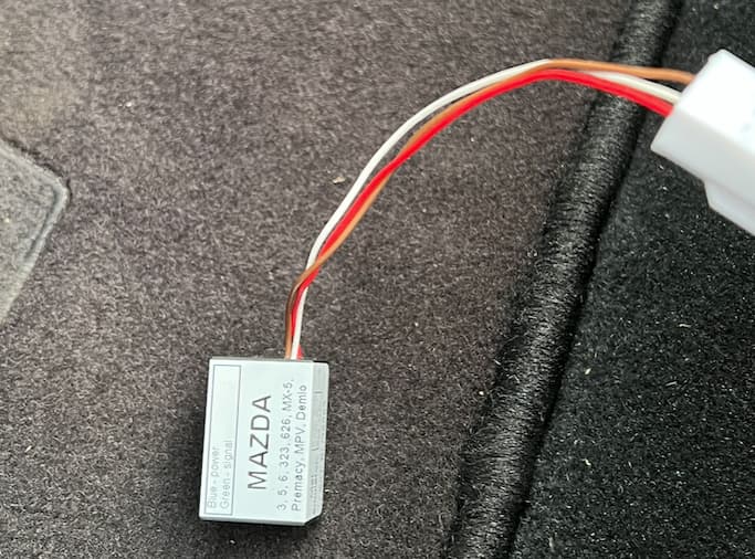

Got round to fitting the second Elise seat which gives a noticeable amount more room for passengers. Also transferred over the relevant wiring looms for each seat to satisfy the electronic sensors. On the driver’s side I re-fitted the original seatbelt stalk and patched it back into the loom so the belt warning system should work again. On the passenger side I fitted a seat occupancy sensor device so that the system thinks there’s always someone sitting in the passenger seat and will always activate the passenger airbag if the worst happens.

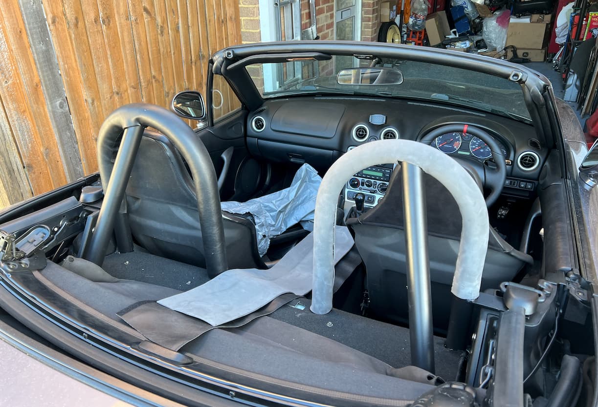

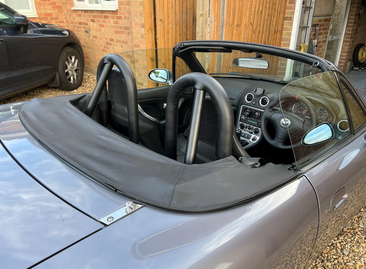

I’ve been gradually persuading some SafetyDevices roll bar padding to shape itself to the roll bar curves hence all the temporary zip ties! Once that stays in place on it’s own I plan to sew together a vinyl cover to hide it.

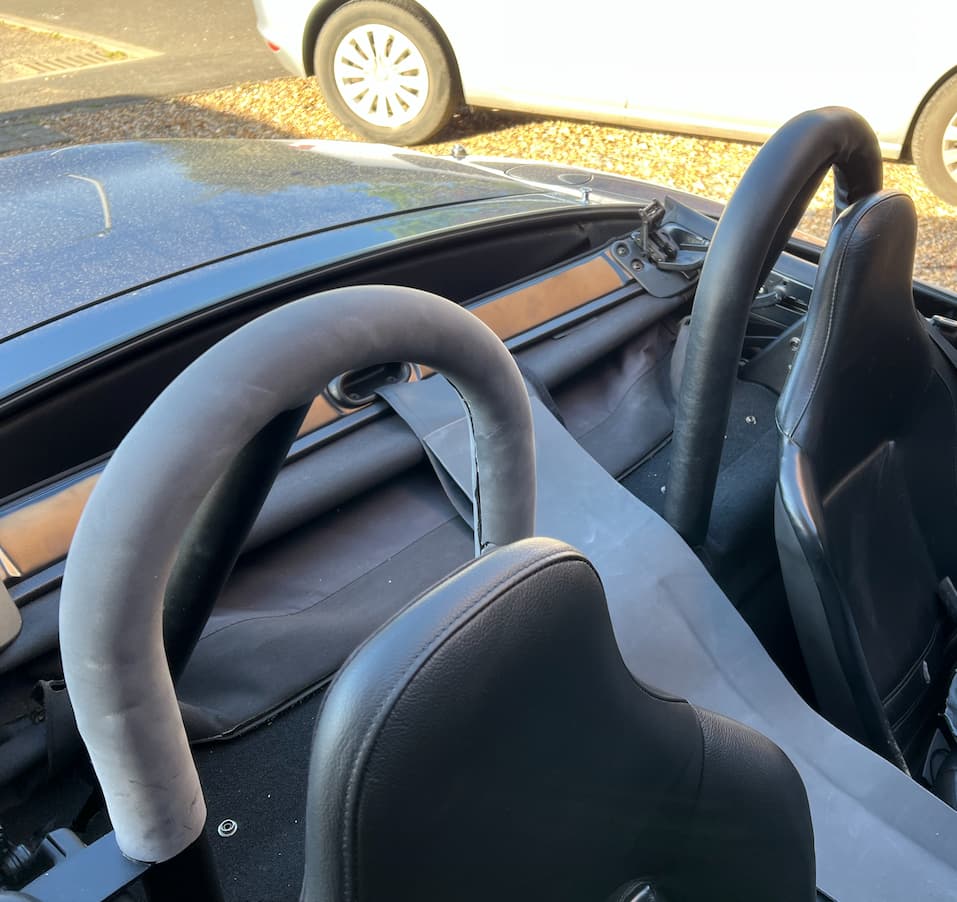

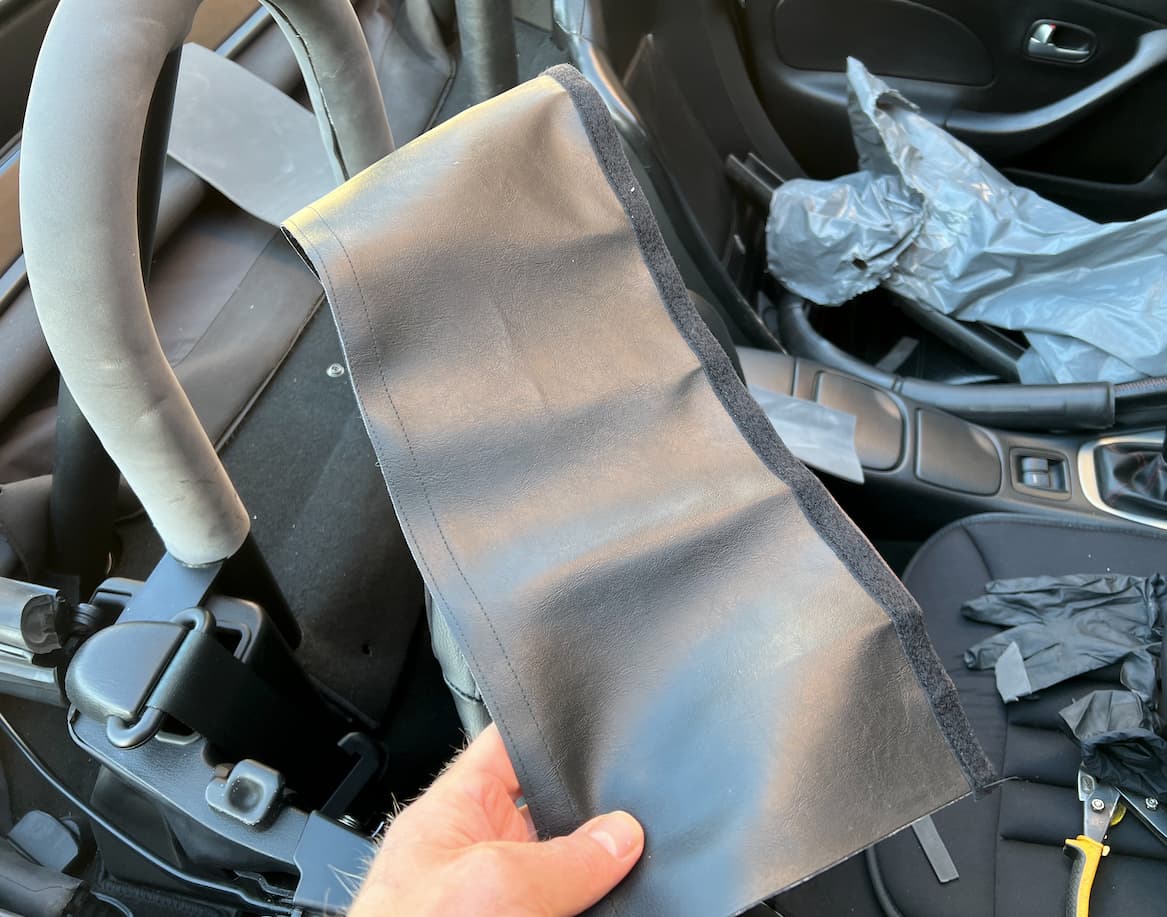

This evening we did some more work on the roll bar padding, The Safety Devices stuff turned out to be comically large and unforgiving when padded with scrim foam & vinyl so I tried a different approach. Two layers of 2.5mm high density closed cell foam glued separately so they followed the contours of the roll bar, then I sewed a vinyl cover with male velcro on one side & female on the other.
Grey bar on the right has one layer of foam, left is completed with x2 layers + vinyl cover.

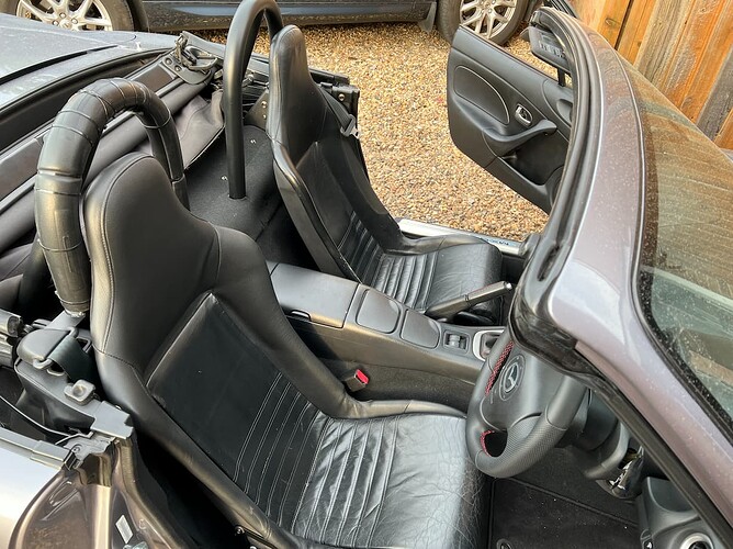

Roll bar padding finished, tonneau cover trimmed to fit, seats re-coloured in black to refresh them and get rid of some scuffs on the passenger side.
Looking good Carl, saw you at the spring meeting,just as you were leaving unfortunately!!
Steve
Sorry, yes I needed to get back as I was double booked that day! it’s always hard to find people at these events isn’t it? I can find a car easy enough but in a crowd people are a lot harder!

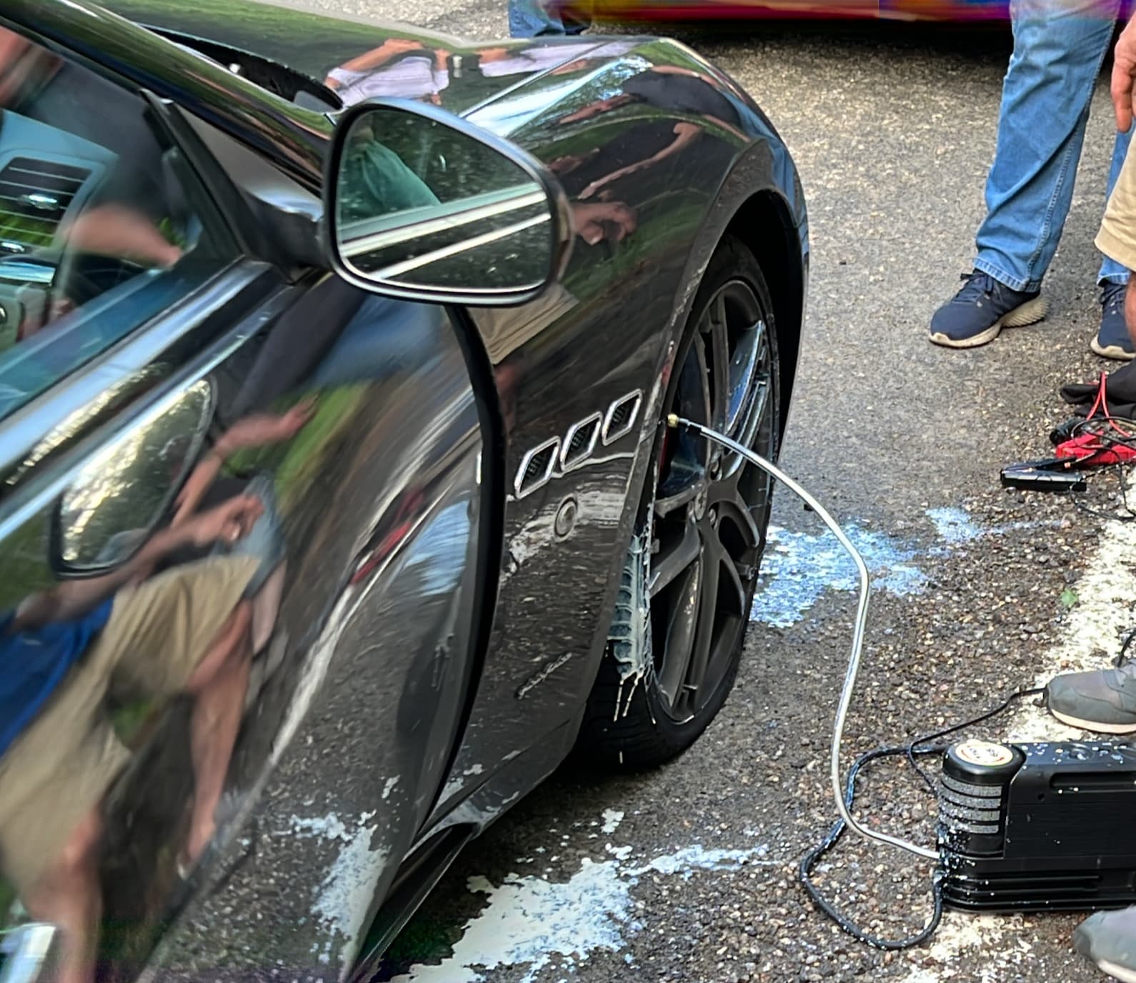

Of course one of the cars had to break down, A Maserati gets a flat tyre on some dodgy mountain roads, too big a split to be fixed by the squirty can :frowning:
