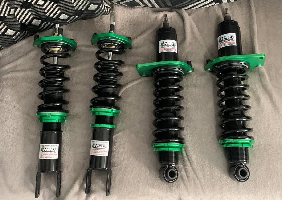

HSD monopro, 16 way adjustable.
Great quality and finish.
£1000 approx.
