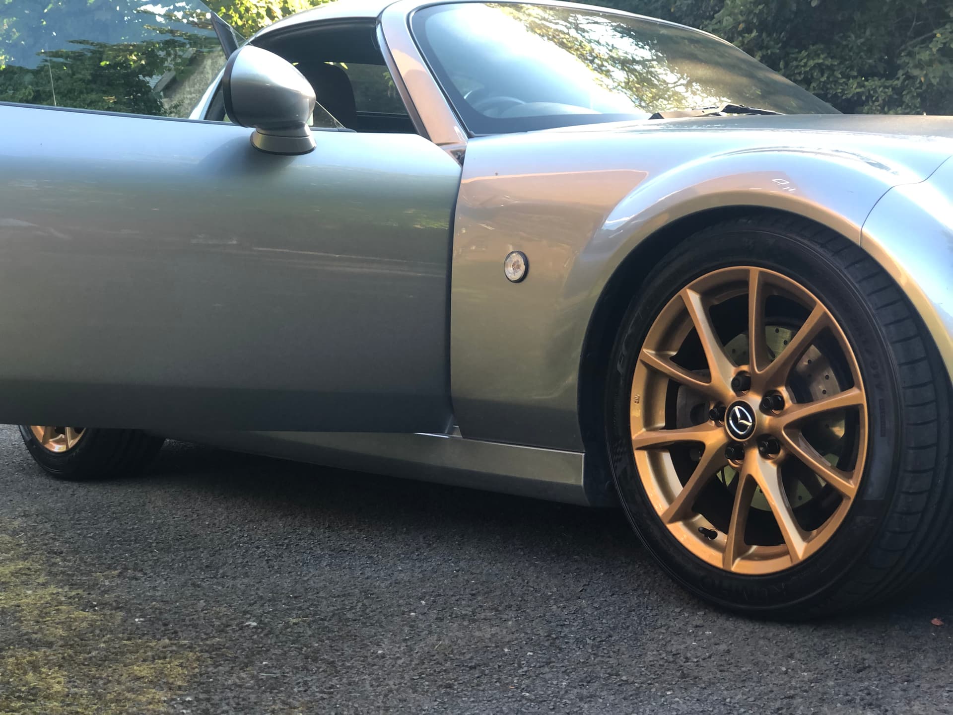

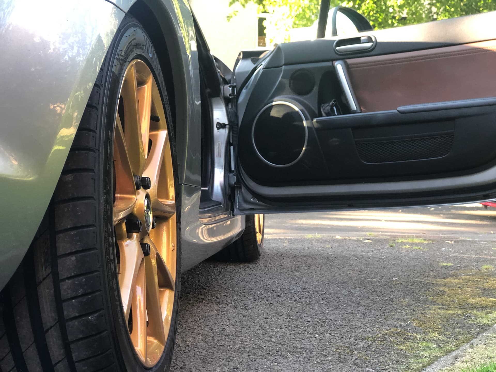

Eventually got round to fitting a full set of 215 PS71s
Haven’t driven far but will report in when I get a good impression compared to the same tyre but in the standard 205 size

Yep - they look great.
Don’t forget to inform your insurance company though - they will probably view it as a modification. They shouldn’t increase your premium, but simply informing them could save a whole lot of pain should you be involved in an incident.
Do please keep us posted. I am planning to do exactly the same in a month or two.
I may well go for the Kumhos, but I am also looking at the Goodyear F1 Assym 6.
Loving your wheel colour

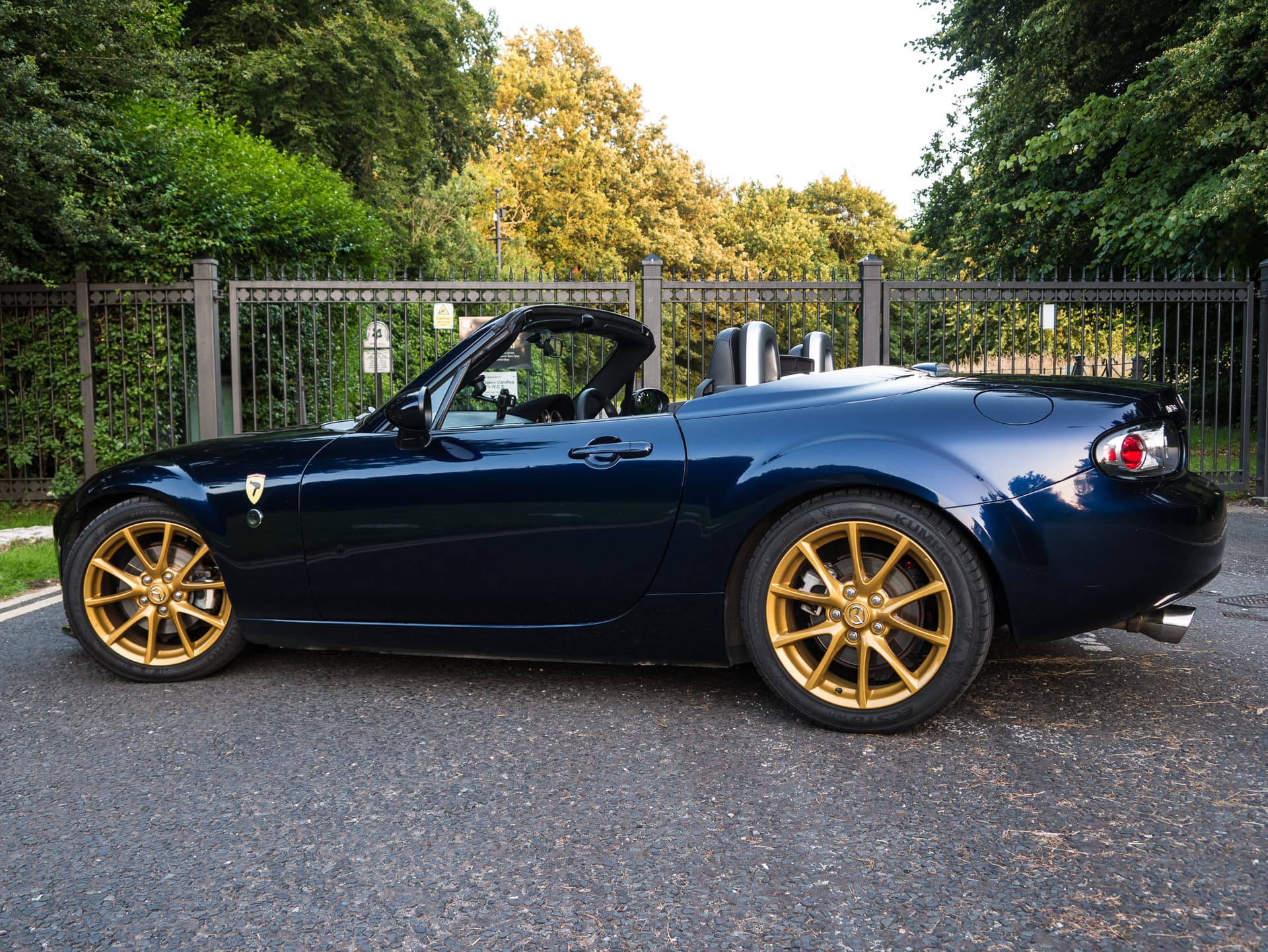

Mine is also shod with 215 Kumho PS71’s and they’re a pretty good tyre.
Enjoy…

Well my first proper drive and I really thought I`d made a terrible mistake. The car felt really nervous and twitchy in a straight line and my usual roundabouts and twisty bits were a mess.
Just before heading off on a trip up into Northumberland I did my usual checks (also an oil service and fresh air filter etc) and found the tyres were at 40PSI !!!
Now they are at 29PSI all round it`s back to feeling right!
So good result.
A classic case of over inflated with new tyres, it happens often.

On a trip into Northumberland this week and now I’m at the correct tyre pressure I’m happy with the slight increase in size. Certainly can’t feel any degradation in ride or handling.
So in summary 215 45 17s work well.
