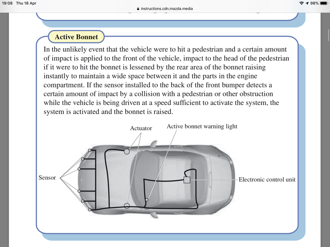

A suggestion of several sensors:
It’s the ‘at a speed sufficient to activate the system’ that’s the puzzling bit. As they mention that speed is a factor the system will presumably be  programmed to only operate above that speed.

Mazda dealership investigated my car and says the Active Bonnet activated accordingly. I replied saying that’s ridiculous, minding the fact that the car was being parked at a low speed hitting the curb. They haven’t replied at my question at what speed the Active Bonnet shouldn’t be activated. They said it’s activated, and I quote, “probably” because my MX-5 ND is lowered (MX-5 ND option!) and so it will hit curbs faster. And referring to their manual, hitting anything with the front can activate the Active Bonnet…

The system is called “Deployable Hood System” (DHS) and there’s a good write up about it here: http://www.roadster.blog/2015/07/mx-5-roadster-nd-safety-features.html. The article claims it’s at speeds above 20Km/h (but I’m not sure what the source of the information is - I haven’t seen that claim from Mazda).
