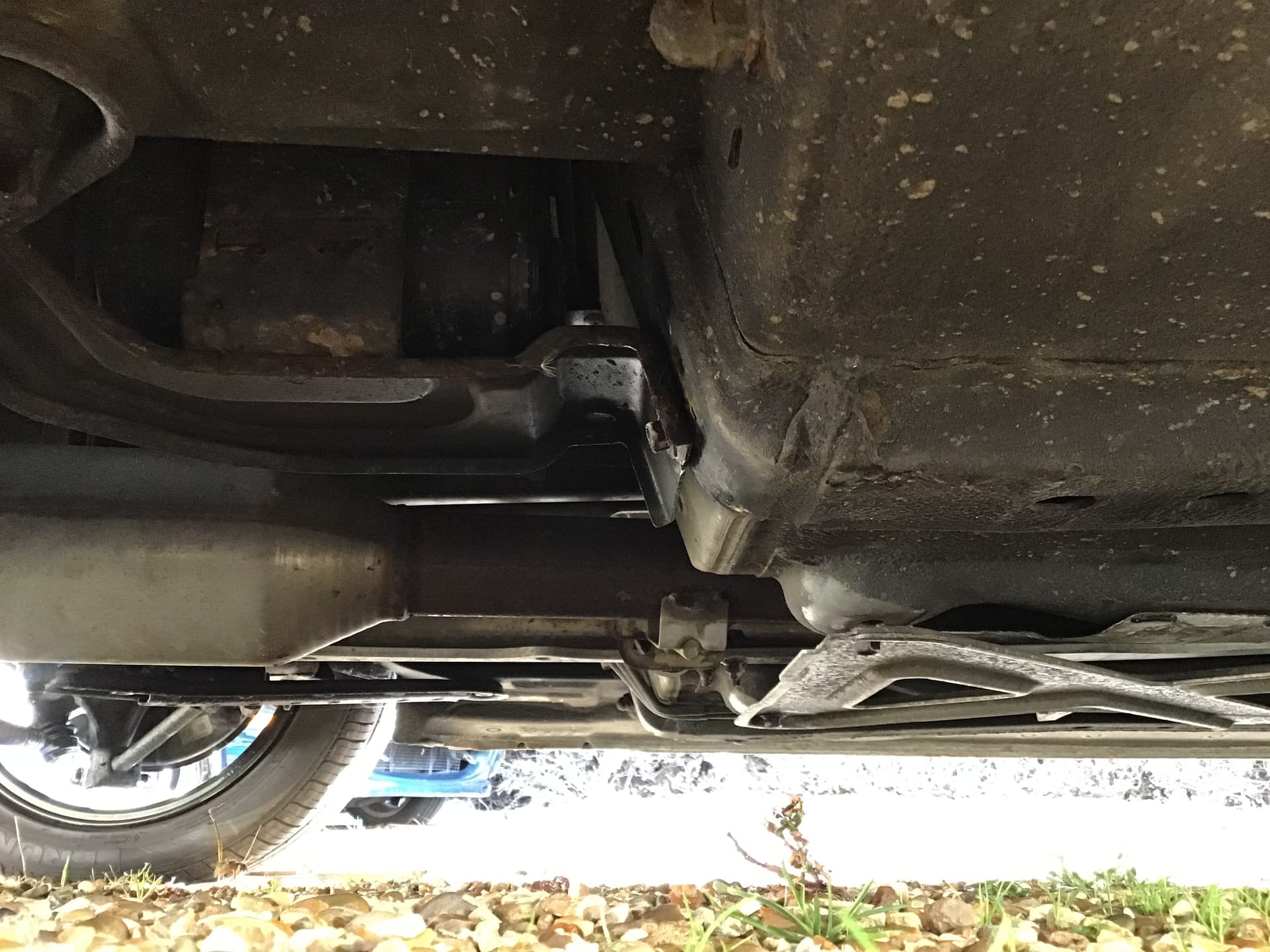

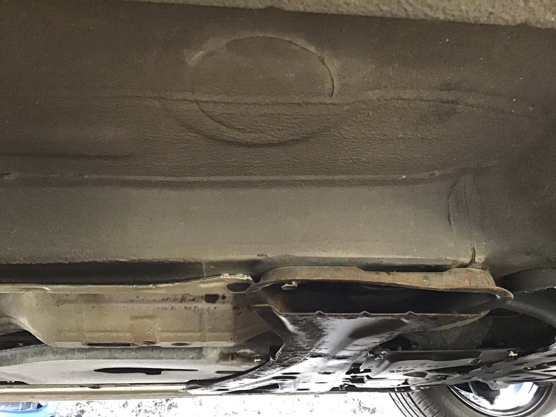

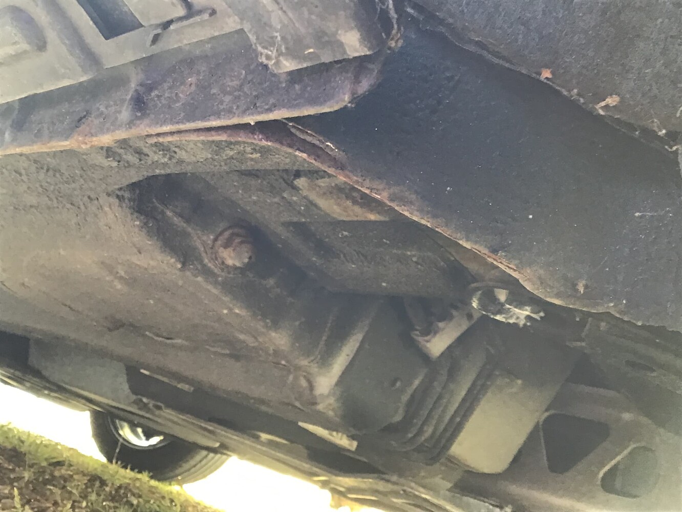

So, I’m guessing it has been undersealed (see pics above). If anyone spots anything that doesn’t look right, just let me know.
Having owned a NB for 6 years where rust started to creep in on one rear wheel arch, I really want to keep it out of this NC for as long as possible.
I see rust on the curved section in this picture. It carries on along the bottom of that section. This is a typical area prone to eventually rot. Check both sides in that area.:+1:
Great, will do. What would you suggest putting on it? Waxoyl or something else?
I ground away most of the rust and applied Bilt Hamber hydrate 80. Then you can apply your underseal. I used Built Hamber epoxy mastic (black).

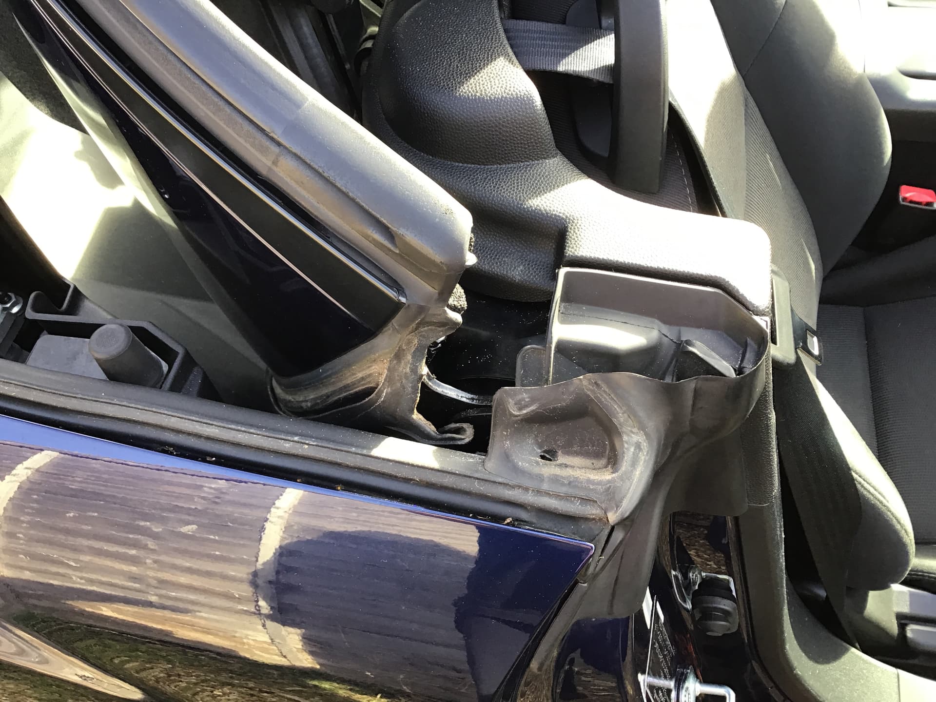

Are these the hood drains on my PRHT? If so, how best to clean?
Those aren’t the famous hood drains that a trombone cleaner comes in handy for, but they are indead drains (rubbers from the roof run to them).
I’ve just gone around all of the rubbers and cleaned them with Autoglym | Vinyl & Rubber Care about a tenner from autogylm or halfords.
The hood drains can be seen slightly further back under the deck when partially lifted (easiest from standing by the rear wheel). On NC’s they’re covered by a plastic grate. A quick search should bring up more detailed threads/pictures of them.
