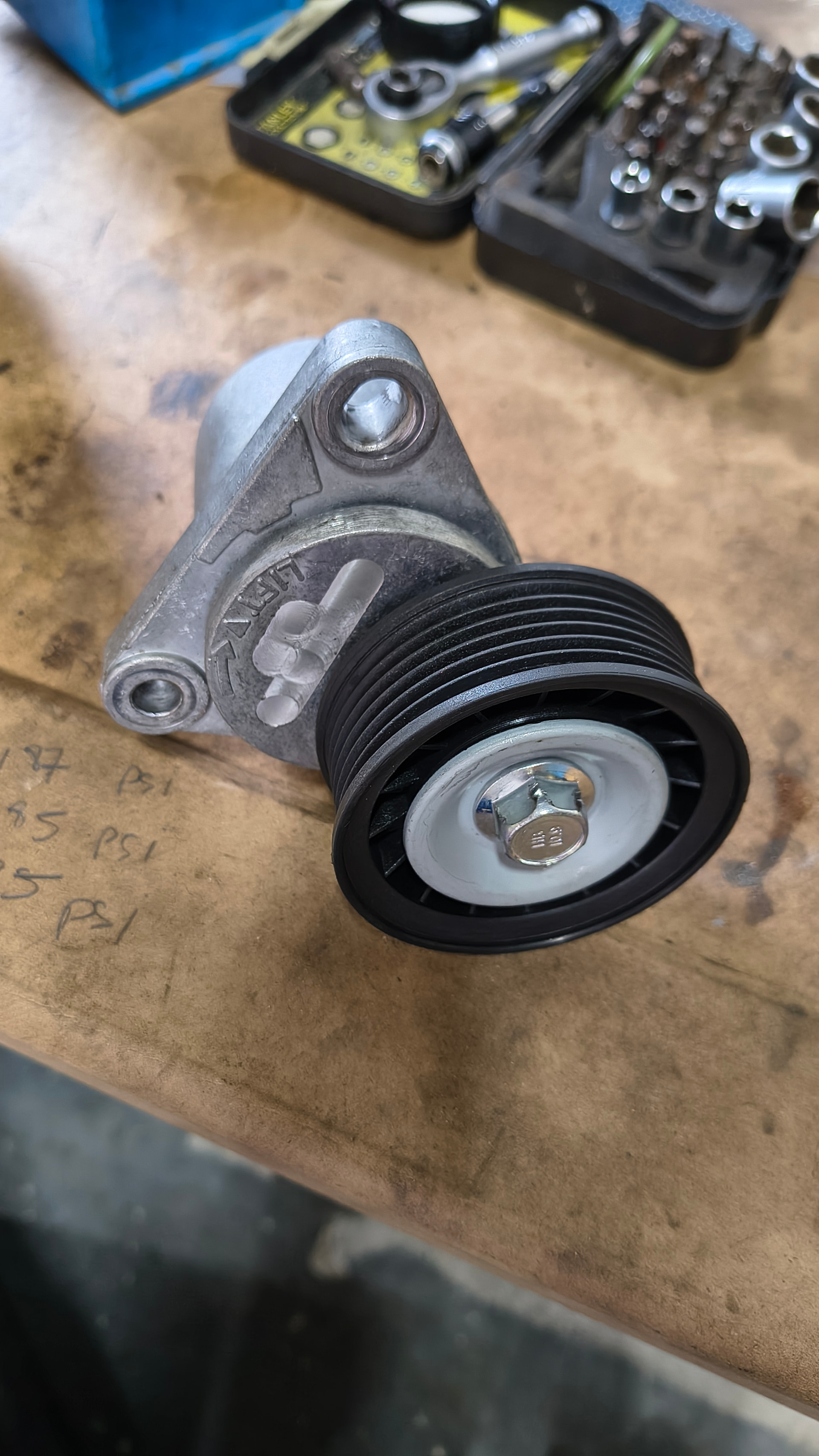

I’m replacing the OEM tensioner with an aftermarket Kavo, and I’m really struggling to get the new or old belt on. It feels as if I need another cm or two in order to be near on sliding the belt. It feels like the tensioner is bottoming out a lot sooner than the OEM. I tried on the tensioner side, roller pulley, water pump, crank pulley, it’s just not enough. Yet when I installed the old tensioner, it went on without a sweat. The seller recommended that I put the car in gear, and rock it back and forth so that the crank moves enough for me to walk the belt on the crank pulley. Is that a thing?

I think my old tensioner still had some juice left, but I’ve basically cut the stopper on the new tensioner and it went in fine. You couldn’t walk it as some suggested it kept slipping off. If it goes I’ll be buying an OEM one. No difference if I’m honest.
