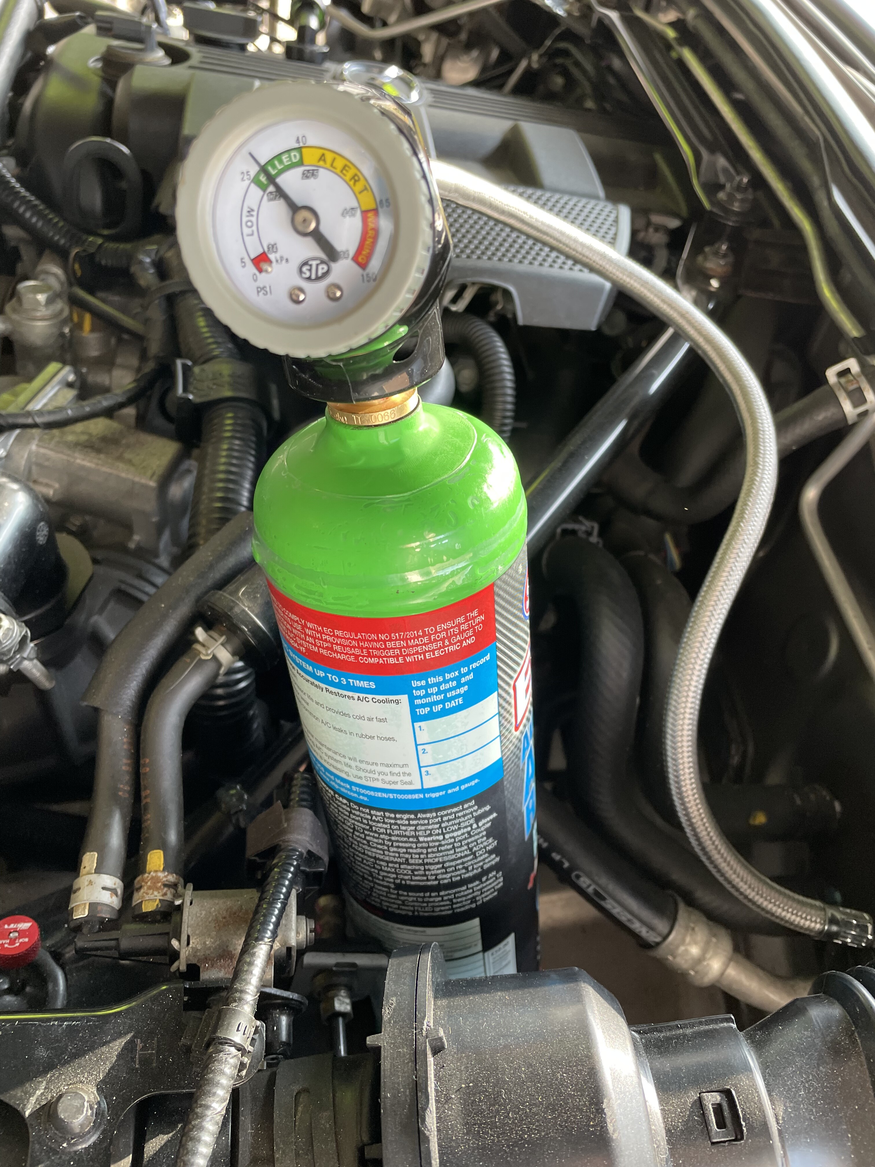

So, having jet blasted the condenser yesterday, been into garage, started car and reversed out. Connected refrigerant bottle up with gauge and checked levels, slightly down TBH. I switched aircon on and put a little more into system and let it settle. I now have ice cold air conditioning in the car, for the first time in my ownership, it’s wonderful! :white_check_mark:
I’m wondering though, have I got a leak or is it just my playing about with it that now everything is circulating properly, has got it to a decent level of refrigerant? Not sure but I’m typing this, sat inside the car (roof up) and it’s as good as the Audi in terms of cool interior :+1:
If I have a leak, I need to locate it but I know the system works correctly, so all parts functioning properly in terms of the system :+1:
I’ll monitor the refrigerant up to going on holiday on Saturday to see if it drops low again, indicating a leak somewhere. Could be in a component, a pipe or seal and that may get left to a specialist :thinking:

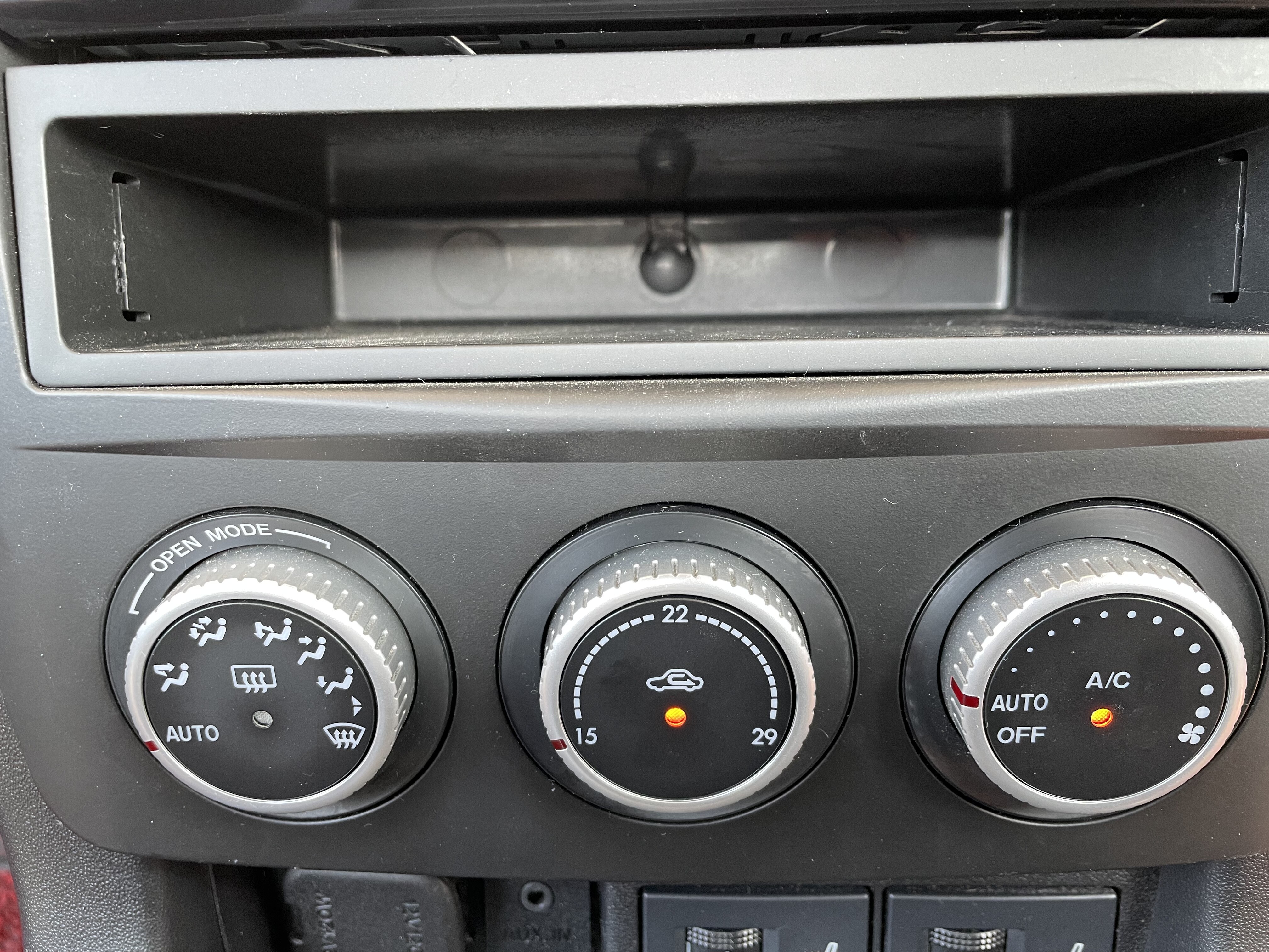

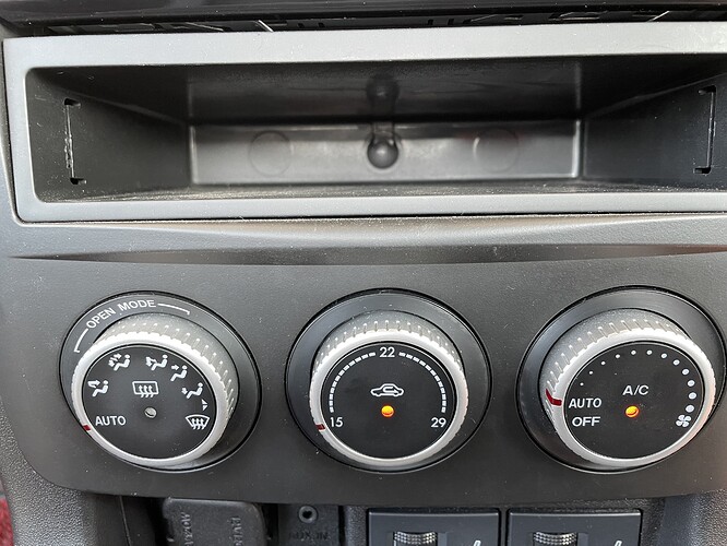

Morning all, just to report back about my A/C. I’ve been away on holiday for just over a week, got back home Saturday afternoon. Car’s been parked in garage. Up early yesterday morning to attend a meet in N Wales. I’d left the A/C controls set on auto and recirculating, started car to reverse out of garage and ice cold blasts of air almost straight away, from vents! Left it on for the entire 170+ mile journey and tried various settings, switching between manual and auto, hot and cold, face/screen/footwells etc. Happy to report the system is working perfectly!
This is not to say it won’t deteriorate going forward (who knows?) but it does seem that the additional charge I put in before the hols, has held, and worked :+1:
Thanks to all for suggestions and ideas given :+1: Might still end up at a garage but for now, just enjoying the functionality of working A/C :nerd_face: In almost 20 years of Eunos/mx5 ownership, I’ve never had working A/C! :cold_face:
