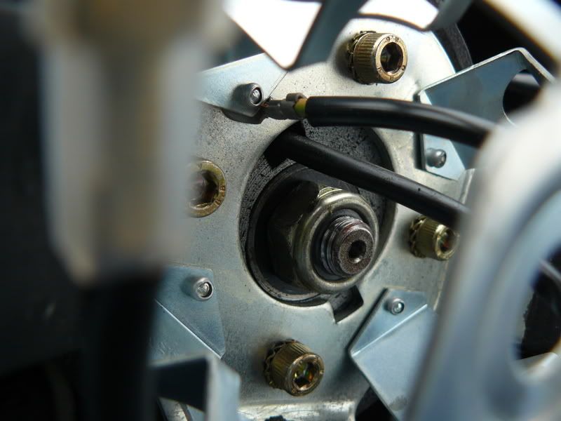

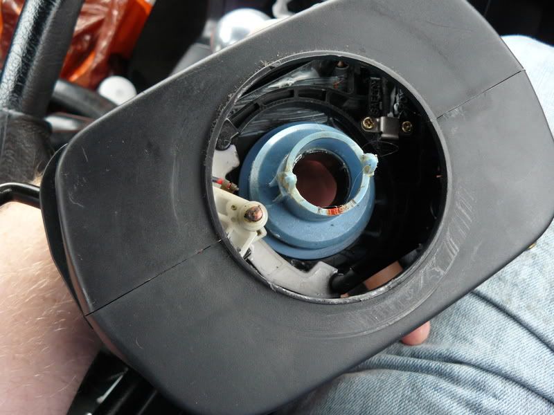

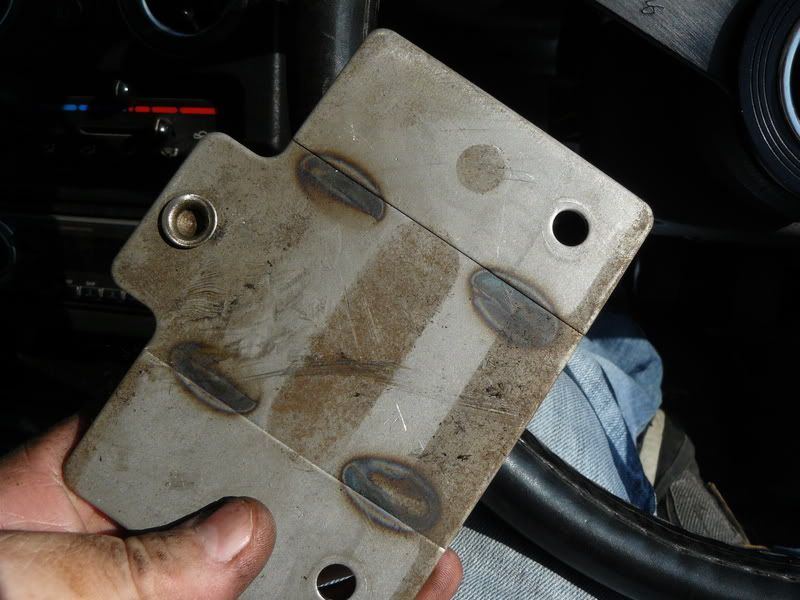

Note airbag cars (and all later cars with the bent stalks) have a spacer block on the steering column (I suspect to do with how the airbag deploys), which isn’t on earlier cars Consequently, these later cars have an offset boss. Fitting a early centric boss to these cars will result in a steering wheel that rubs on the knees, unless the spacer is removed. But when you do this, the column cover fouls on the instrument pod. Also, on some steering wheels, the boss will foul the column cover.
If you’re fitting the Momo Prototipo then I’d recommend the Daikei Boss Hub Kit rather than the Momo one.
The Momo one needs some modification to sit correctly and engage with the indicator cancel mechanism, whereas the Daikei Boss Hub Kit just “works”.
I had to get mine on special order from Japan, but I believe there are UK resellers.
The other bonus is that it includes the resistor kit needed to extinguish the airbag warning light.
I didn’t have the spacer behind the steering Wheel.
I had a boss with a hole in the side for the wires from the horn to come through.
I have to say it looks like it should have been sold with thiS steering wheel.
