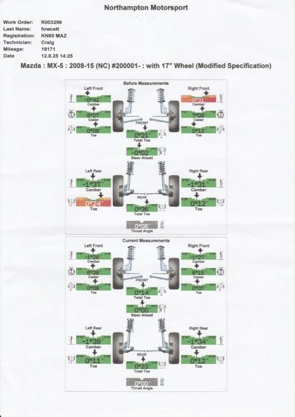

Does anyone with a NC have alignment specs please? Looking for “fast road” settings.
strong

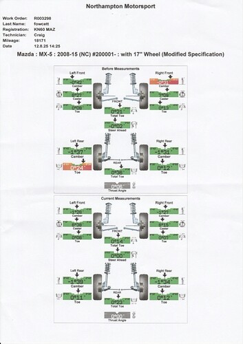

Try this one, this is my fast road settings
Cheers. How do you find this setup?
Absolutely perfect. Like the car is on rails. Also helped by the Uniroyal transport tyres
