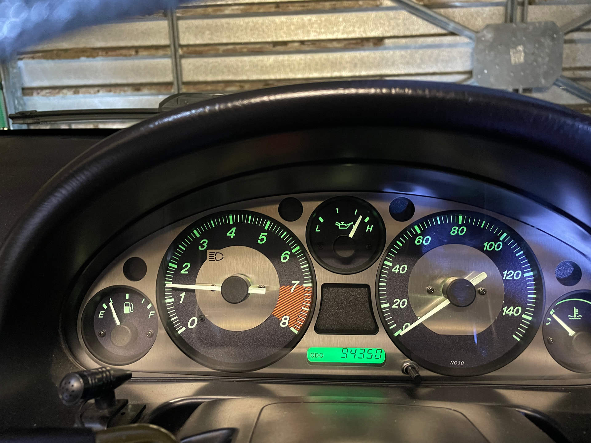

I took a different approach with my ‘99 NB1.
The existing pressure gauge is a proper linear one, but the oil pressure sender is just an on/off switch. So I removed the existing sender just to the rear of the oil filter, and replaced it with a 1/8” BSP male to 1/8” NPT female adapter together with a 0-5 Bar (about 70 PSI) 1/8” NPT Engine Oil Pressure Sensor. The new sensor needed an 8cm length of cable with an insulated male spade to insulated eyelet for connecting to the existing cable. For sensors with both a linear output and an on-off switch, choose the linear terminal!!
Before connecting the cable, take out the gauge cluster, remove its perspex cover and then turn on the ignition. The oil pressure gauge needle should then go over to its previous “Full on” position which in my case was about two thirds of the way across. I repositioned the needle to be at the “H” position.
Switch off the ignition, connect the sensor cable, switch on and let idle, checking that there is NO oil seepage between the block, adapter and sensor.
Switch on and start the engine. With my engine idling at cold and when driving, the needle is just past the two-thirds position. When idling whilst hot, it is just before the two-thirds position and as the revs drop from about 1500 to 860 rpm the needle swings as expected.
If you’re happy with the needle swing then replace the perspex, screw the instrument cluster back in and attach the binnacle cover.
That’s it, done.
