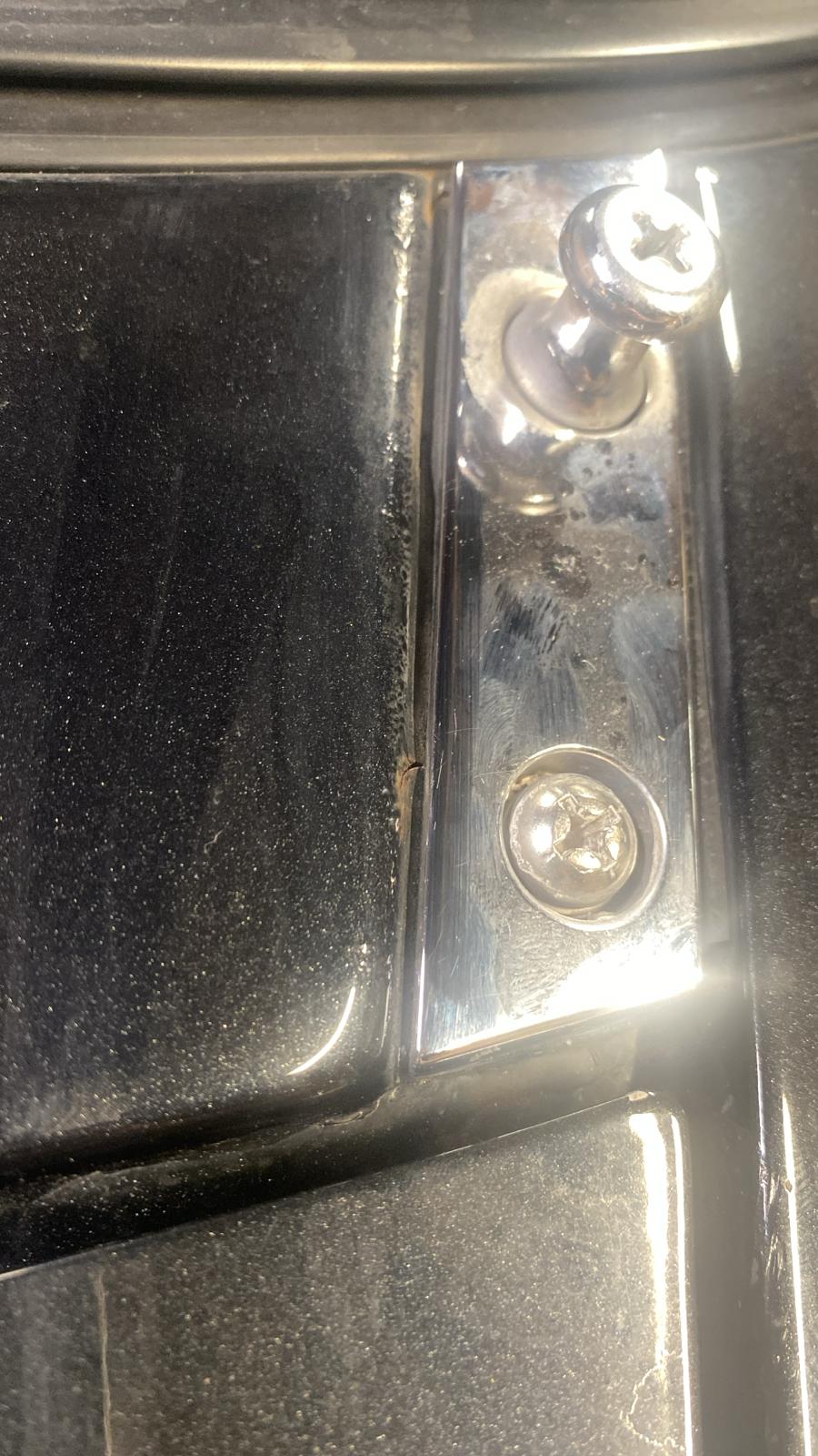

(news users can only post 1 image so the only image is the one the seller sent me directly, here is the link to the listing)
  1. Engine bay looks like have some corrosion/ rust where the bonnet support sits (bottom right of the first image), is that anything to be concerned about?
  2. Second image shows the bootlid starting to have some rust come through, this area isn’t commonly mentioned in many videos, could this be due to a hard top not being secured correctly, is this a major concern?
  3. See the other remaining images in the listing.

Be very, very, very wary of underseal. Underseal over rusty metal looks the same as underseal over good metal. The factory underseal traps water and there can be swathes of rust underneath.
I wouldn’t pay that money for one unless I could get it up on a ramp and check (poke / tap) underneath, knowing what I know now. Take someone used to the cars if you can. They rust from the inside out, and what looks like a little scab on the outside will be major damage inside.
Check chassis legs near where the front ARB mounts are. They look OK until they disintegrate.
Also check in front of the rear wheels at the inner sills and box section.
This looked OK with underseal on:
Boot lids rust for fun - starts around the number plate lamps and the seam where the skin laps over the frame.
I struggle to believe there are any “rust free” ones - maybe just in a less advanced state of decay!
MOT History…I tried searching the reg, been changed, check that first. You really need to get under the car and check everything. Sills, chassis rails, arches, drainage holes…and drive it.

Personally rust in the engine bay is a bit of a flag.

Cant see why they would lie stating its rust free but as said you have to be 100% sure if your paying a premium for it.
