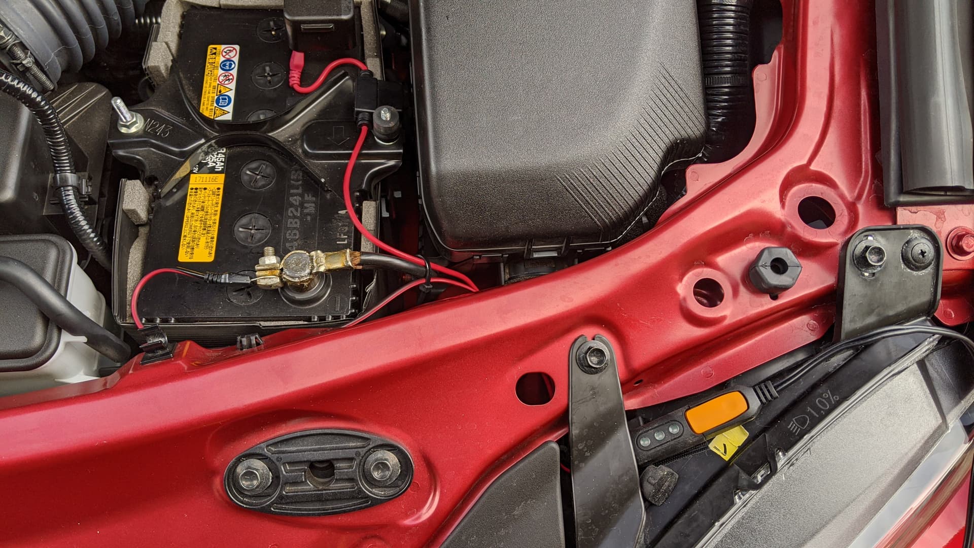

Best practice is NOT to put the - Black directly onto the battery.
Put the + Red directly to the battery and the - Black to an earth point on the car. There are some bolts near the suspension top mounts that are handy and suitable.
You should have a short lead with circular mounting tabs on one end and a plug on the other. You can mount this permanently in the way I highlighted above instead of using the crocodile clips.
Another vote for CTek, I have the extension plug on mine so that I can connect it and close the bonnet.
Just a note to say that this is an ND1, no i-stop so direct connection to the - will not be a problem.
The ND2 with i-stop has a sensor attached so it is better to use a body earthing point for the - just to avoid any potential problems.
