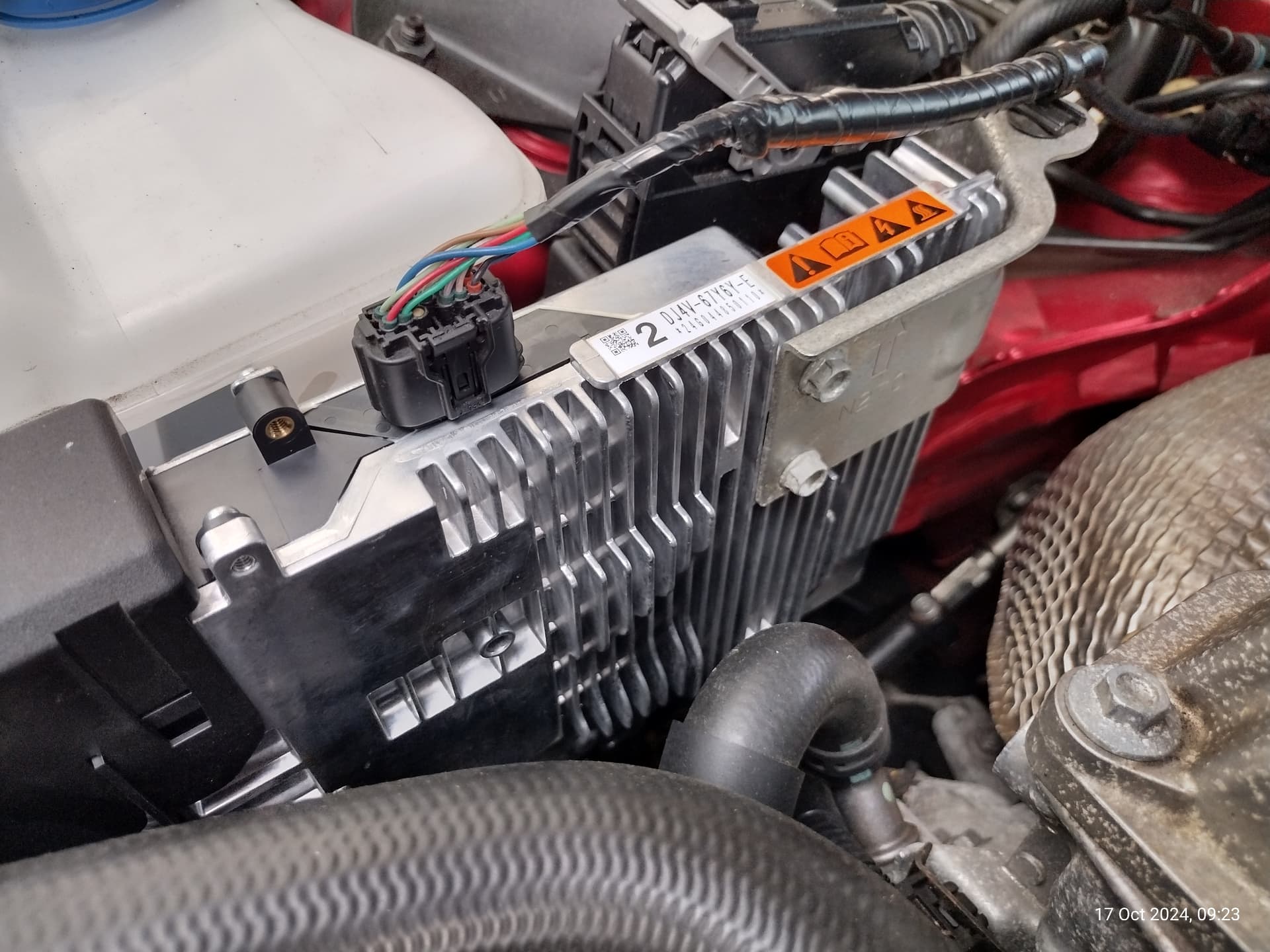

I have just got my car back from the dealer who were investigating the problem of the P2502 fault code issues relating to this thread. They initially suspected the alternator and were going to replace it if the wiring/connectors were found to be ok. While it was in, the Service Manager rang me to tell me that they had recently had a notification from Mazda relating to the fault code and the symptoms described above. Basically Mazda had stated that they had found that these issues were related to a problem with the DC-DC converter on some cars. As a result I agreed to have the DC-DC Converter on my car changed at considerable expense. When I requested a copy of the document relating to the DC-DC Converter issue from the dealer, I was told that they were told by Mazda that they strictly forbidden to do this!
Does anybody know the position and function of the DC-DC Converter as I cannot find any reference in the online Shop Manual relating to this. Is it basically some form of transformer/inverter?
I really hope that this has cured my problems as it has cost me a great deal of money so far :face_with_symbols_over_mouth:.

The capacitor is <> 24 volt, the DCDC converter steps the <> 24 volts down to <> 12 volts.
Thanks guys. Picture of the offending article replaced on my car that matches the diagram in the manual kindly given in the link by Scarletpimpernel. Strange that I couldn’t find it in the Online Shop Manual (Not Mazda issued). Anyway it is very expensive to replace!

In answer to your questions replacement of my DC/DC converter by Mazda cost me £1,300 and does seem at this point to have cured the problem (not many miles done though). Apparently the recall was for a different year of manufacture i.e .2015 as you state and did not include my 2019 model which even though it is the DC/DC converter I would hope that it was for a different fault. If these DC/DC converters are available on eBay, I certainly couldn’t find them and would be wary as to whether they were new/used and what year MX-5 they were suitable for etc. It would be interesting to know how many later DC/DC converters have proved to be faulty.
I think that I should have requested that they returned the replaced unit to me in case it could be repaired. Dealers never repair anything nowadays they just replace as they would not have any liabilities and they don’t care how much it cost the customer.
