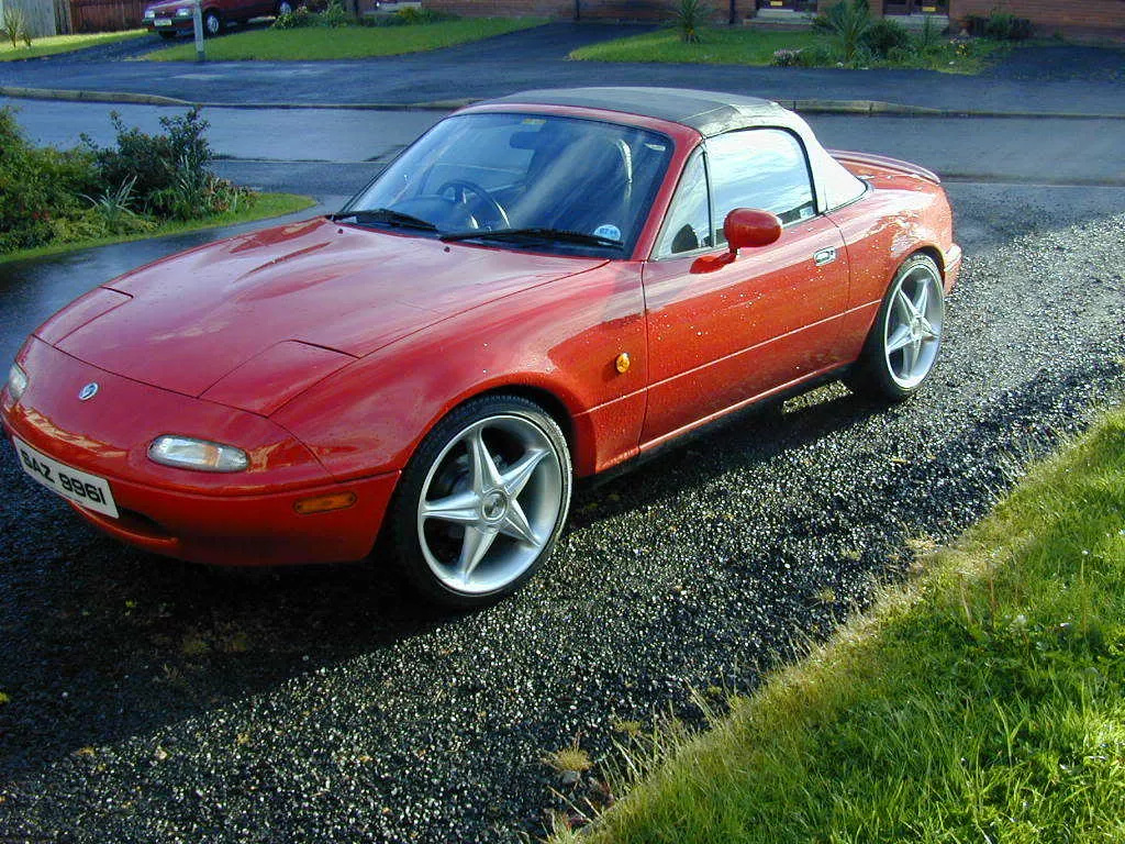

Heavy wheels don’t help.
The original SAZ9961, as brought in 2000.
Previous owner had fitted heavy 17s, PI springs on stock shocks. Nominally, these springs were supposed to be a 35mm drop. As measured, they were a 55mm drop,
