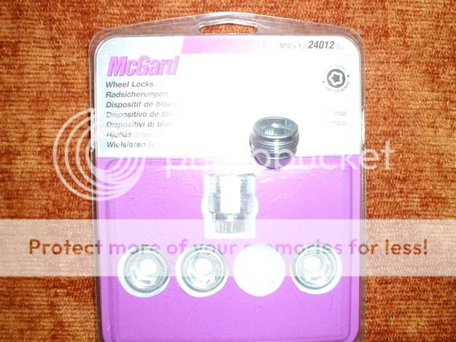

The correct McGard locking nuts are Part Number 24012 as referenced earlier in the thread. They are a usually bit cheaper on eBay. I was lucky enough to pick up a full set for my BBS wheels for a tenner and they fit fine under the centre caps.

all good, I was even surprised how really small they are, barely the same as the original wheel nut. so for anyone worried about the bbs centre-cap clearance, this is definitely it!
