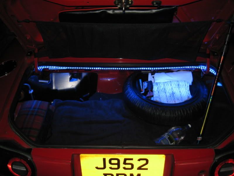

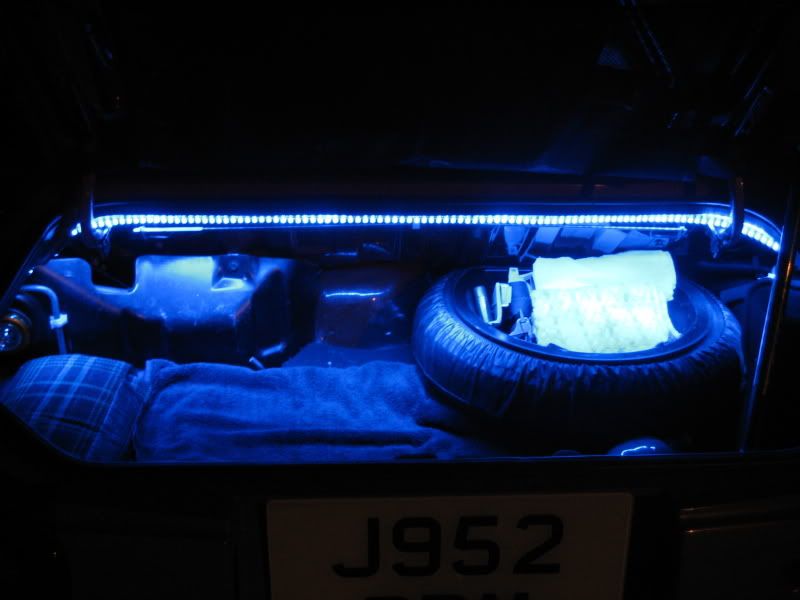

A couple of alternatives, found on Maplin’s site:- A stick-on LED AA battery operated cupboard light or a 12V LED strip.  This could be wired directly to the battery via an inline fuse and a tilt switch.
 http://i107.photobucket.com/albums/m286/bresslaw/IMG_0668.jpg
http://i107.photobucket.com/albums/m286/bresslaw/IMG_0669.jpg
Heres what mine has, LED strip fitted with a switch on the boot lid to turn it on on opening
 Light looks good.
The boot layout in your MK1 looks nice and cosy - pillow, blanket its bijou but a nice space for 40 winks…[:D]?

 I like the LED strip light idea, It looks nice.
(Also, if he ever falls on hard times, He can rent it out as a tanning booth for midgets.[:D])
