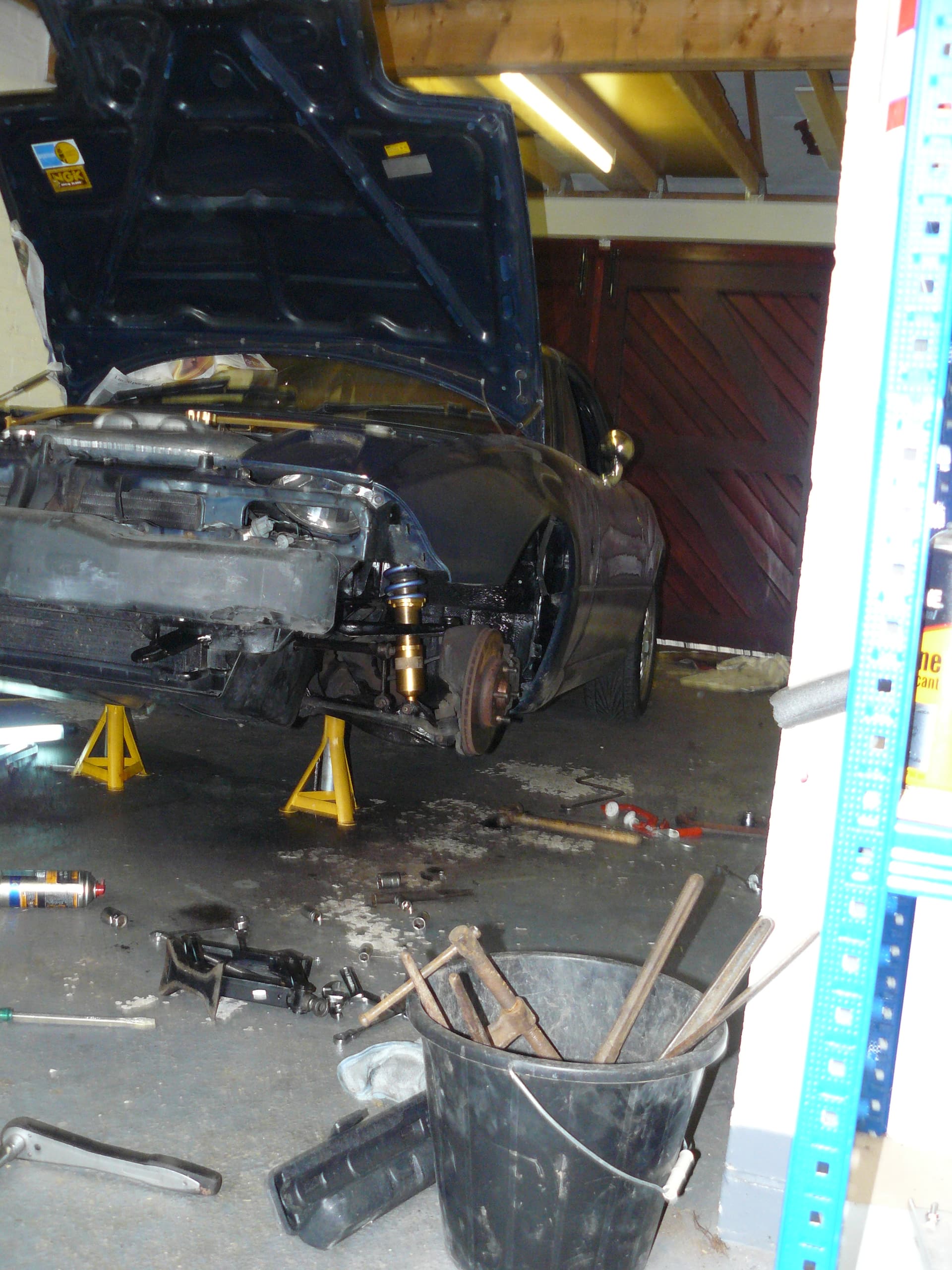

Actually, I had a garage (brand new 2 car space) before that, where the cars rusted, long before the other garage.
Car was welded in 2017, Present house was purchased in 2017. Car was at another location 2009 to 2017. But thanks for your deep interest in my previous postings.
