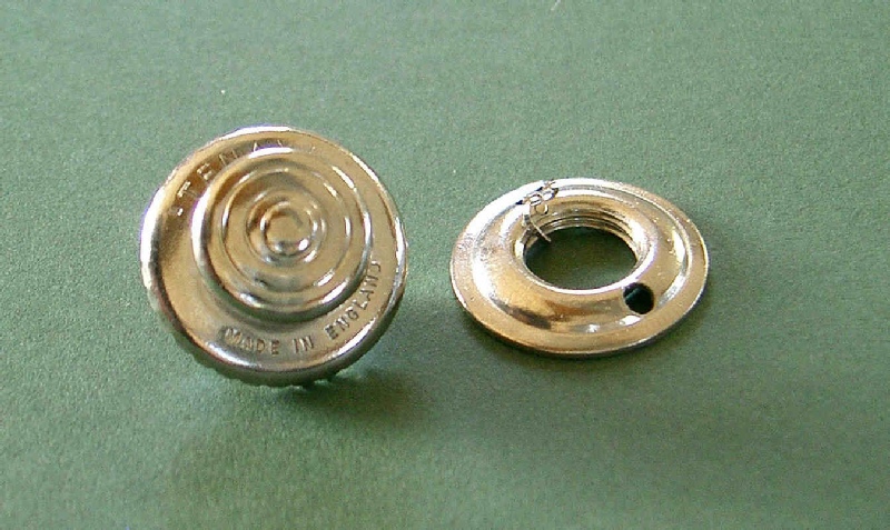

Thanks,  Hi the problem seems to be where the poppers fit it does not seem to want to clip in

 is there diffrent fittings because the popper fittings on the cover look diffrent to fittings on the car
 Press studs on a Mk2/2.5 tenax poppers on a Mk1
Tenax
 Can you post a pic,it sounds like you may have a Mk1 one,which is not a major problem,all you need to do is change the poppers(4) on the roadster for the stud type from a Mk1 mx/roadster,Phone Andrew at Autolink and ask for 4,change them and it will fit,to be honest the Mk 1 ones were a lot better made and last longer anyway.Thumbs up
