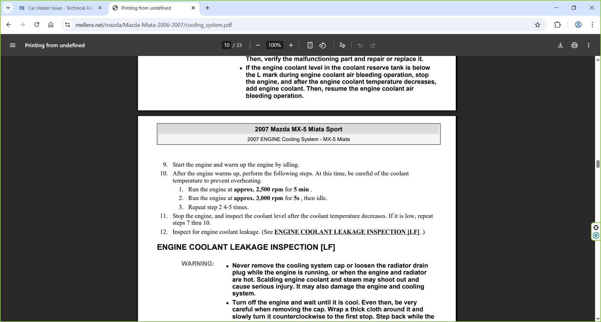

The manual has a process to assist bleeding
