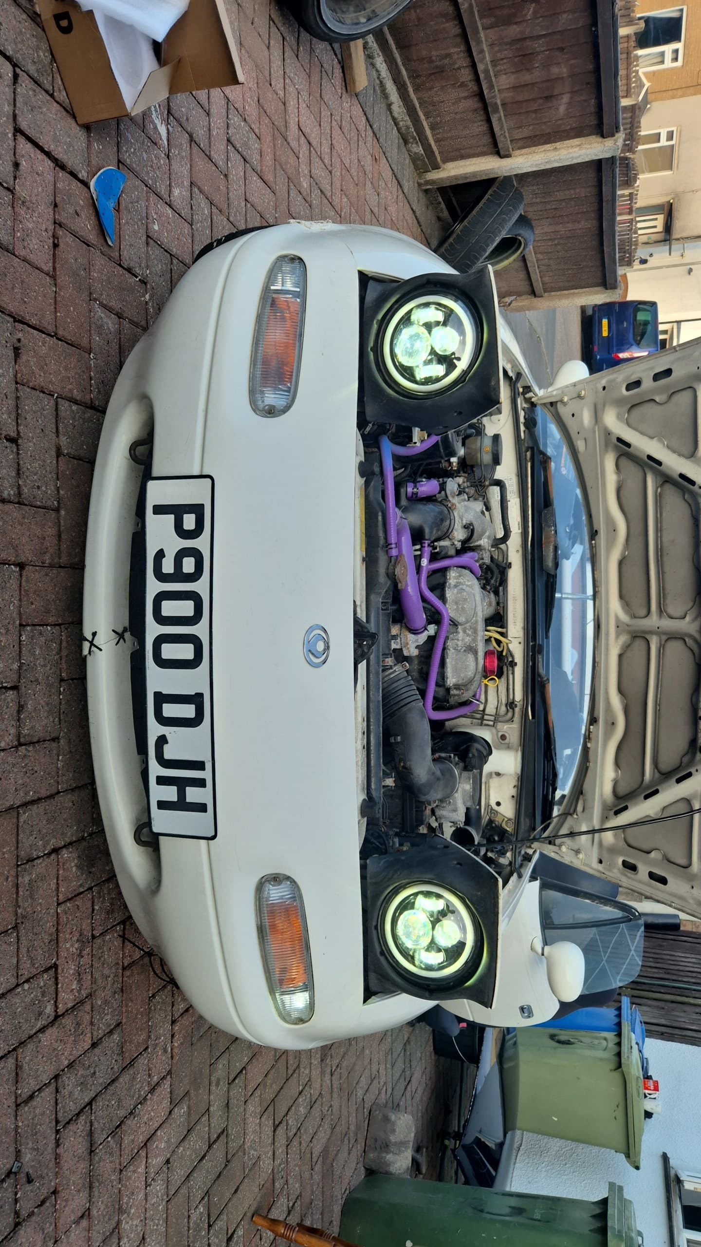

Hi i fitted new lights to my mx5 mk1 when i turned them on it made a click noise the lights was working perfectly however when i turn my engine on now the car starts up and then shuts down immediately dose anyone know what thos issue could be and how to fix it
