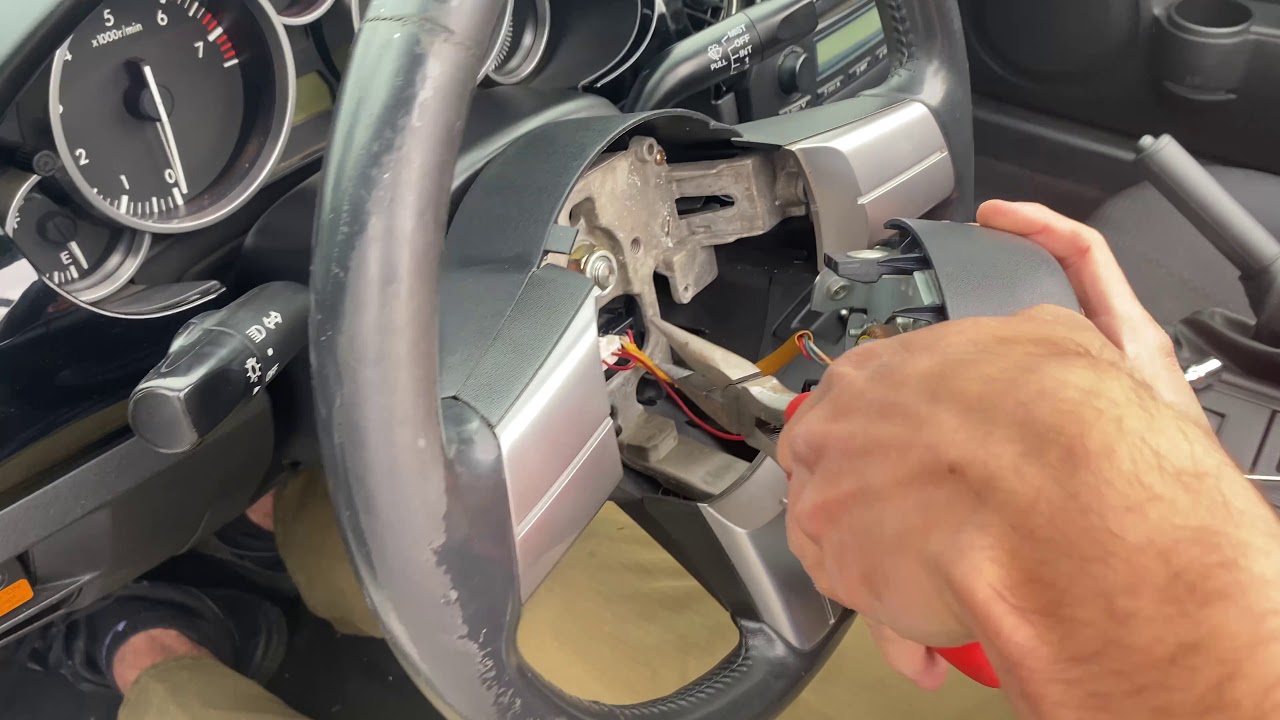

  1. Removing the wheel.
For this, I found this video very helpful:
Note that I think they were working on a slightly different model. I found only the yellow clip on my airbag seen disconnected here:
Everything else was as per the video.
