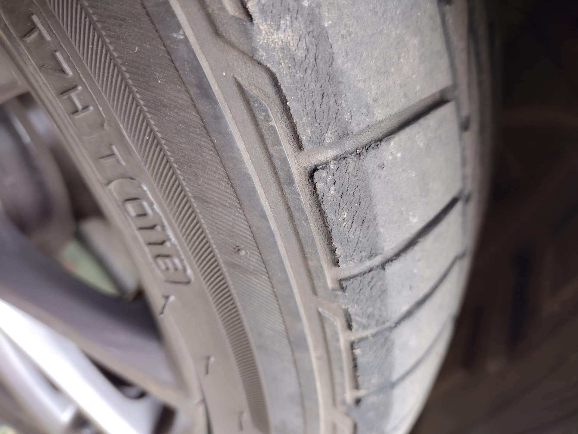

Here are my Potenza front tyres after Curborough. 205/45/R17 88W. (does the code suggest they are over 7 years old!?)
With my stock suspension setup (and probably original alignment gone bad) I certainly wouldn’t want a weaker side wall given how much the car and my cack-handed cornering technique leans on the tyres.
The Pilot Sport 4’s appear to fit the bill (at a price) but I wonder if I would have seen similar wear on, say, Kumhos.
I believe the date code in the photo reads 0116 so 1st week of 2016. So yes that tyre is now more than 7 years old.
4 digit date code:
1st two digits = week of year
2nd two digits = year (I.e.20XX)
Well in that case the PS3’s on the back are late 2015!
According to the MOT history of the car, the tyres have done 32,000 miles! I suspect this was dual carriageway commuting. It also implies that the alignment can’t be THAT bad.
