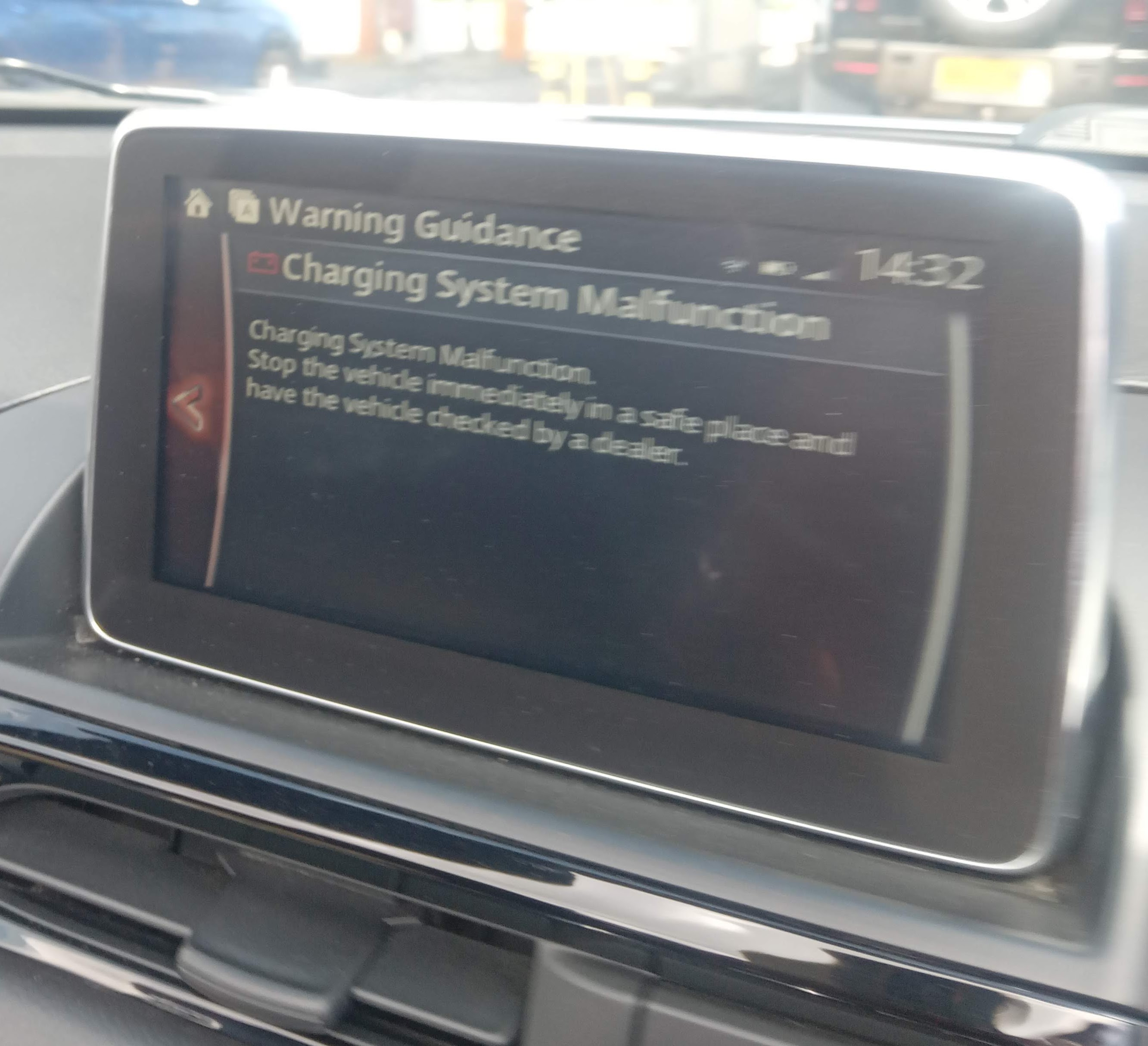

Hi there.
My 2019 ND has had the “Charging System Malfunction” a few times and resets after turning off and on again. Mazda suggested replacing the battery current sensor then the battery then the alternator which I’m not prepared to do unless I know they’re the cause.
Has anyone with this problem ever had it recur after fitting a new DC/DC converter.
Can anyone recommend a repairer in the North West who can fix this for me without changing every electrical component on the car?
Thanks in advance.
Simplest first check is that both terminal clamps are making a good firm connection to their battery posts.
I assume this has already been done, but my RAC rescue guy told me he finds it’s amazing how many cars seem to drive around with “loose” battery terminals!
I had this fault on my 2019 ND. The checks mentioned your dealer are the same as the checks that my dealer suggested, however after booking the car back in they came back to me to inform me that Mazda had told them that it was the DC/DC Converter was at fault and they would order one for replacement on my car on the day it was booked in for. The replacement DC/DC Converter solved all the issues I had had (which were the same as yours). I would get your dealer to contact Mazda UK about this issue, which is known to Mazda before they spend time and your money replacing battery current sensors, the battery or the alternator.
