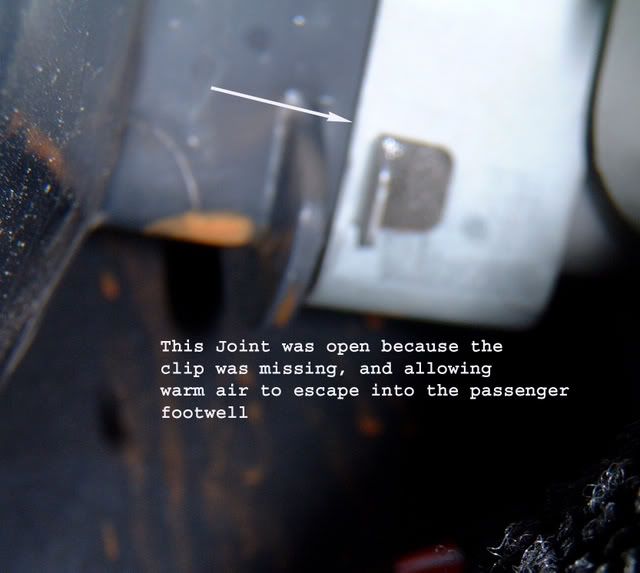

 I’ve been getting a few complains from passengers that cold air is blowing in the car from the footwell.  I followed the faq on check your heater air pipes, and I discovered that I don’t have a clip covering the gap.
Does anybody know where I can get one from?
Many Thanks
John
 Is this the gap that you are speaking about? If it is, I used the C shaped spring clip that you get with the smaller bulldog paper clips. I think that is what they are called
 Thanks for the reply, but its not that clip.  Its the clip in the faq that has foam on it.  I have made a temporary fix with some velcro, but there is still some air coming through.
John
Mazda dealer.
