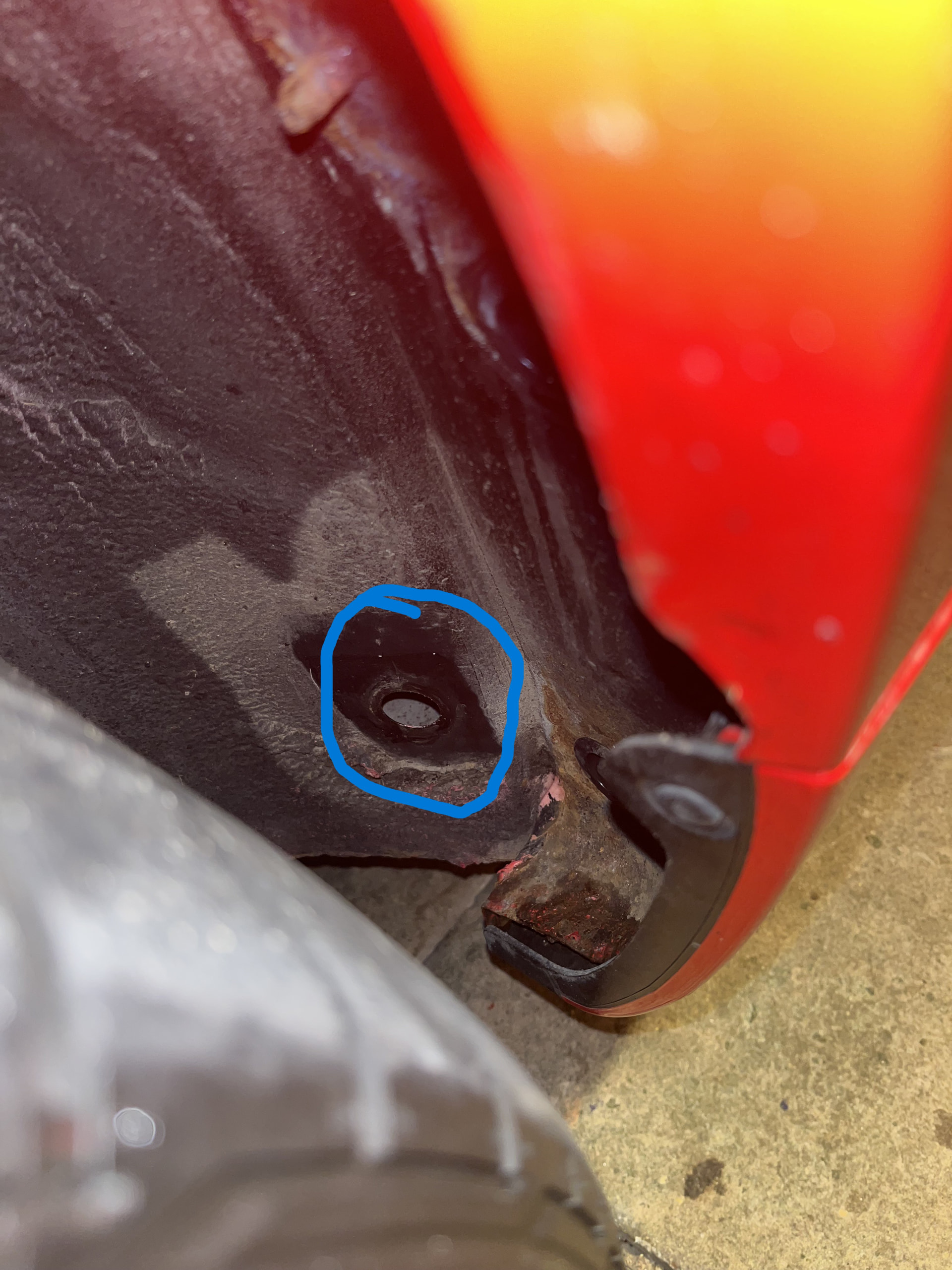

I have just bought my first MX-5, and very impressed am I !! It is a 2007 2litres sport so an NC but I don’t know which one.
I have removed the rear wheel arch liners and the screw seized in the plastic clip at the bottom of the liner. I got the clip out but could not remove the screw.
Does anyone know where i could get one or the part number. I have had a good look on the internet including vehicleclips.co.uk as it is popular on this site.

Thank you for the help. I telephoned vehicalclips and spoke to them about this clip. They looked into it for me and unfortunately they do not have this particular clip, however they gave me the Mazda part number it is
C10051SJ3A £4.70 +Vat
Mazda only have 1 in the UK so there would be a wait time for the other to be brought in.
I therefore intend to if possible drill them out and tap them so I can use stainless steel fasteners as I see someone else had done.

Another vote for drilling and tapping them here. The new mazda items have a plain hole in them and the new self tapping screw from mazda is a nightmare to get to cut into it. Cheap a2 stainless m5 screw and penny washers do a good job.
