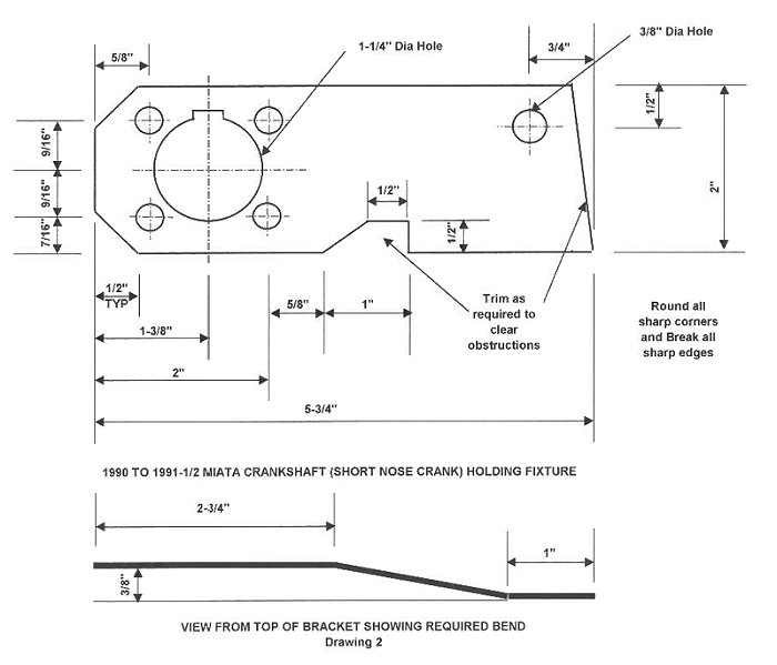

However you do it spend an hour before making yourself a crank locking tool from a flat piece of steel - it makes the job soooooo much more pleasant with much less possibility for injury to yourself or your vehicle.
This is said to be for a short-nose 91 model, but a similar shape works fine on a 92 onwards model:

This one is made from a couple of bits, I found a single flat plate easier to use.
http://www.jhodson.net/miata99/crankshaft_tool.jpg
You don’t need to remove the bottom pulley on a 1.6, certainly mine wasn’t disturbed when the belt was changed

“You don’t need to remove the bottom pulley on a 1.6, certainly mine wasn’t disturbed when the belt was changed”
You do if you have the later big-nose crankshaft (1992 onwards I believe) - there’s a large flat retaining collar that prevents the belt sliding off, and it’s held in place by the crank bolt.
You can see the collar in this image:
http://www.miata.net/garage/images/crankshaft_tool.jpg
