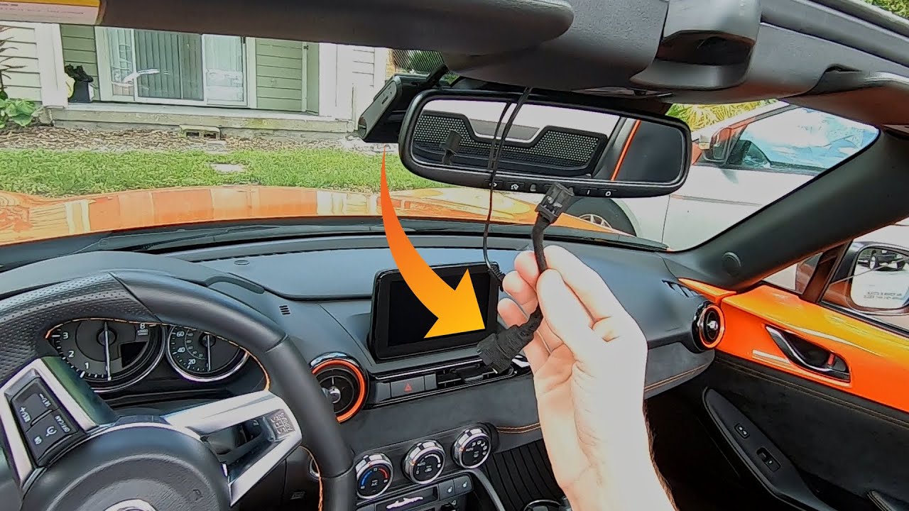

As for standard front facing cameras, has anyone wired in this way?
My mirror doesn’t have all the buttons that one has, but does have one which I think turns the auto dimming on and off and so does have a cable running into the back of it.
It just looks like a quick and easy alternative to removing a lot of trim to hard wire in.
Planning similar… Did you plug it in with a connector into the back of the rear view mirror? Is that possible?
Did you manage to connect direct to this type of mirror?
No I haven’t. TBH I forgot all about it.
It seems from the lack of replies that no one here has used that particular solution.

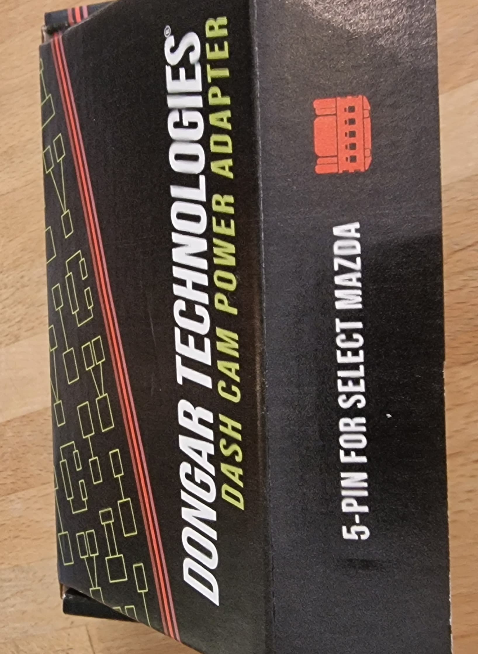

Just ordered this adaptor from USA Amazon, I will let you know how it goes along with a Nextbase 222 (from UK Amazon) this also has a rear camera attachment.

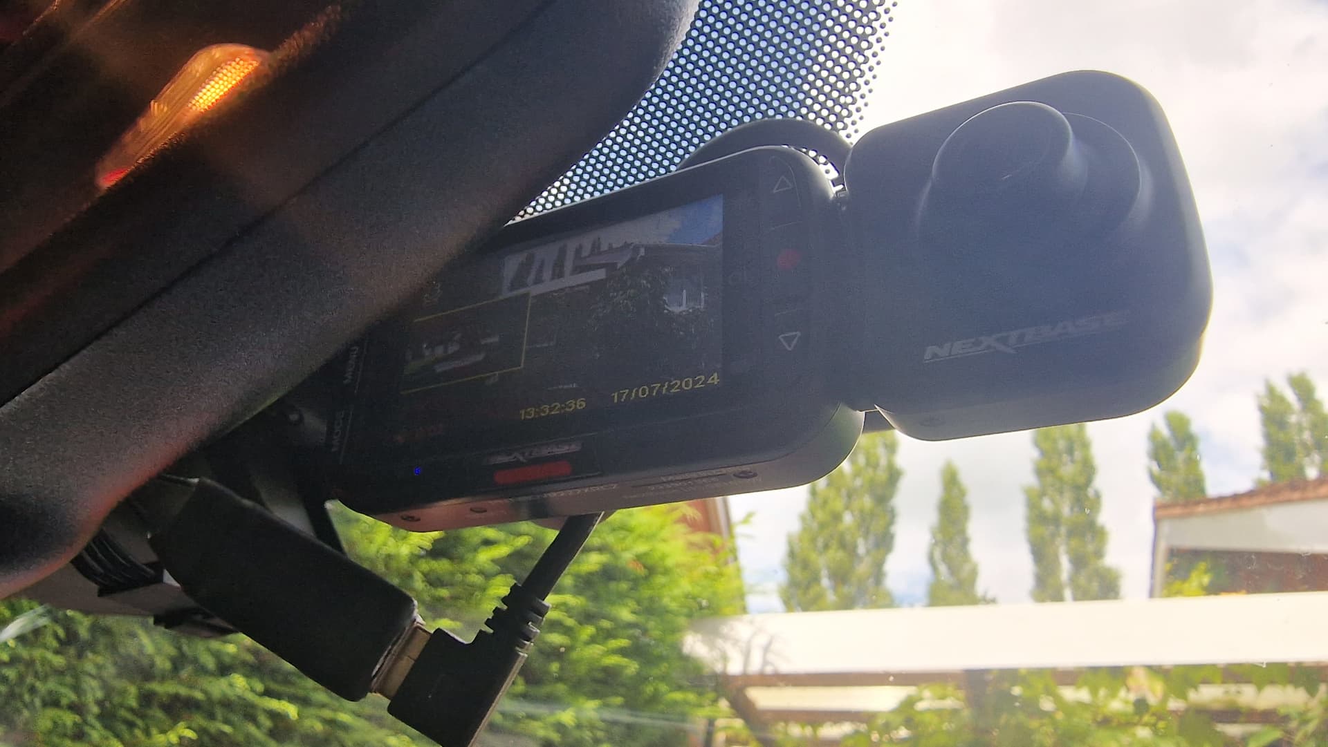

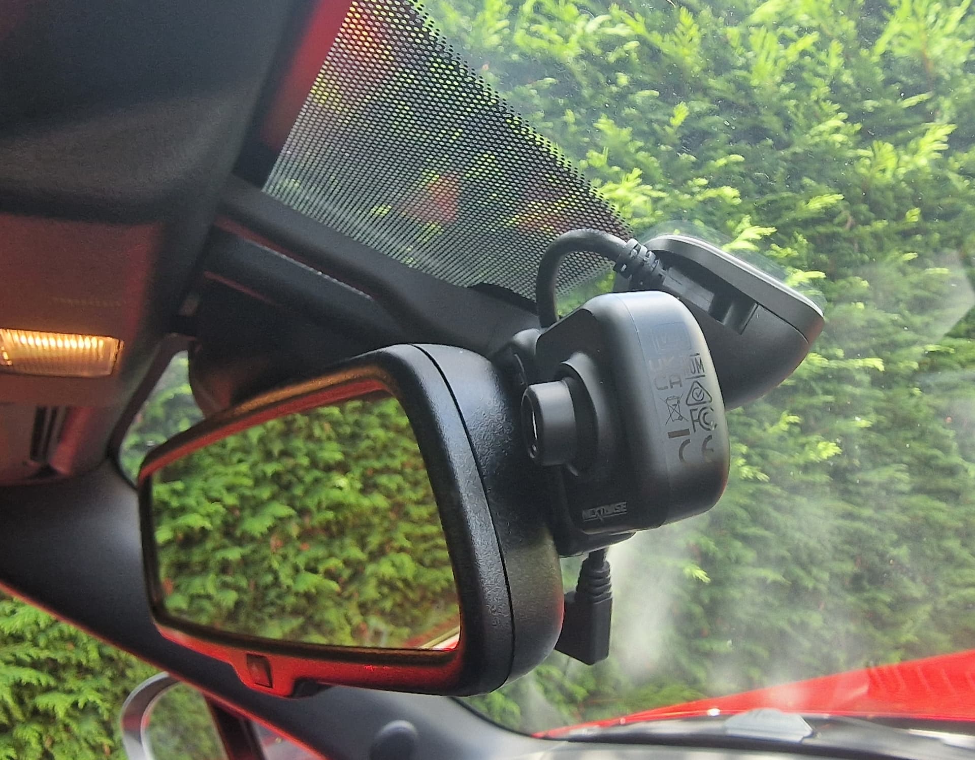

Took about 3 minutes to fit, tight fit behind the mirror. The rear camera lens is adjustable so I get picture out of the rear window, probably better with the roof down. The adapter from the US Amazon took a bit of time to get here but worth the wait to save me having to hardwire it in through the body etc.
Further to this the cam was too tight with the mirror so I have moved it to the left of the mirror, works a treat.
