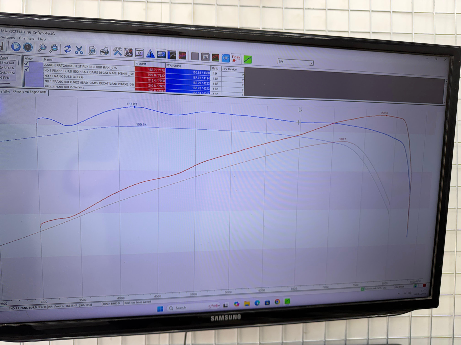

DYNO NUMBERS
I think PLink have wrappped it up now? im just waiting for the final overlay dyno. but some headline numbers and screenshots below;
(numbers rounded to nearest whole)
Horsepower - 188bhp to 225bhp@7500rpm = +36bhp
Torque - 150lbft to 170lbft = +20lbft
Some big jumps!

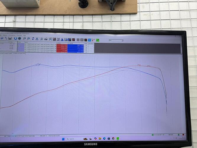

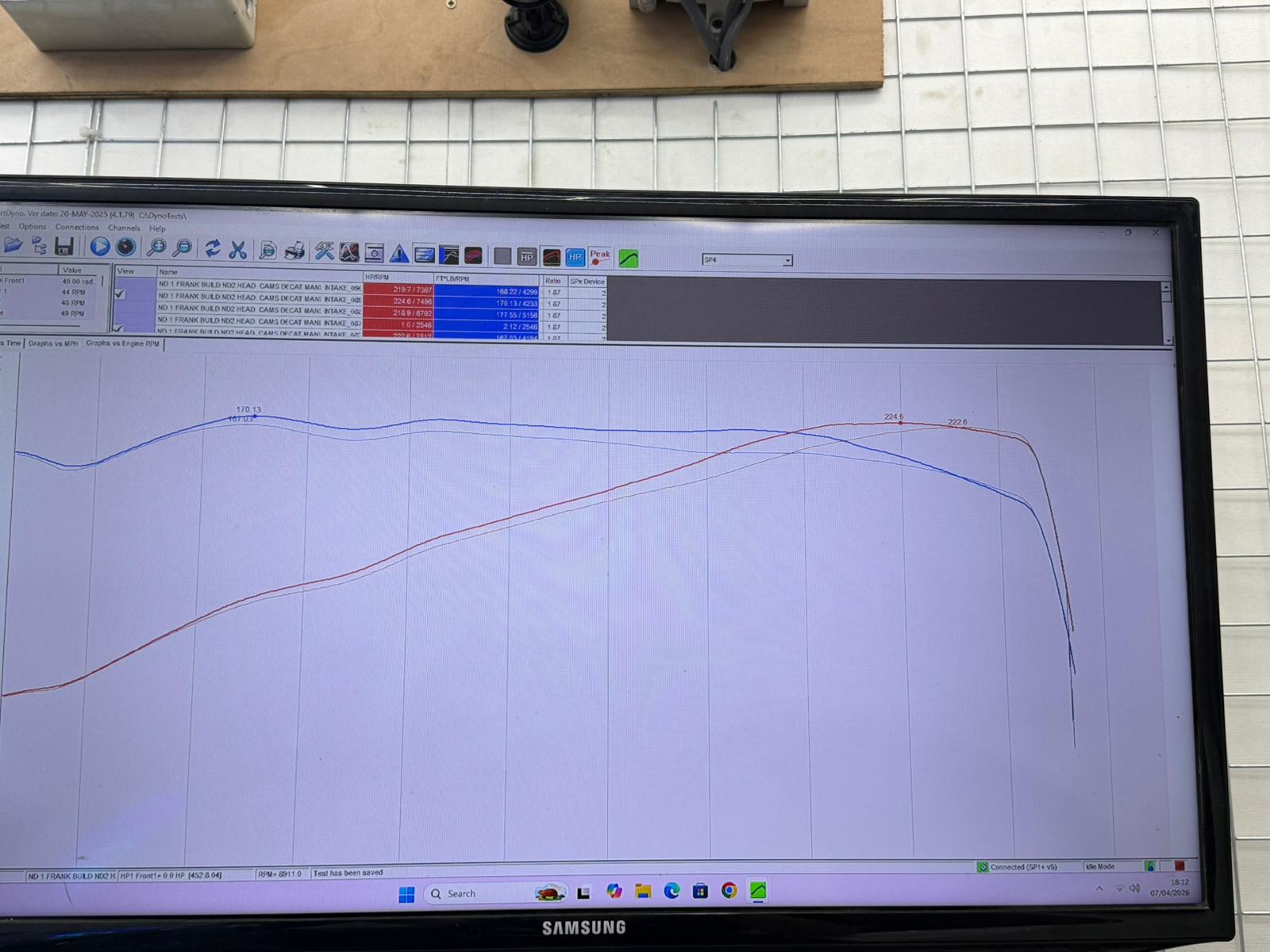

the screenshots show the ā€˜arrival’ overlaid with a 222bhp@7800rpm result. some more messing around with timing on the map yielded more results, and brought the power band a little closer to the left. 2nd screenshot shows this tweaking between 222 and 225
Very happy. I was really hoping to hit 230bhp, but i hit my target for an extra 30bhp, AND didnt sacrafice torque to get it! i was expecting a midrange slump. its hard to see on the screenshot, but looks like a dead flat torque line until 7000rpm!! wow.
Just waiting now to find out if ā€˜ā€˜this is it’’ and the tunings completed. then will be able to publish the pretty graph :slight_smile:

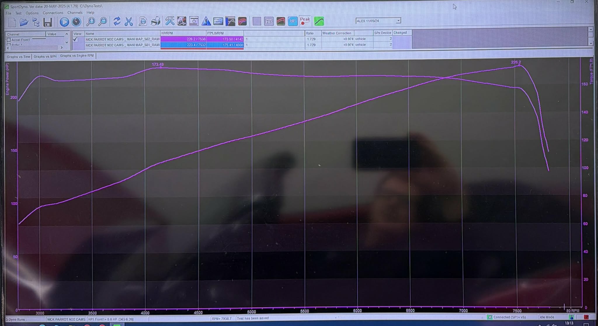

The ND2 you mentioned previously was mine. So my ND2 with BBR cams I fitted, full stainless exhaust with custom rear box that we made and an Proram air filter made 226bhp and 173lbft.
Interesting that the ND2 head porting didn’t get you a little more, but you got very close to ND2 numbers, so good job. Don’t think I want to be paying your PL bill :sweat_smile:

Here is my graph, quite similar as you would expect, dips and rises in the same areas:
:+1::+1:
I sent this to Alex earlier actually, said our charts look almost identical! Same characteristics.
