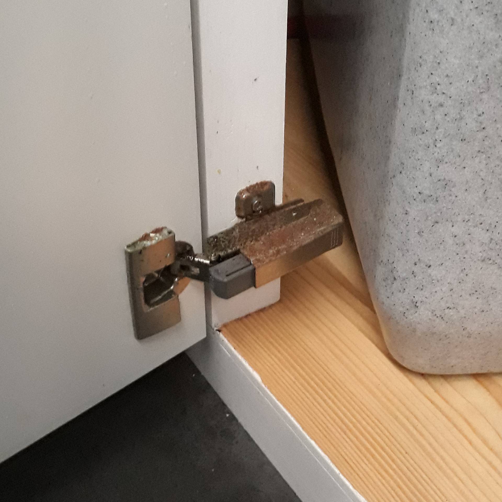

We have a water softener. It’s in the cupboard under the kitchen sink. It takes salt blocks. These are enclosed under a cover. The cupboard door hinges closest to the water softener rust very quickly - and there is not direct contact. I always used to think the saying about ‘don’t buy a car that’s lived on the cost’ was a bit dramatic, but it’s scary stuff.
Mine too, but slightly dusty tablets instead of a block!
I thought it was because there is some dust spray and slight splash, and the generic hinges feel very much like they are made down to a price.
But they still work after fourteen years in an unheated, well ventilated laundry, so it’s only a mild surface rusting.
I took a picture for a better look and notice its mostly on the top surfaces, eg salt dust and washing powder falling, etc. The grey plastic tub is the water softener, I need to slide it out from that corner to top it up.
