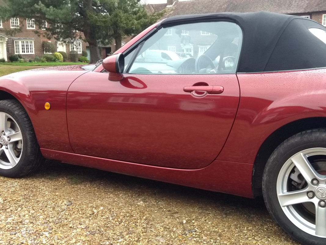

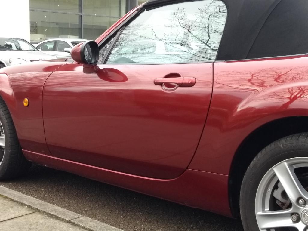

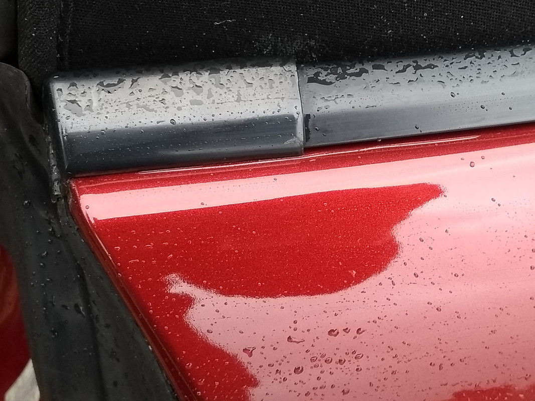

Update - S50 now back from the menders.
They’ve fitted a new door. I’m pleased with the colour match, paint finish on the door, the general fit, and the panel gaps. Door built up nicely and all electrical bits work fine. First impressions, very good…
So far, so to be expected.

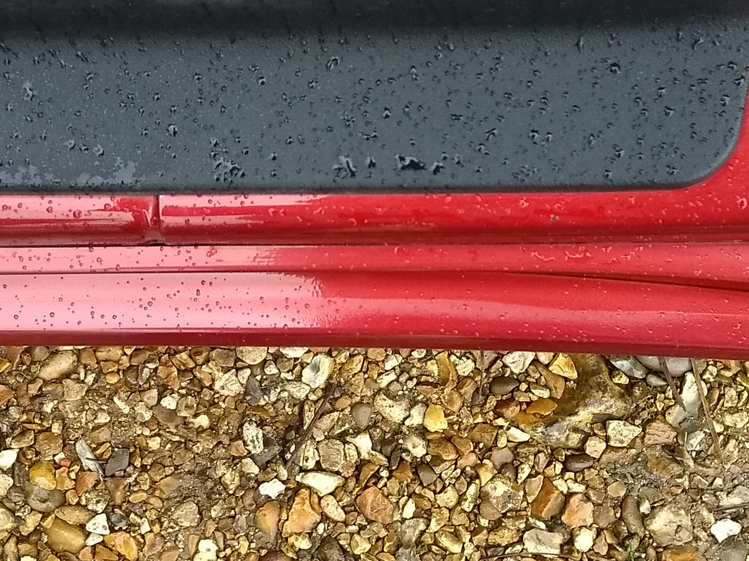

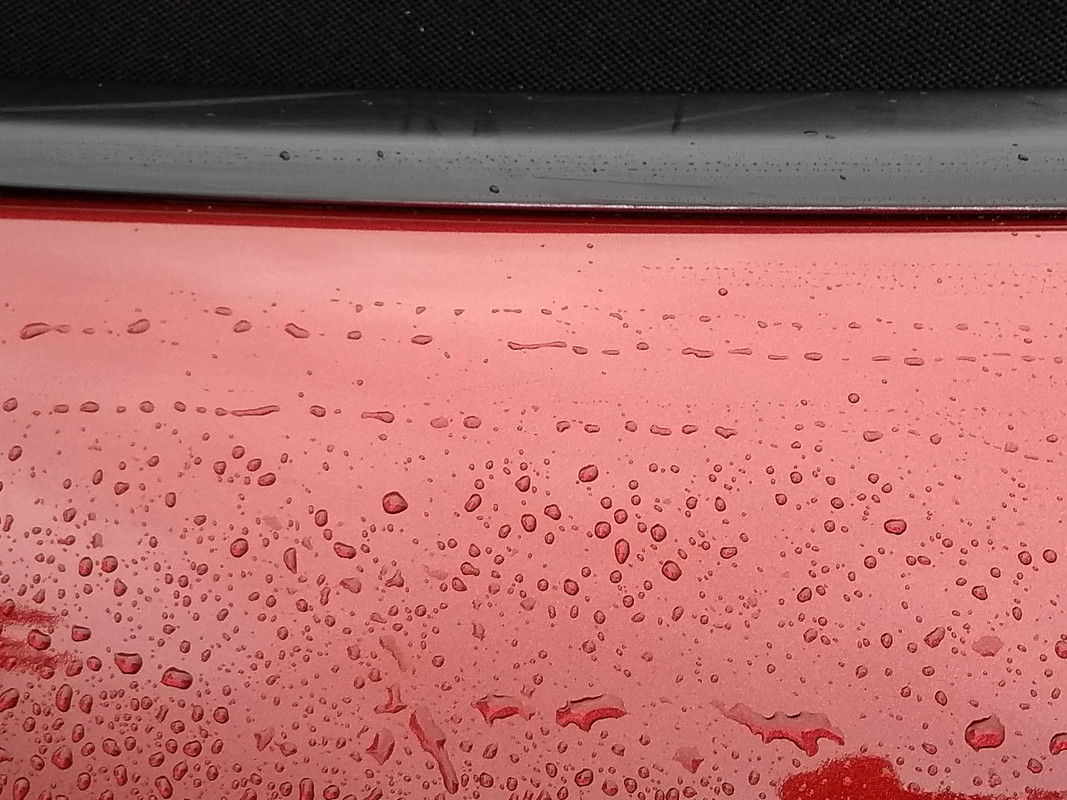

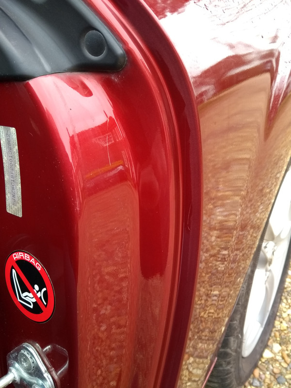

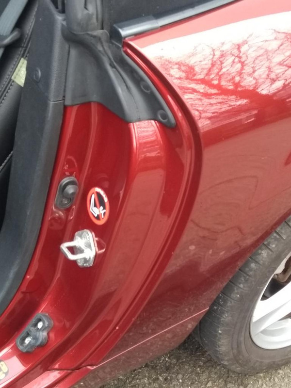

Unfortunately, the eye for detail has missed:
tidemark where the new lacquer on adjacent resprayed B-post panel hasn’t been blended - this extends right down the door aperture and forward along the sill:
Plus a ridge of poorly-masked lacquer immediately behind the door aperture:
and overspray on the rear trim…
So back it goes next week. Sigh…

That’s bad news Steve sorry to here it, looks like a bit of a bodged rush job to me, poor masking, orange peel lacquer and what looks like as you say over spray on the rear trim which is concerning as it looks like primer, are you sure 100% that is a new door if it is it must have been painted on the car after fitting.
I would have painted the door at least in primer off the car to avoid that problem makes my painting look excellent.
Hope you can get it all sorted soon.
Tim.
To be fair, the quality of the new paint/lacquer is very good - it only looks ‘orange peel-ey’ because the pic is zoomed right in.
Definitely a new door - I removed the door card to check. The door’s all fine - but they’ve sprayed most, if not all of the rear panel from the B-post back, to ensure a perfect match I guess. It’s the attention to the edges of this part of the job - in the areas I’ve photographed - that’s not so great.
We’ll get it sorted.
So just to close this story down, S50 returned a few days ago, for the second time. The niggling details I grumbled about have been properly attended to (including pulling the door latch in one millimeter so that the rear of the door closes totally flush), and I’m pretty pleased with it. The only giveaway now, that something’s been repaired is the lack of hologram identifying sticker on the new door.
