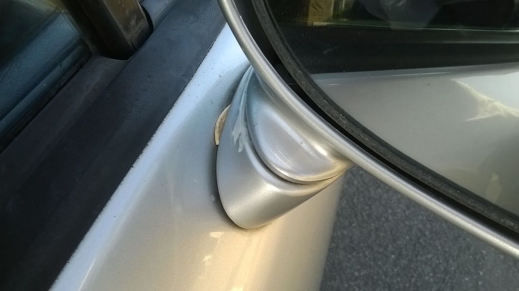

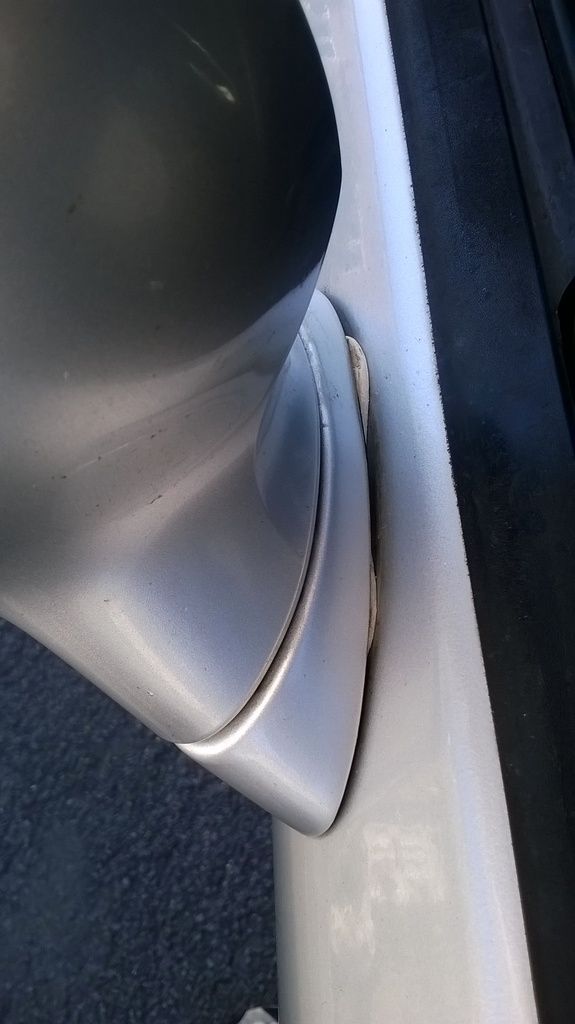

Door mirror 2Door mirrorGot a similar problem, the drivers side electric door mirror is lose and I can’t figure out why?, the 2 screws under the mirror (after rotating it to reveal them) are tight, but it still rattles. My temporary fix was a I happen to be eating an ice lolly (it was a nice day) and had the crazy idea to jam the stick in the gap and tighten it! It’s not very professional, but it worked. Any suggestions would be appreciated. See pictures, if they actually upload…
Are the screws tight as in holding the mirror or are they rusted in their holes? Will they unscrew?
Remove the mirror, drill out the nuts and rebolt with new bolts/nuts, washers but you have to hold the nut with spanner on the inside
Hi Roadster Robbie and Robert Maguire,
Thanks for your replies, I managed to loosen the 2 screws carefully after an overnight soak in WD40 and retighten them carefully and it worked.
