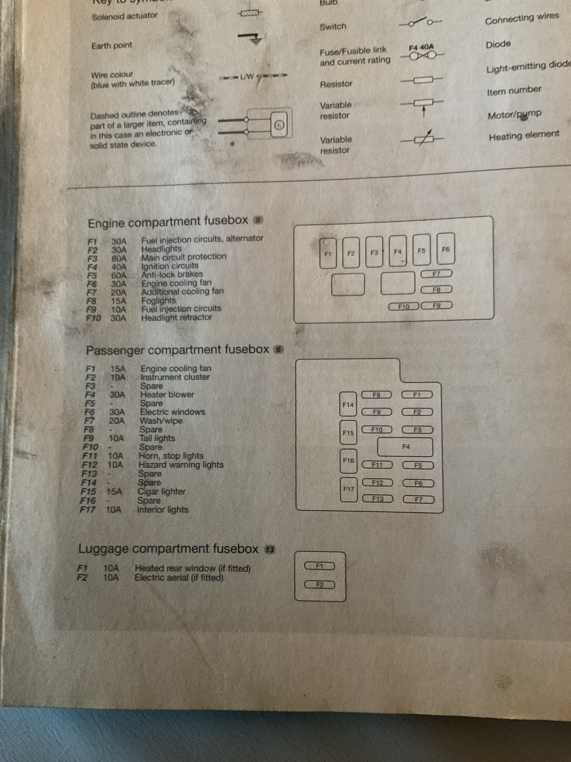

F10 fuse in engine compartment fuse box is for headlight retractor. 30Amp
The one for the instrument cluster is under the dash in the F2 position. 10Amp
I’d highly recommend getting a Haynes manual.Mx5 MK1&2 Haynes Manual
i’ve got it. :grinning_face_with_smiling_eyes: never thought to look. (rolls eyes at myself). and thank you for posting that page anyway.
ahh f10, it was the right one.
