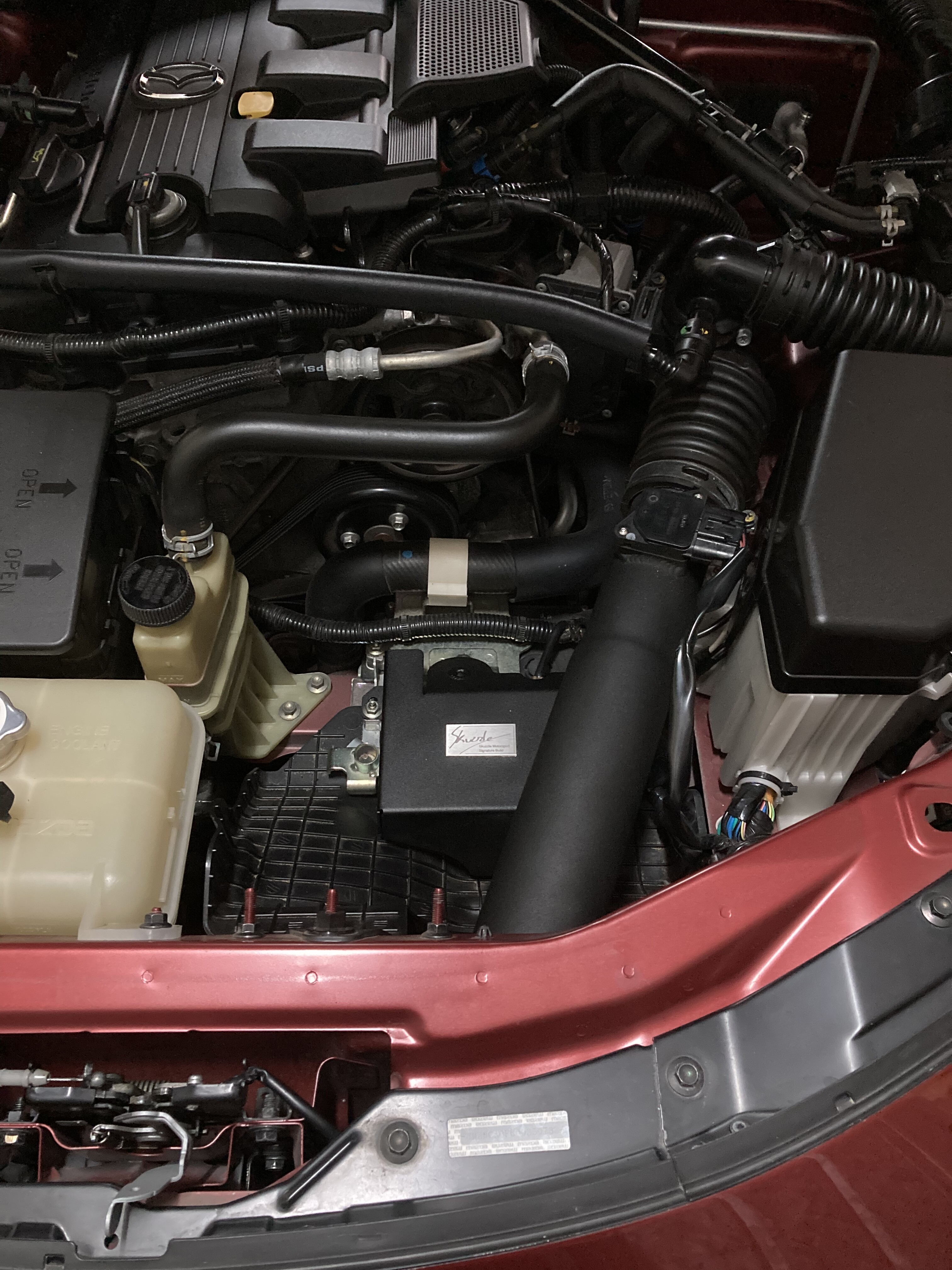

Any pics of this fitted?
Hi
Not one of the engine bay. It replaces the black air box completely so you just have a black metal pipe there instead.
This is where the filter sits.
It would be bumper off then each time that filter needs attention, oiling etc or under tray off?
not a big job taking off the bumper
If you map exclusively for 99 you’ll see some gains. Also the map on the later cars had better driveability so the early ones can be made better in that respect.
No, you can just undo the bottom tray and get you hand in and with a screwdriver from the front to undo the clips. It just needs washing if it should “get really dirty”.
No oiling either.
I bought a spare filter which is still sat in the box as not doing the mileage at the moment. :slightly_smiling_face:
Picture from the top.

Thanks for pics. No fear for water?
Discussed the water aspect at the time in July 2019 with Skuzzle.
They had no problems reported back. They did have one chap request to modify and move the filter into the original space where the filter housing was.
Sort of defeats the object really…(Cold airflow and all that).
The design of the filter which is strong SS wire mesh and quality foam and the angle fitted prevents any water ingress/suction.
I have used mine in “Torrential” rain on a Europe tour and ever since with no problems.
I WOULD NOT wade with it mind. On saying that I have never done that with any of my cars, (except tanks when I was in the Army). Why would you anyway, find another route or if escaping mother earth or going to a fall out bunker disconnect it at the top perhaps. :wink:
One guy did write his car off with one fitted driving through standing water.
