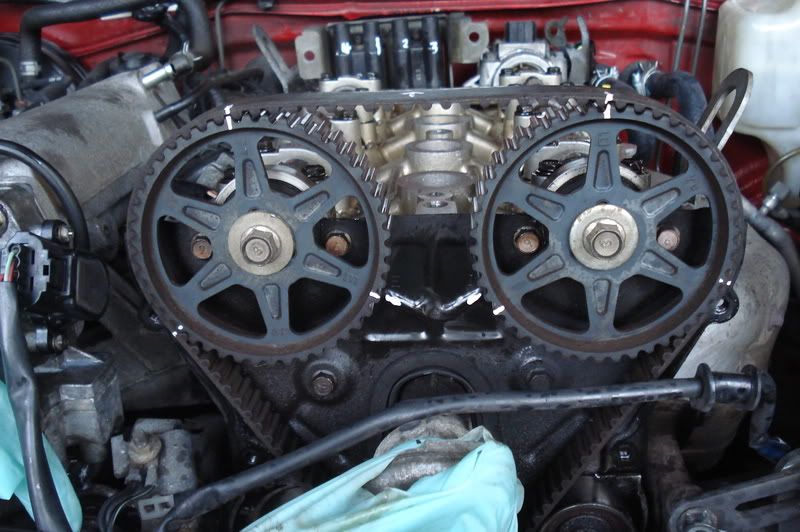

You need to get all three pulleys lined up. There are some pictures in this thread that will help, but I think that you may need to remove the lower belt cover to get a proper look.
 ok so if i check if all pulleys are lined and if they are not i can get some to remove the belt and replace the right way then all should be fine?
Here’s a pic to show the general alignment details
If they did not line up I would be concerned that the belt has apparently jumped on one or more sprockets and that even if I refitted the existing belt in the correct position there is every chance that it could happen again.
Having reached this stage of disassembly it would perhaps be prudent to consider replacing the cam belt and tensioners if there is evidence that the belt may have slipped.
