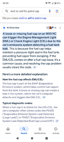

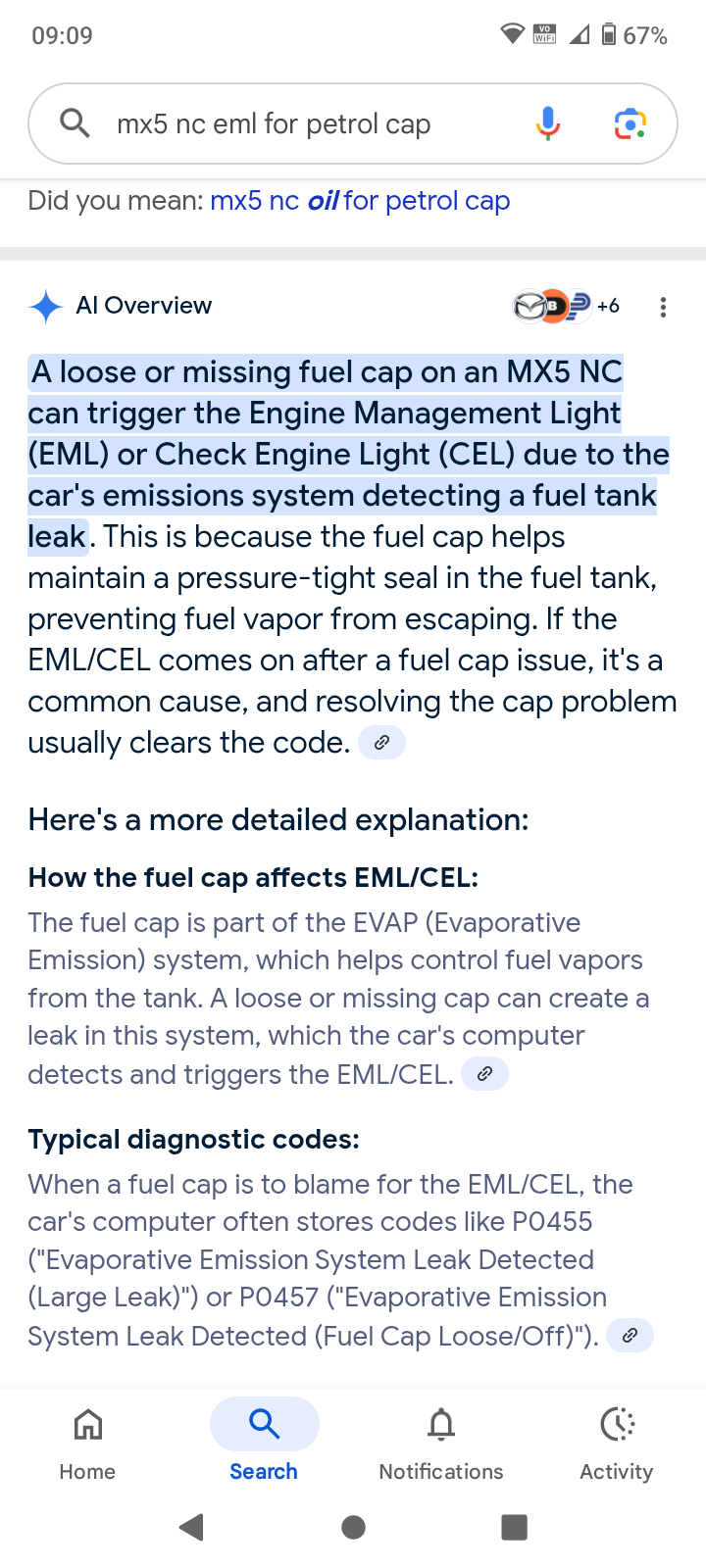

Turned out eml tripped by fuel filler cap not tightened enough :roll_eyes:
Interesting🤔 , thanks for the reply I’ll check that in the morning.
