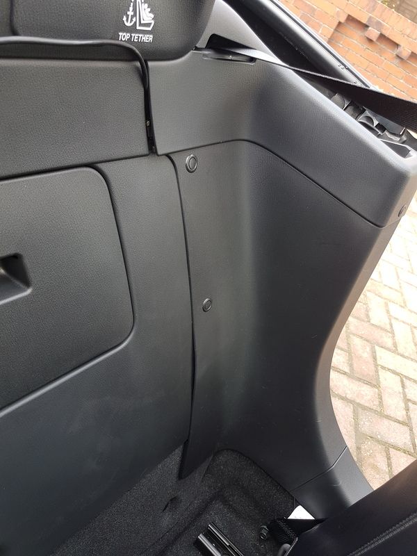

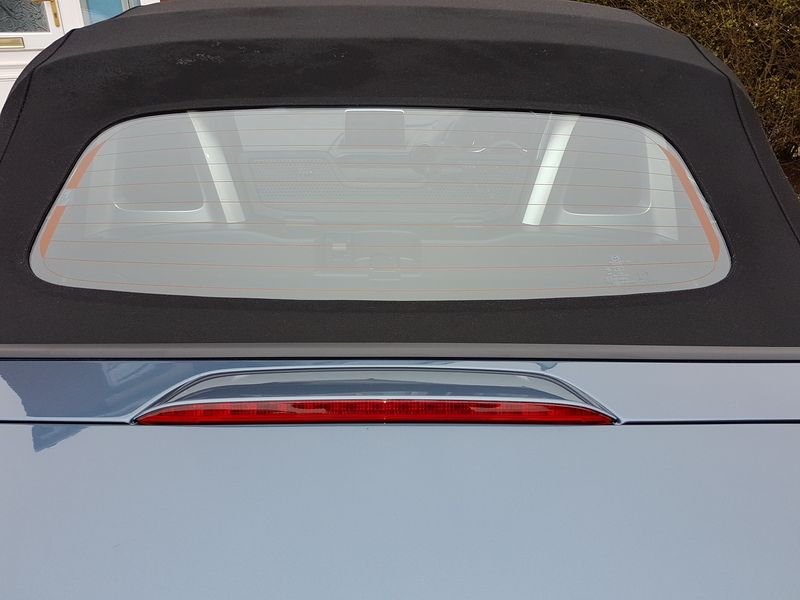

Bought, fitted and initial test carried out.
Looks good so far. Need to route the cables and I have fitted the rear camera incorrectly as the rear view is currently reversed! Will sort tomorrow and post some pictures of the units fitted and some footage.

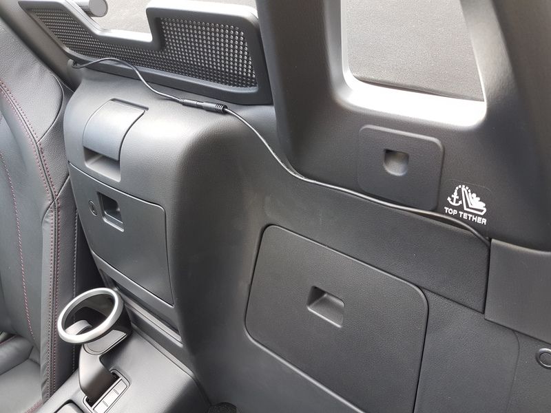

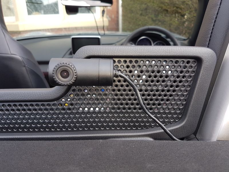

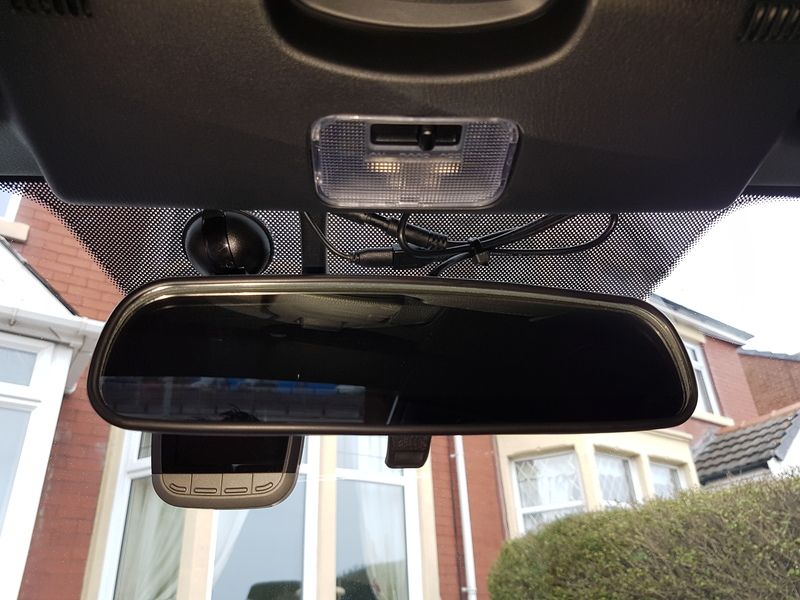

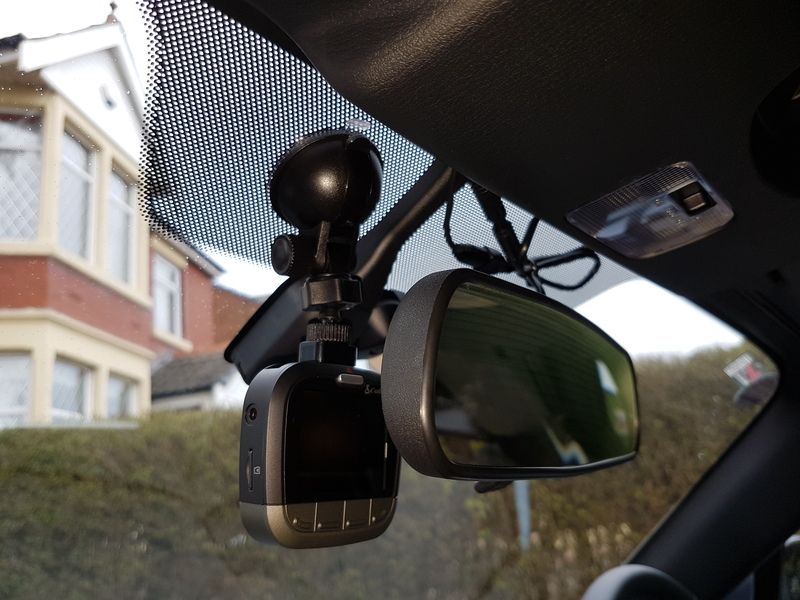

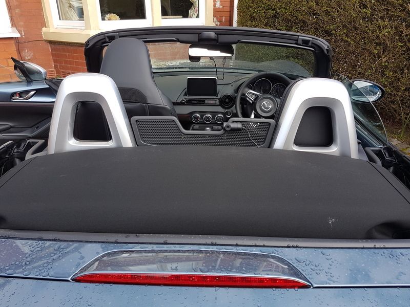

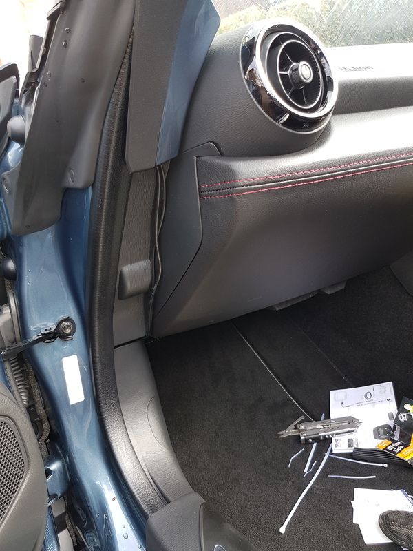

This is my quick review of the above Dash Cam, as fitted to my ND Arctic model.
The main camera and mounting unit is your typical sucker type adjustable mount. Couple of minutes fiddling had this in a suitable position and set up ready to go. There is a ‘Y’ lead from this, with one lead going to the power source, either 12V cigarette lighter socket or a USB. I chose to use the former. The other lead is for connecting to the rear camera. I fed the leads into the trim panels as shown in pictures below, and presently have a loop next to the central mirror, as the bundled cables here are quite thick. I think there is room to put behind the light panel and will do it at some point, but wanted to get up and running and really test the cameras quickly.
