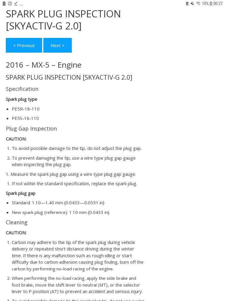

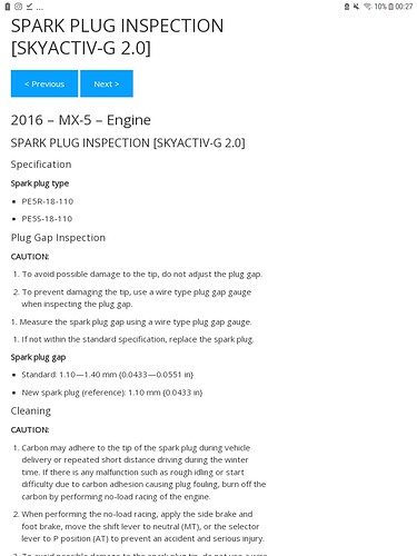

See the link below which partially answers my original question regarding “Ion Sensing” anti-knock sensing on the Skyactiv-G engine. Personally, I think that altering the spark plug gap must impact on this system and consequently sensing of knocking/detonation. How much that would be and in what sense I have no idea but if anybody on here does please educate us.
https://www.hexorcism.com/16ND/sh13084/
Cheers.
Nothing in the page you posted says the plug gap is vital for knock detection. The in service gap can be
1.1 to 1.4 mm so that would seem to suggest that the gap isn’t important.
I appreciate the spark plug gap is allowed to vary from the 1.10 mm (new spark plug) gap to up to 1.40 mm gap maximum for a used spark plug before replacement. Does it also not matter if the gap is smaller than specified e.g., 0.8 mm. I would have thought that there must be limits to the variation in spark plug gap before impact on the measures taken and the correct functioning of the knock detection.

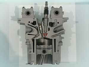

One thing I haven’t seen mentioned here about the Skyactive spec is DI (direct injection), and it’s this which is the key to it’s performance. It’s been a total game changer in the engine world and has given the petrol engine what it was lacking that the diesel engine had.
… without wanting to be drawn to a long discussion GDI exists for donkey years…
The Skyactive G efficiency benefit is from the high compression ratio and the electrotrickery they used to prevent knock.
It’s DI which makes this possible.
