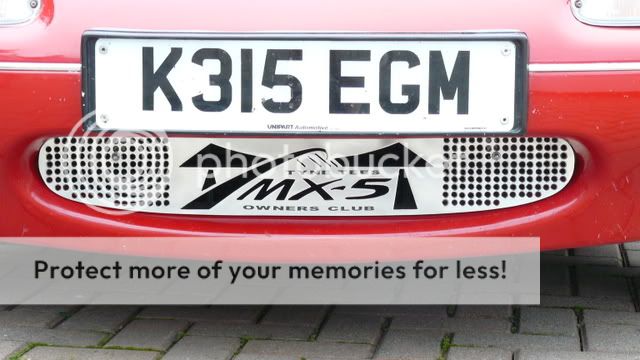

Why not make one yourself and then you can have any design you like on it. You will have something a little different from everyone else. The main tool you need is a hand held jig saw.
This is a picture of one of a few that I have made from aluminium sheet. I have never had any problems with air flow to the radiator either.

Ask for 2.5mm thick aluminium. To cut the shape and all the holes etc it now takes me about 7 hours, with the special brackets that I make for fastening it in place. The brackets I made for the one in the picture were made to be able to have the grill nearer to the front of the mouth.
I buy 2.5mm thick aluminium sheet as the thicker it is the better to work with IMHO.
I buy my sheet aluminium from the places that make aluminum trailers and horseboxes. Usually they are offcuts but occasionally I have to buy larger pieces because of what off cuts they may have. A piece that is just large enough to cut a grill from should be about £5.00
