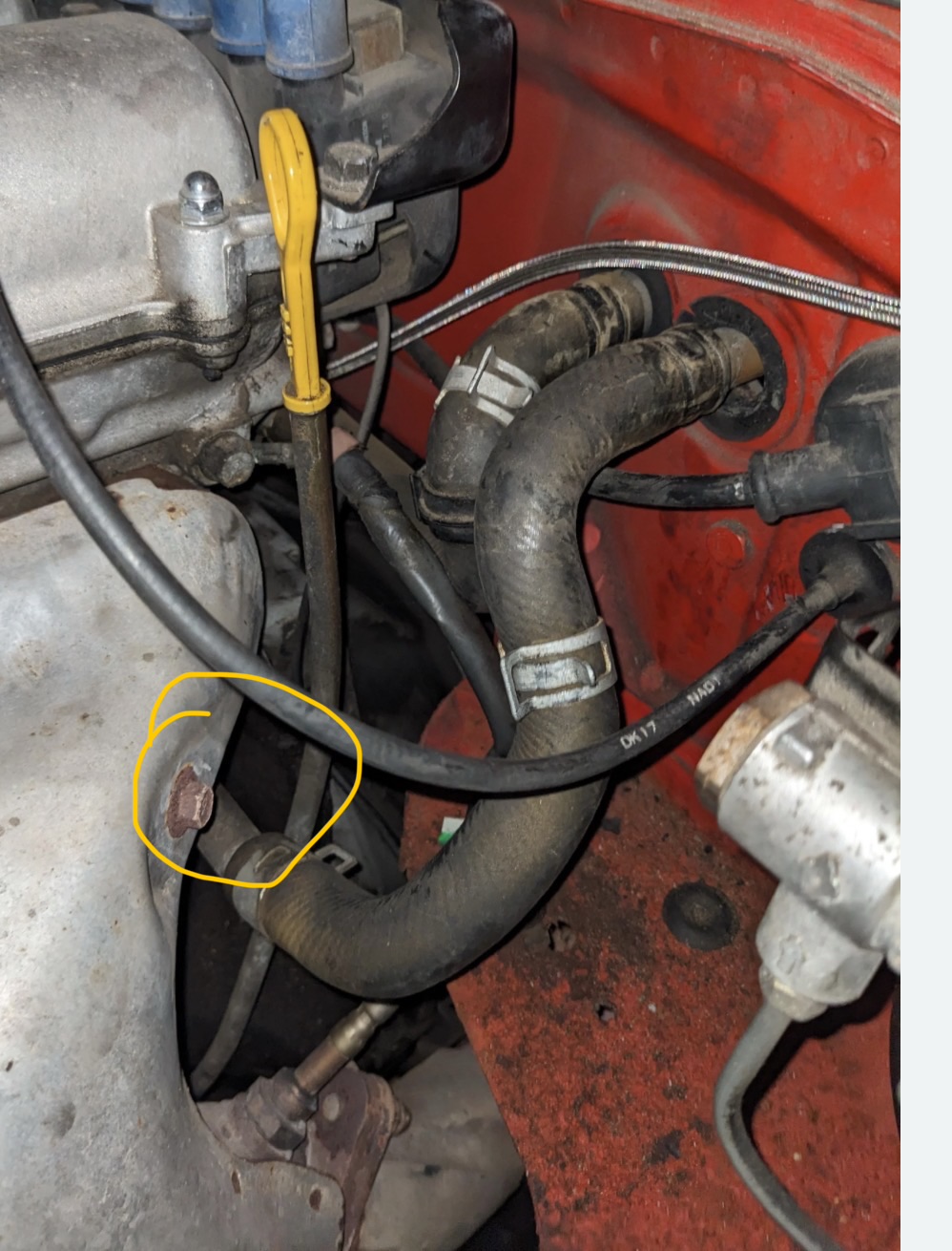

After driving for around 15/20 mins I noticed steam coming from the bonnet, switched car off and opened bonnet. Coolant was leaking out from underneath the car. Managed to find the leak once it had cooled down and looks to be coming from the metal pipe that the heater hose attaches to.
What part do I have to replace for the metal bit, not the rubber hose?

Here’s the part you needWater pump to bypass pipe
It is held on with one of the exhaust manifold bolts. So soak it with penetrant first. It’ll be a pain to replace!
That’s the one thank you! What would have caused this to crack? Coincidence/old age or something to do with sensor or water pump?
Old age. 36 years old after all.
