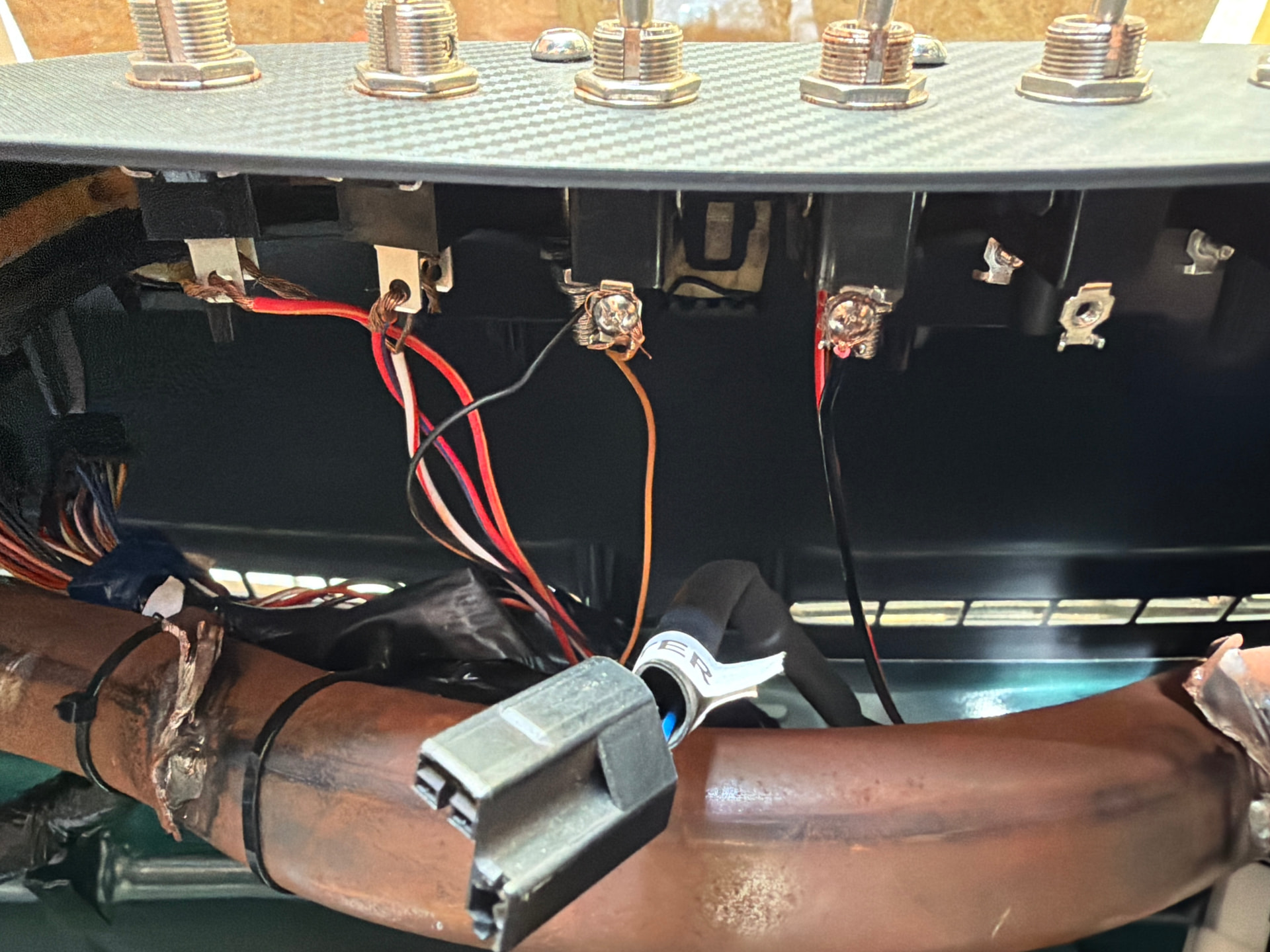

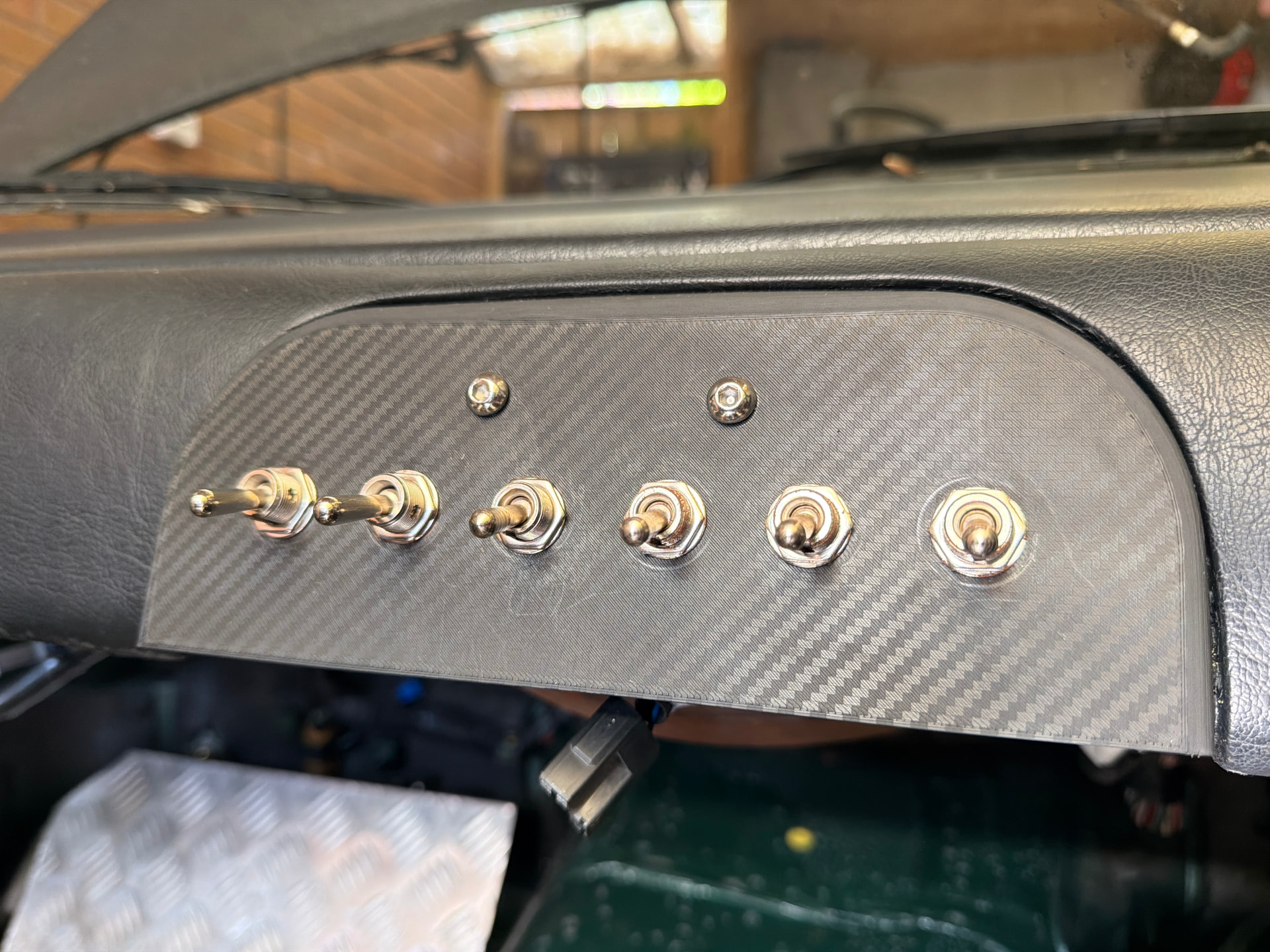

Hi, sorry for the late response I’ve been doing much research. I do 100% believe it is the immobiliser now, I didn’t say before but I definitely should have mentioned it, the previous owner did a dashboard cut, and turned the switches such as hazard and fog light switch into flip switches. I saw that this may affect the immobiliser? I will attach photo of said switches. I also did the code read as you said to do, video here Watch unnamed | Streamable . Not sure what any of it means but I hope it helps. Also replaced all the fuses in engine bay fuse box as they were all corroded including main fuse but that changed nothing.

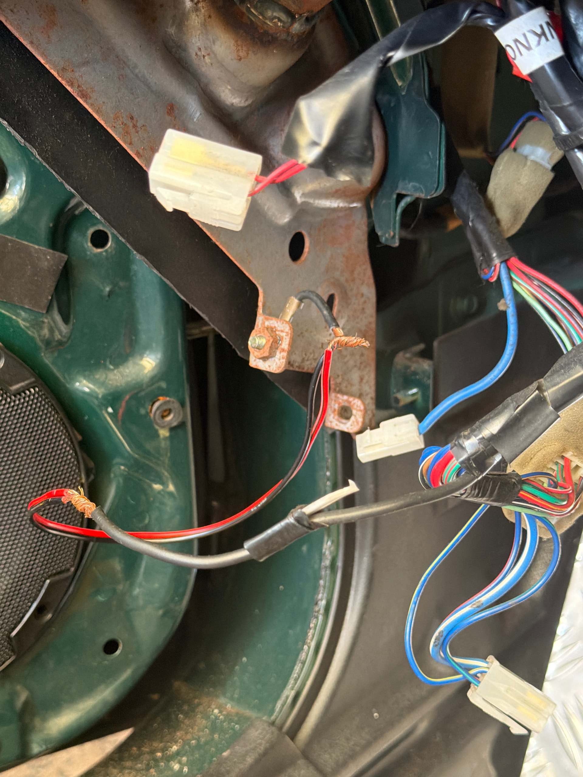

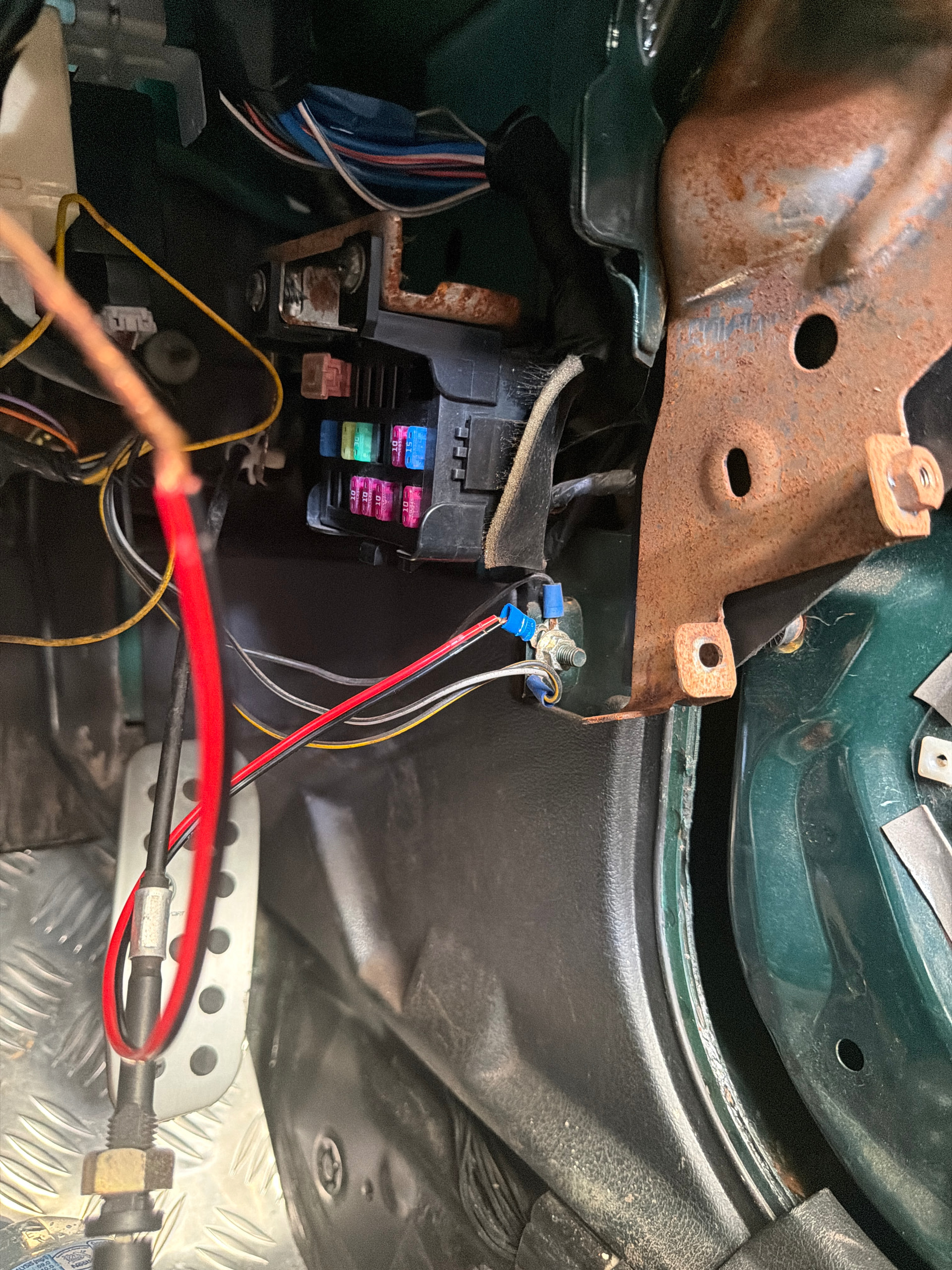

Those wiring repairs in your photos would fill me with dread though!

Also regarding the wiring I read that if the wiring isn’t correct to the hazard light switch, it will prevent the car from a starting, in the same way as the immobiliser by cutting off the engine. Is this true? Because all the switches are wired differently as you saw.

I’ve never heard of hazard switch wiring causing a non start, it is simply an orange wire from the flasher unit to the switch and a black wire to ground. I think that you’re getting confused with an 1993 Vauxhall Nova… oh no, sorry, they used to allow you to start the engine if you plugged the hazard switch in the wrong way up didn’t they?

Also regarding the hazard light switch I just saw on some random forum his hazard light was unplugged and as soon as he plugged it back in it started up again haha. I was just clutching at straws
