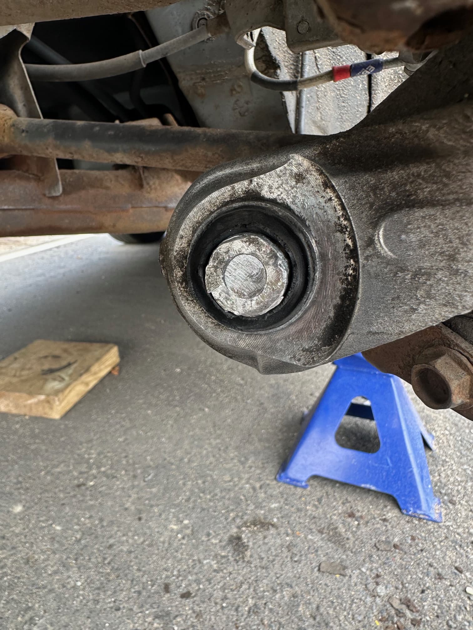

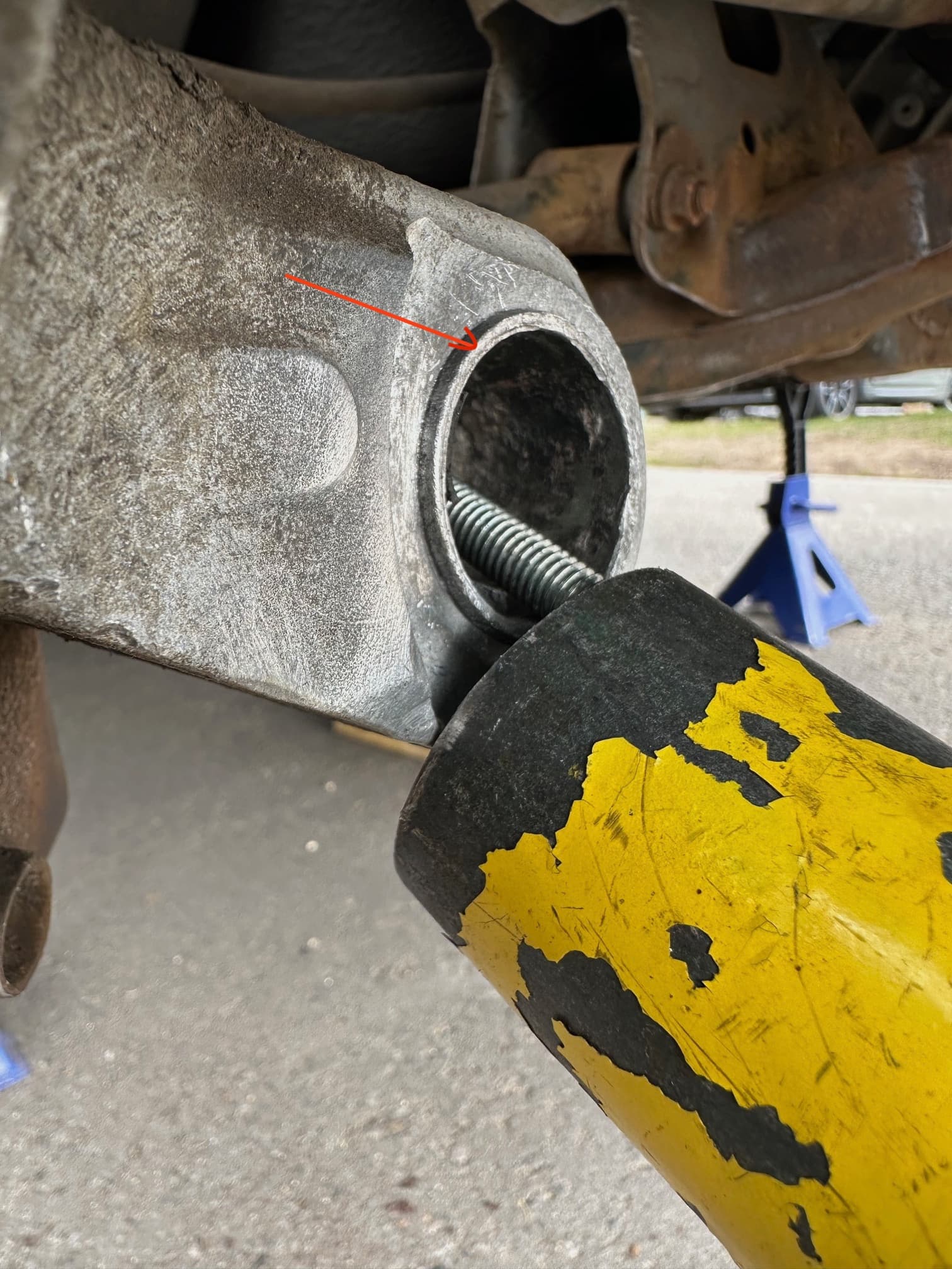

Its a long story, the short version is I cut the rear suspension bolts, and now I have one of the bushing, stuck in the arm, with the rubber and screw stuck in the inner, while the other side is maybe free?? rubber and inner sleeve of the bush are out as they sheered during the attempt to open the bolt but I am not clear if the suspension bush have outer sleeve.
I am not clear on : Does the bush have outer casing in the suspension setup ? if so how do I get it out ? from my current efforts nothing moved when trying to “extract” what could be a sleeve or equally be part of the part casting is the wheel hub ???

one of the questions is what does the bush looks like , does it have an outer metal sleeve, or is it a rubber on shaft bush not in case din a metal sleeve.

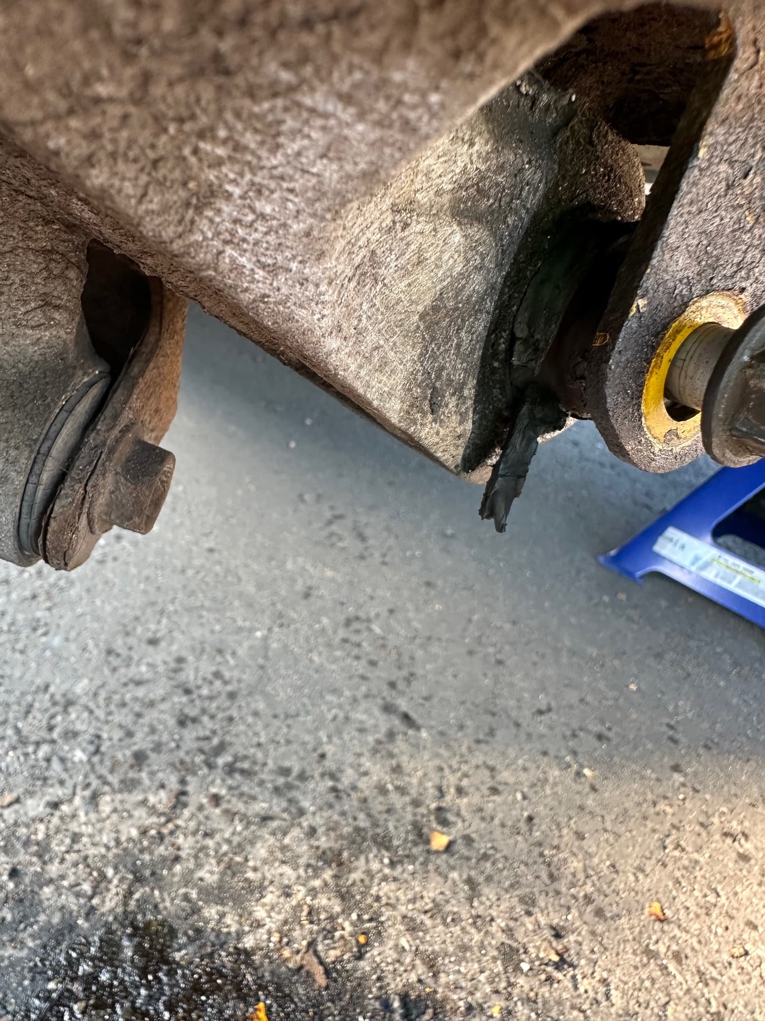

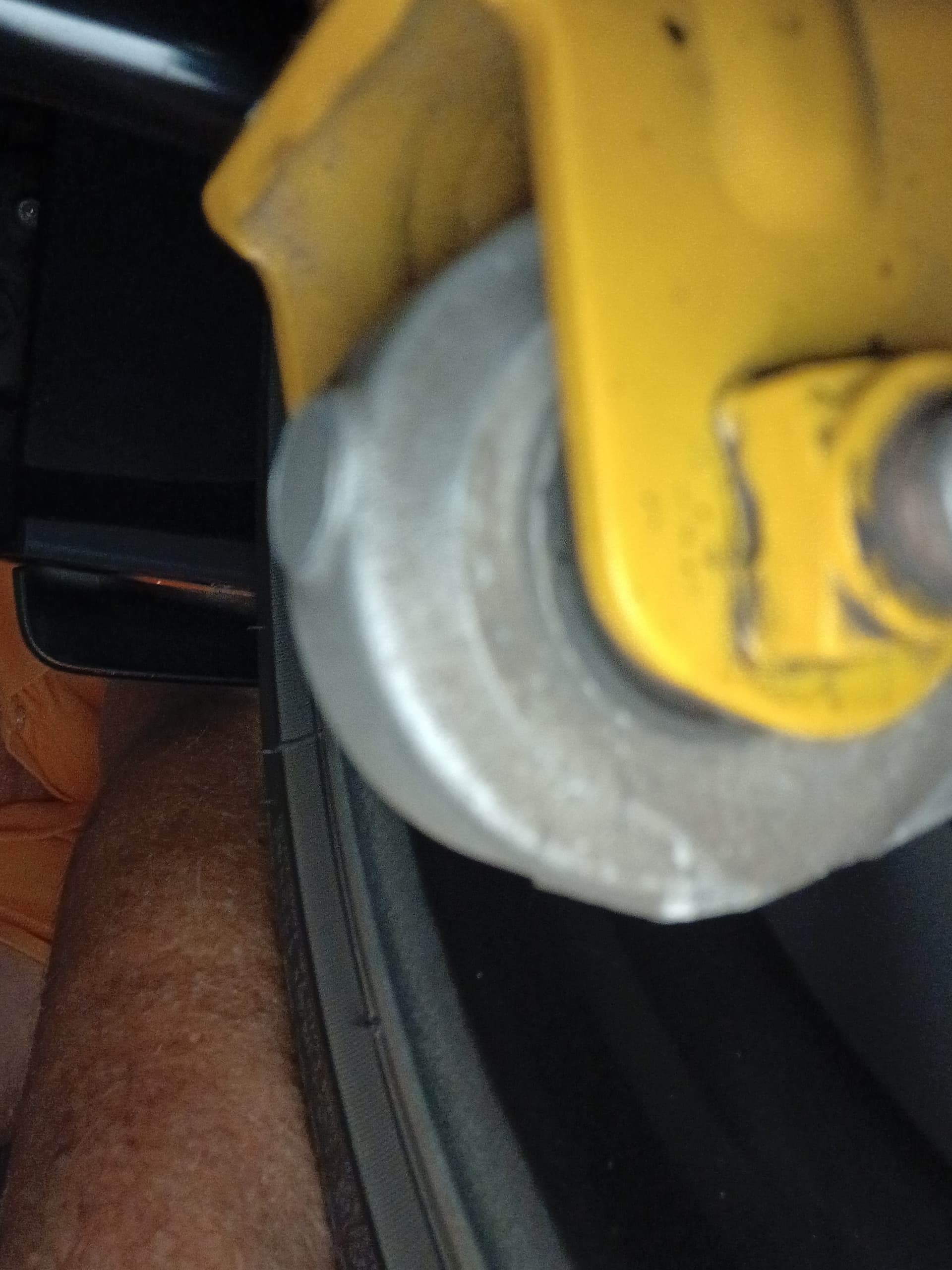

does this bit need to come off?
what is the expected size of the bush?
Did I buy the correct part ?
How do I get the car back on the road outside of buying two replacement rear hubs and a huge set of bolts?
The above is a picture of the lower shock absorber mounting. The bolt passes through the bush and is secured into the captive bolt welded to the shock absorber.
Is this the bush you are talking about? Is the shock absorber free? It is difficult to see what is what from your photo.
The replacements you have appear to be the correct ones. The outer metal of the new one should match the diameter of item you have pointed to, do they? It would appear that the inner tube and the rubber part of the bush have come away and left the outer tube (the part you have indicated) in the hub. Is this correct? If so then yes that part needs removing.

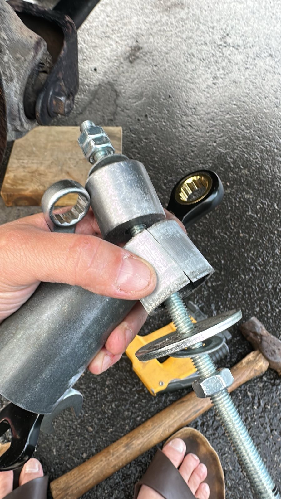

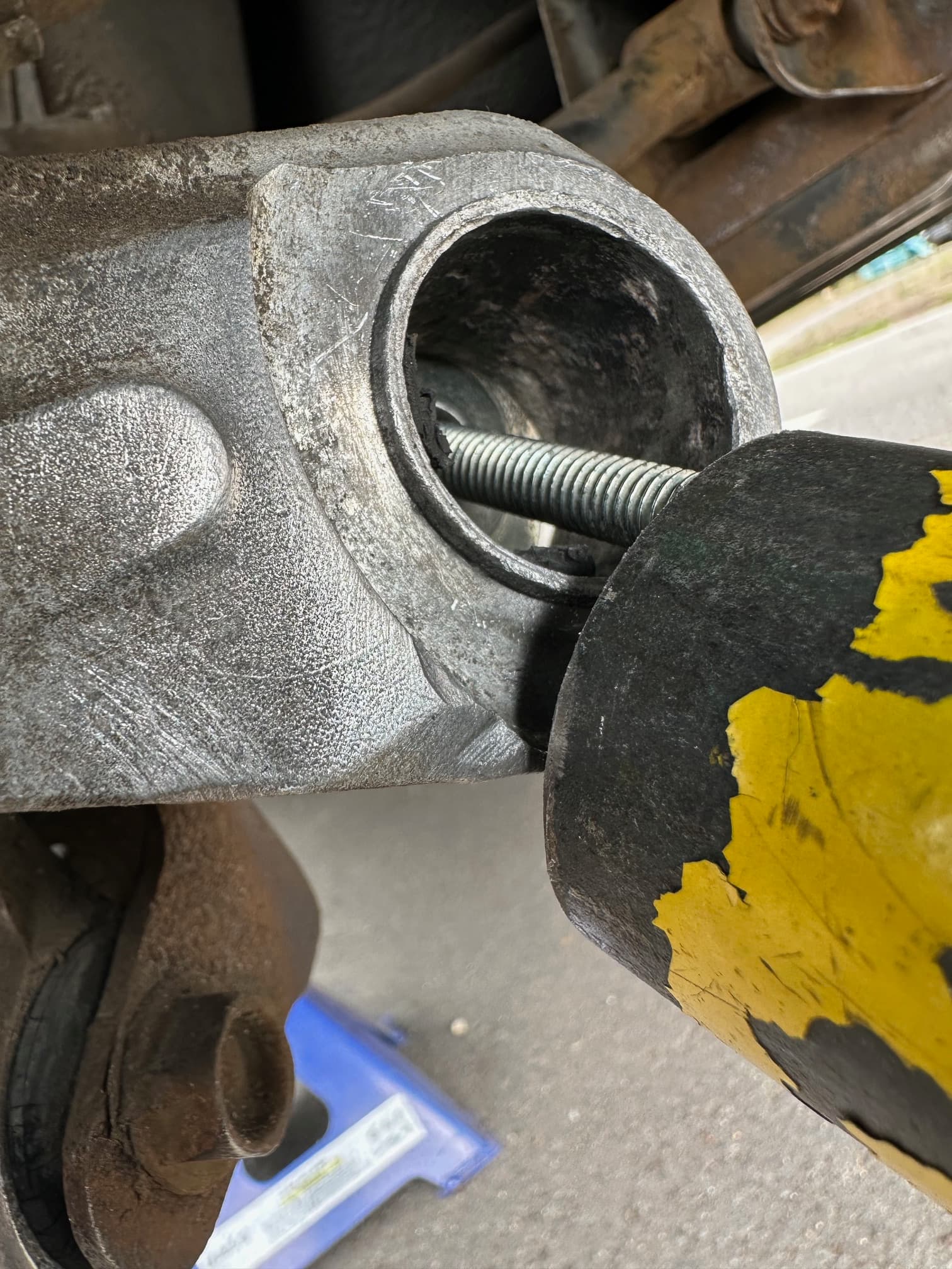

As this was a proper saga I thought i’ll update here.
few things:

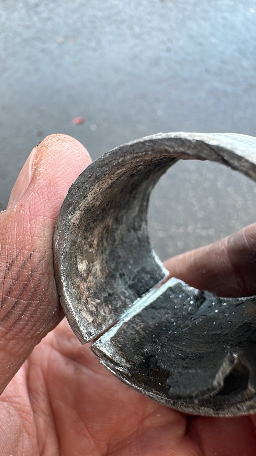

  • The wheel hub ‘lip’ is part of the suspension bush, the bush is incased in a metal sleeve.
  • if the bush is stuck, its easy to drill the rubber around, freeing the inner sleeve, and hacksaw the outer one.

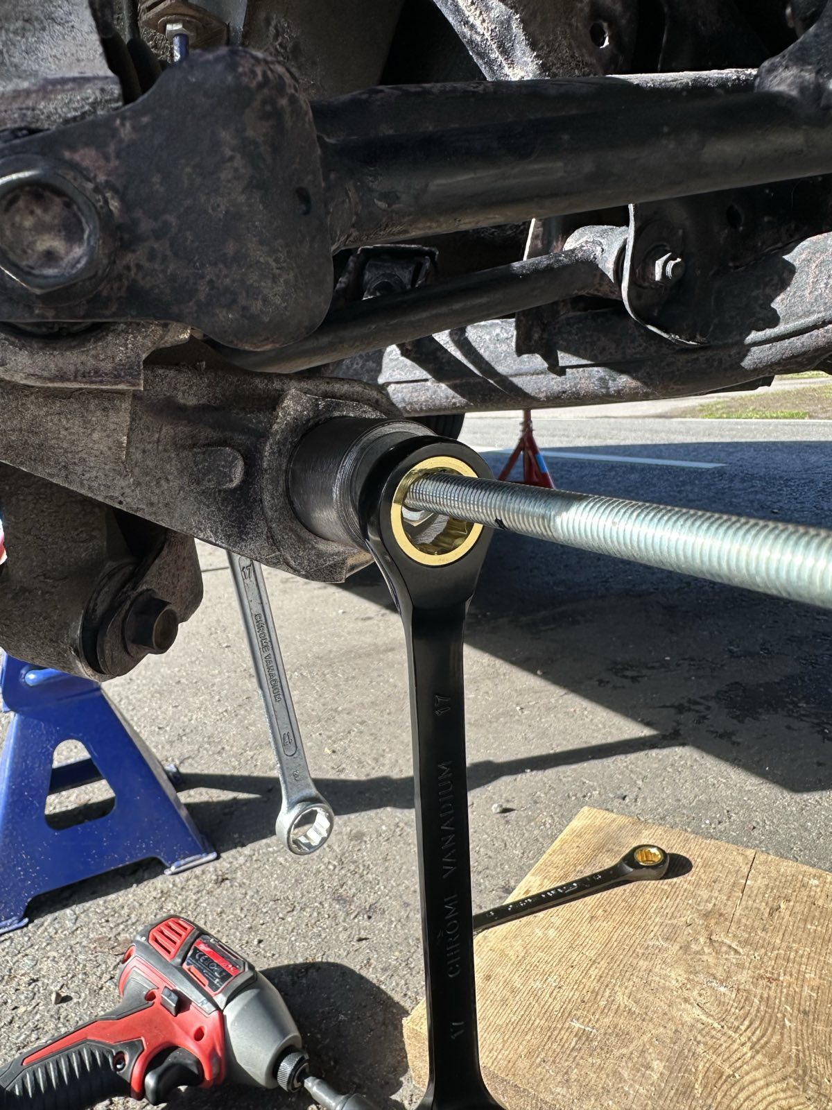

  • A BIG bush pusher/puller tool is highly recommended if done on the car, if you have the hub out, use a press.

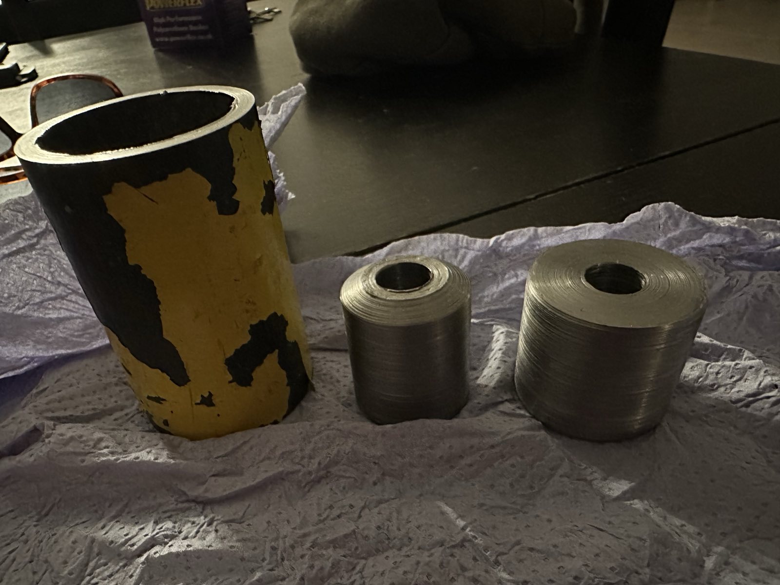

I ended up turning couple of pushers, but m10 rod is not strong enough for the job, the pushers did come in handy at the end so not total waste of time.
i’ll add few photos :slight_smile:
