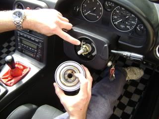

Horn Ring
I think Raydar27 was refering to the metal ring shown in this photo on the boss and the spring loaded contact seen at 6 o’clock on the steering column. Sorry the photo is small.
