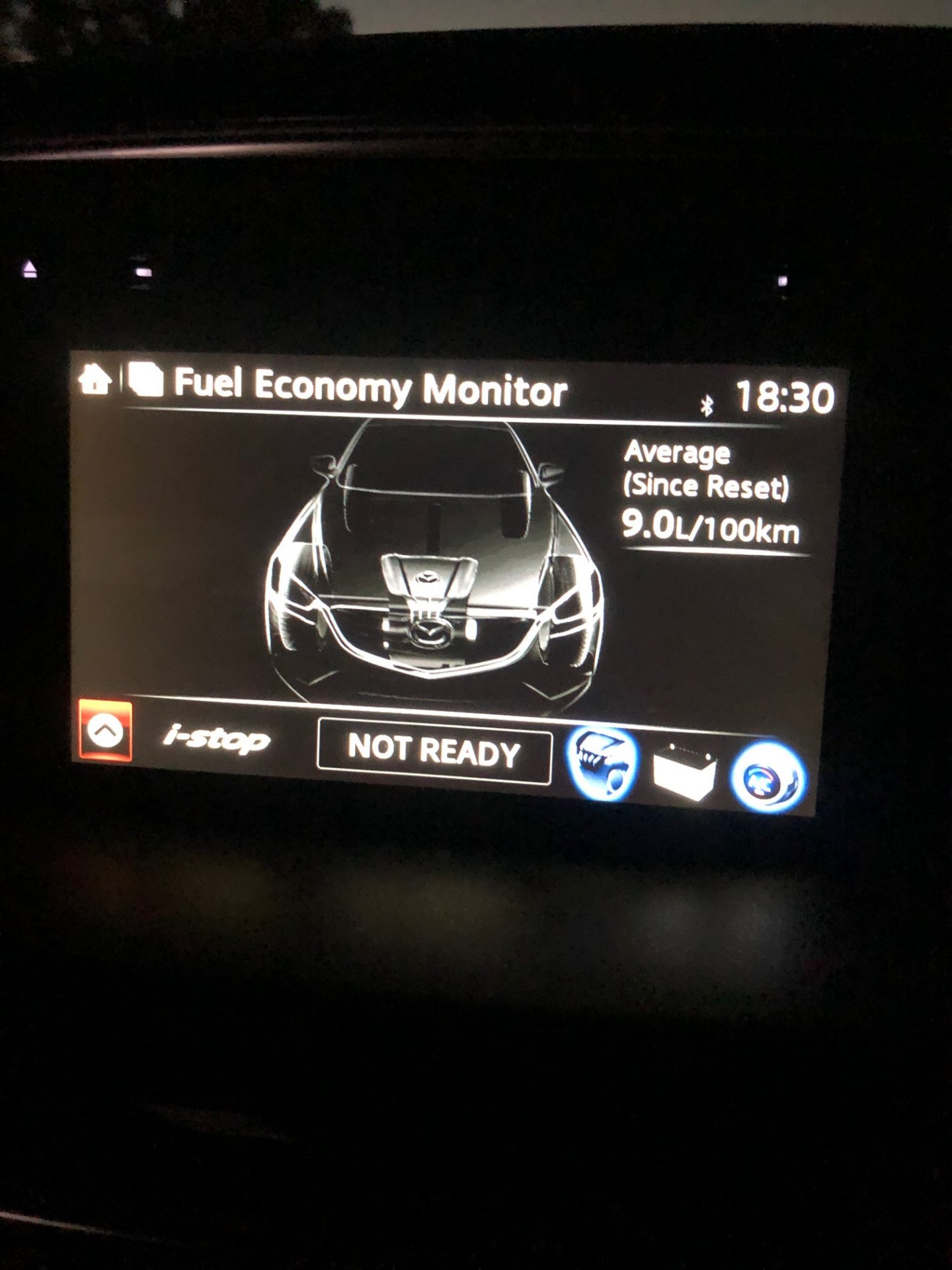

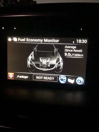

I-stop question
Thanks, that was my hope too, but after driving it around most of the weekend, including motorway driving, it still didn’t spring to life.
Hi B,
Ours stopped working for months and the dealer were no use. They said the battery needed charging even though we had driven nearly 2 hours to get there.
First thing is have you found the screen that tells you why it is not working? If you have and it is the battery showing as the issue try this: open both doors and the boot then disconnect the negative battery terminal and leave it for 15 minutes then re connect.
This has fixed our 30AE three times and a friends 30AE.
How on earth did you discover that? I’ll give it a go next weekend and report back.
Mines a 30AE too, so fingers crossed. BTW haven’t seen a single 30AE in the wild yet!
Hi B,
I was so frustrated that I thought the old computer help desk suggestion of turn it off and turn it back on seemed worth a try.
The opening the doors and boot first was from an online manual which suggested that the electronics were best served by doing this so I did.
This is good information Workshop Manual | 2016 ND Shop Manual (hexorcism.com)
Please do let us know if it cures yours. Just been overcome by the desire for a bacon sandwich!!!
I have used Mad Malc’s method of resetting the i-Stop on his recommendation, which cured the issue immediately.
Here is a link to another way of resetting the Mazda i-Stop system without disconnecting the battery, providing it’s a battery “Not ready” fault showing on the screen display, although it’s a bit more long-winded than MM’s method.
