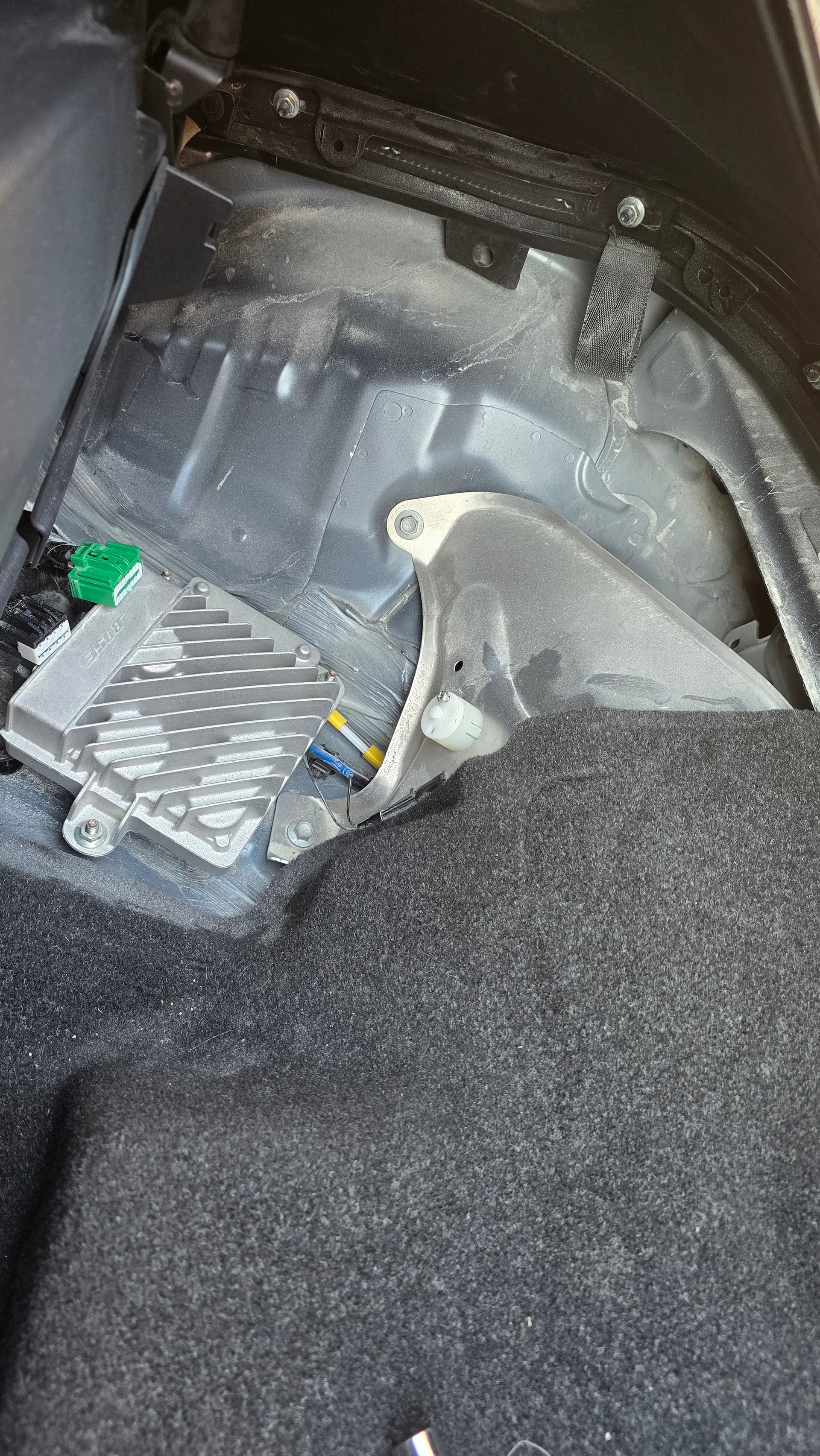

I am disconnecting the BOSE amp today (do you have bose or not?) To see if the battery drain is reduced. After much research, if these go bad, they can drain the battery significantly. I’ll let you know how it goes.
Please let us know if you get it resolved and how - i’ll do the same!
Thanks for your post and your message - very interesting! I’m still recharging my new battery now, and will reinstall it and see what happens. Did you find that fuse 17 was blown? Obviously I can pull it and check it, but I’m not equipped to test further.
Removing fuse 17 reduced the draw signifigantly ~60%. The fuse isnt broken. Basically you test by putting a meter between the - terminal and the battery, then remove fuses to isolate the problem.
Just checked the bose amp by disconnecting and no change. FYI for anyone out there, its behind the drivers seat under the hood!
