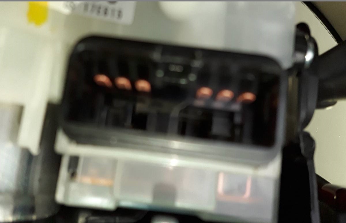

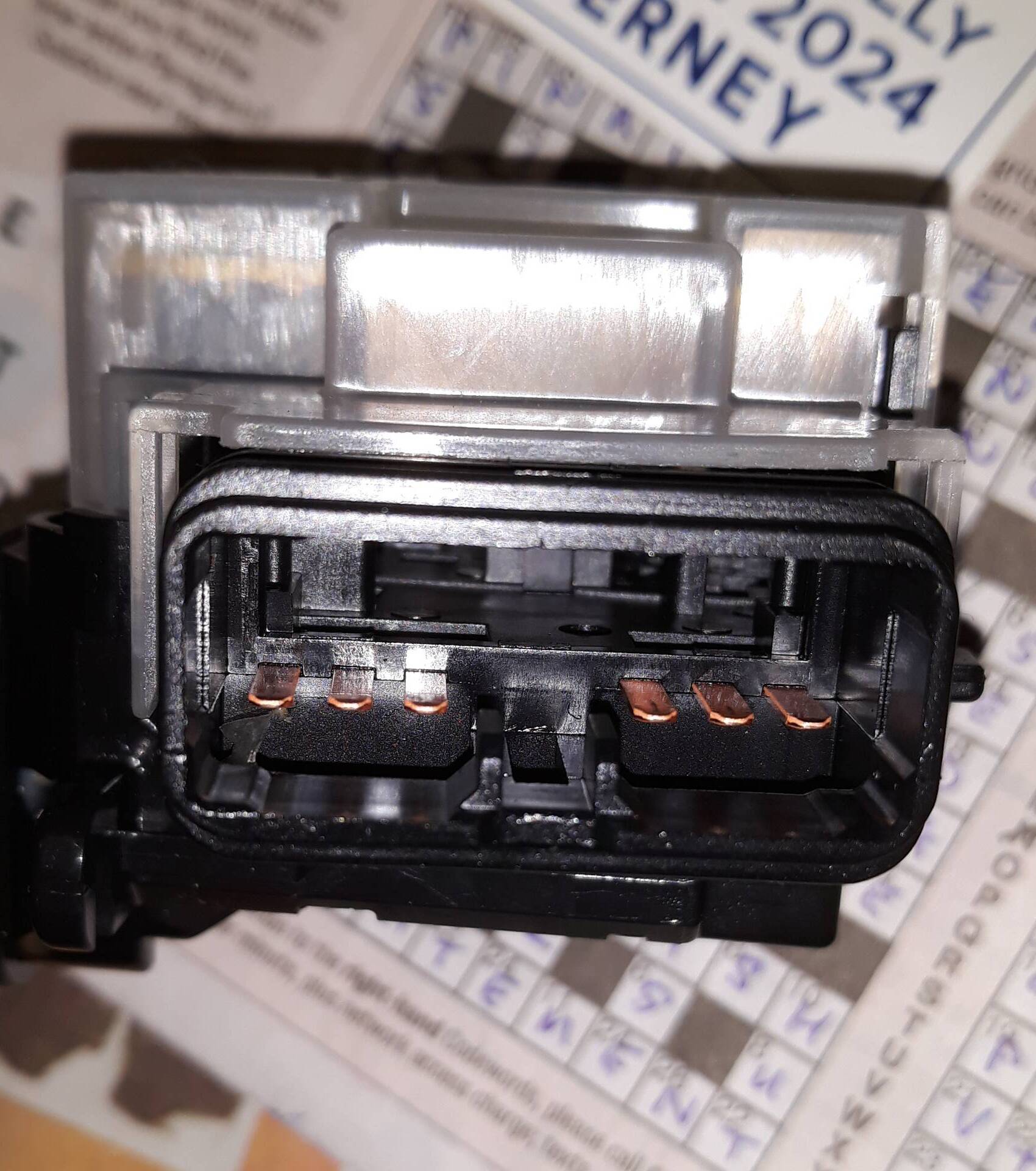

The unit I took off my 2014 NC has only one row, this is it.
As far as I remember the RX8 wiper I bought in 2014 for my 2008 NC also has only a single row. It definitely worked on that and now transferred to the 2014 NC works on that too.

Your picture shows a different stalk. That extra connection row is not on my ex-RX8 unit, as seen in this blurry view from below and fitted inside my NC

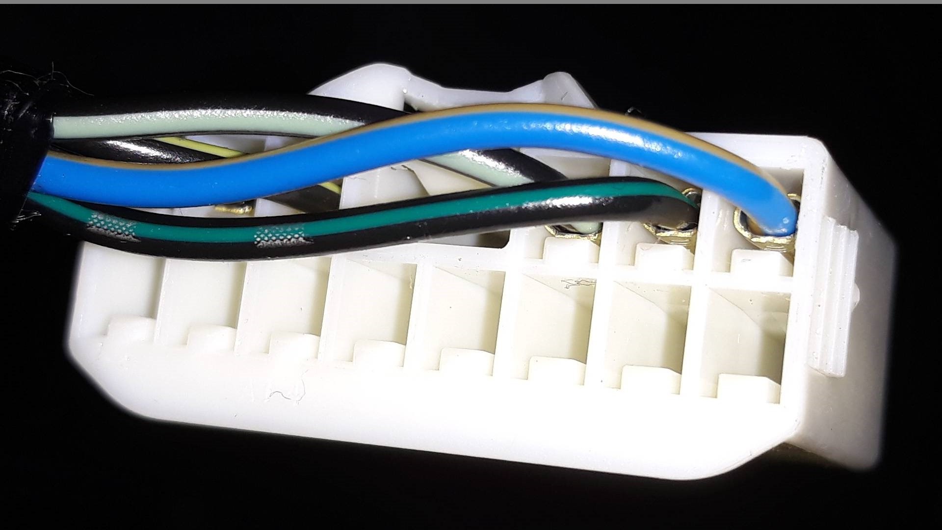

and nor is it in the loom, only these six wires used in one row, as for all NCs.
Speak to your vendor and make sure he can supply a stalk also suitable for an RX8 (which was the basis for the MX-5 NC)
Good luck!
Does anyone know where I could get a 6 pin RX-8 wiper stalk? I’ve spent ages trawling eBay but they are all multiple pin versions. Mine is like the one in RichardFXs post above,
Thanks Mike
I couldnt find a cheap one with only six pins either. So i ended up buying a genuine mazda one from mx5parts.co.uk.
Costly but at least it worked.
