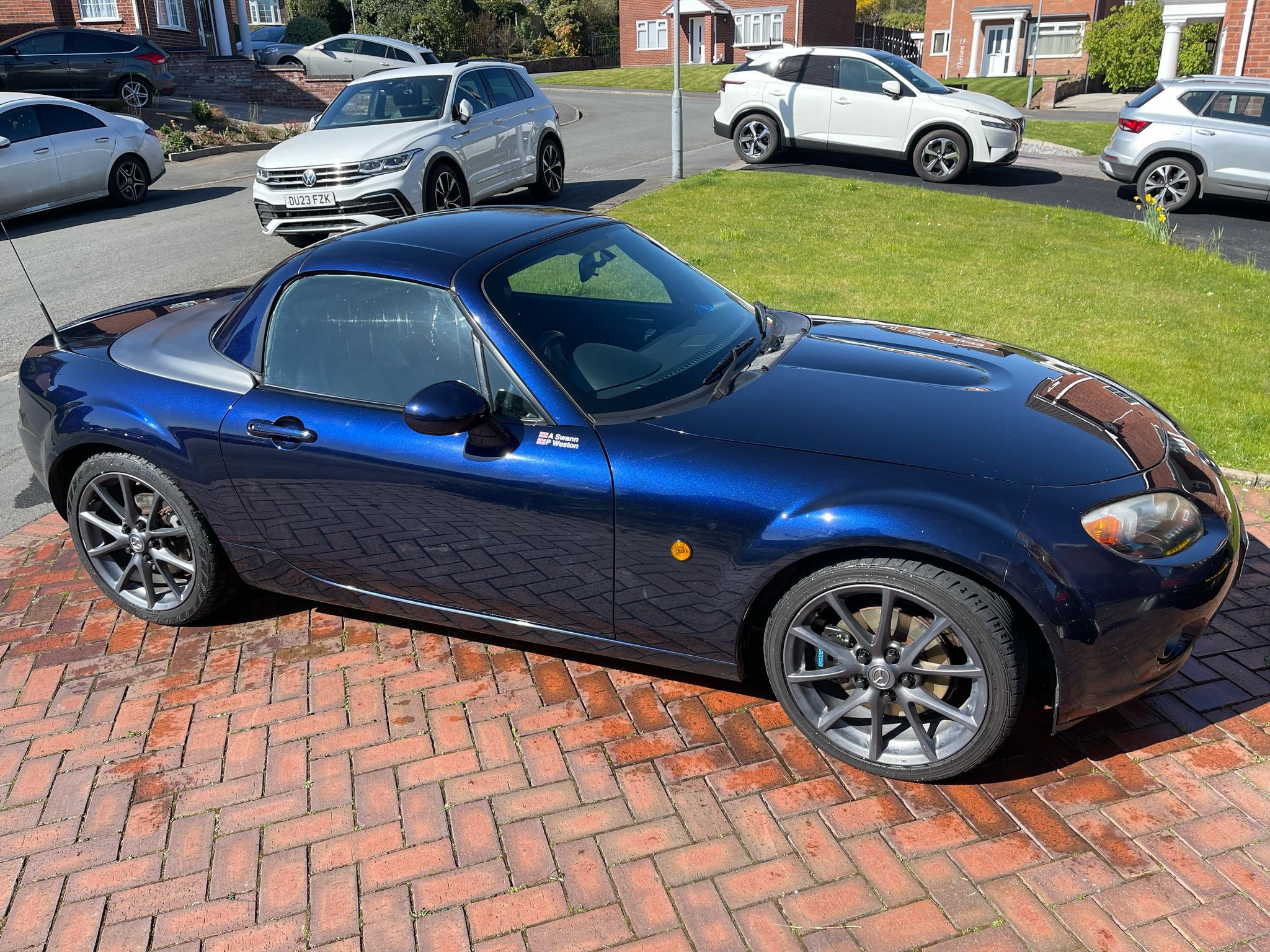

Then a full machine polish, need a few more passes, to correct where I’ve had to do some scrape repairs, but looking loads better.
NSide
Rear
Gave the wheels a new lease of life, but decided to go darker to go with the Stormy Blue Paint work. They’d taken a battering so happy with the results.
They even have a few coats of wheel wax on them, to keep that pesky brake dust at bay.
As my mate had decided to chop up the mirror collar, I fitted a new mirror as well.
Treated it to a new MOT and now have 12 months of fun ahead.
