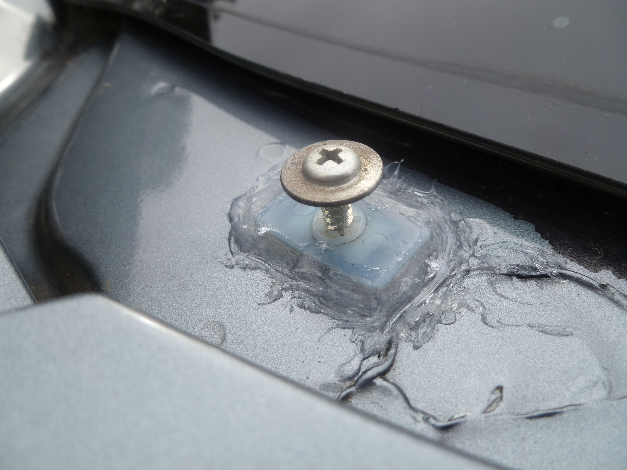

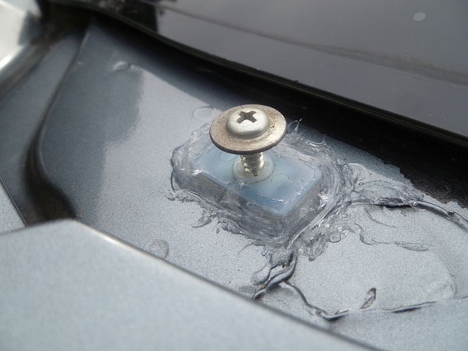

I did mine last year. I’m only replying to confirm (as others have said) that the plastic scuttle cover has to come off to allow access (and the grommet cannot be removed through the hole in the cover). When in use, the cover is trying to pull the grommet out of the hole in the scuttle, so one wants the grommet pulled up as far as possible, giving the thickest possible layer of RTV underneath. I just squidged the silicone in whilst pulling the grommet up with its screw (really need 3 hands) until it stayed in place, then messily spread the silicone around to ensure a good seal, whilst not pushing down on the grommet. Slightly over-done, as this pic shows:
